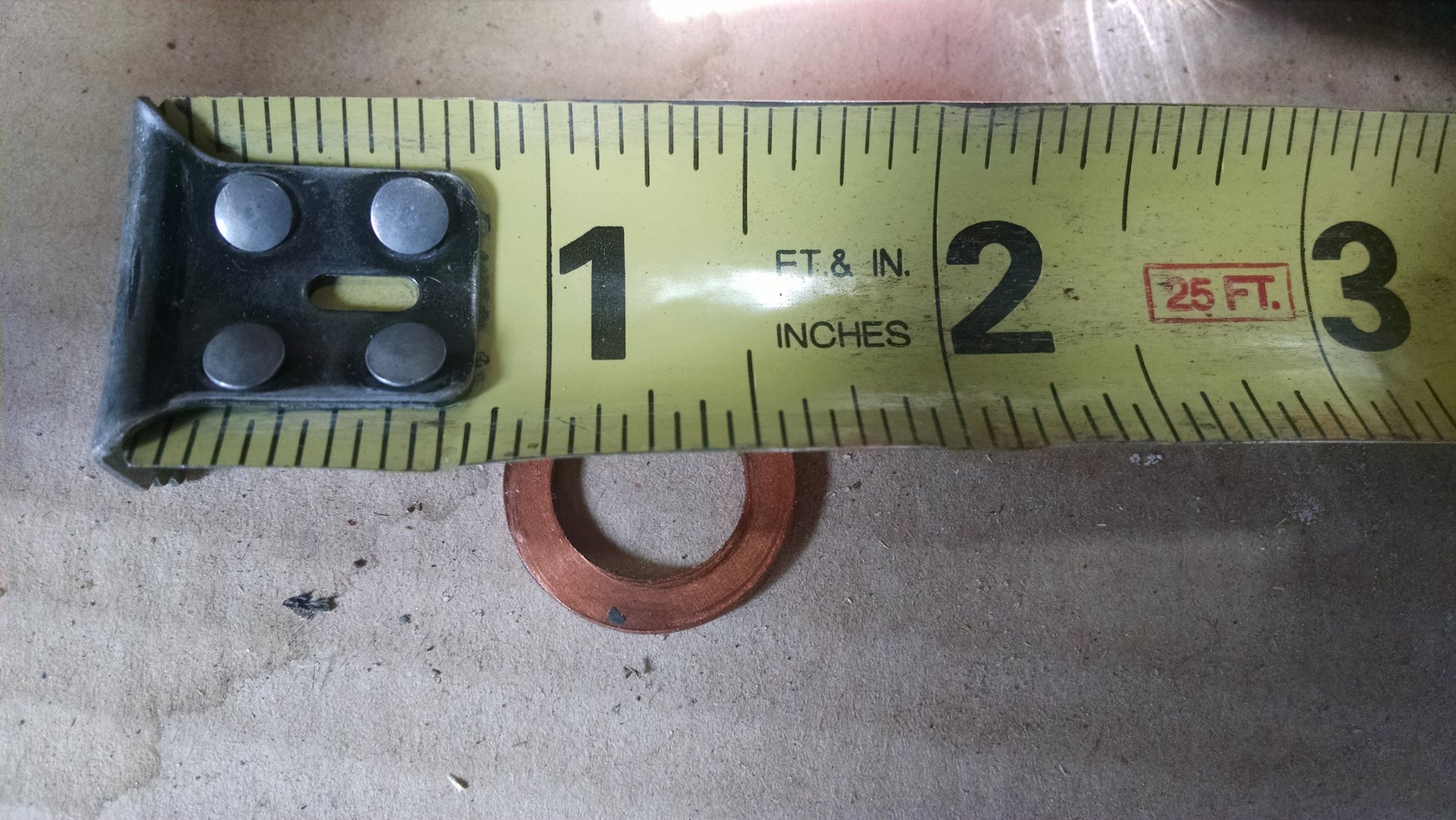

Here is what the wrong size looks like , way to big , I bought new one at local dealer.
Auto parts store should have something to get er done today.
I was getting a couple drips. It was factory too big.
Autoparts it looks like brake caliper part.

thanks....Messick's is showing
Thanks, looks like the OEM washer is about 3/4" OD

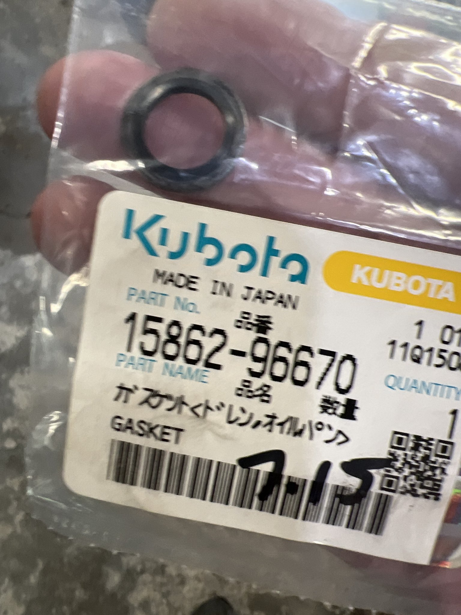

I keep a washer for both the motor oil and HST drain plugs. Just in case. Thought I had lost the washer a long time ago, but it was there.
Hindsight, I would do as lugbolt or GeoHorn suggested. Just get a copper washer to fit.
Not saying this is your part number, but the kubota part for my tractor was $7.15 years ago….🥹
