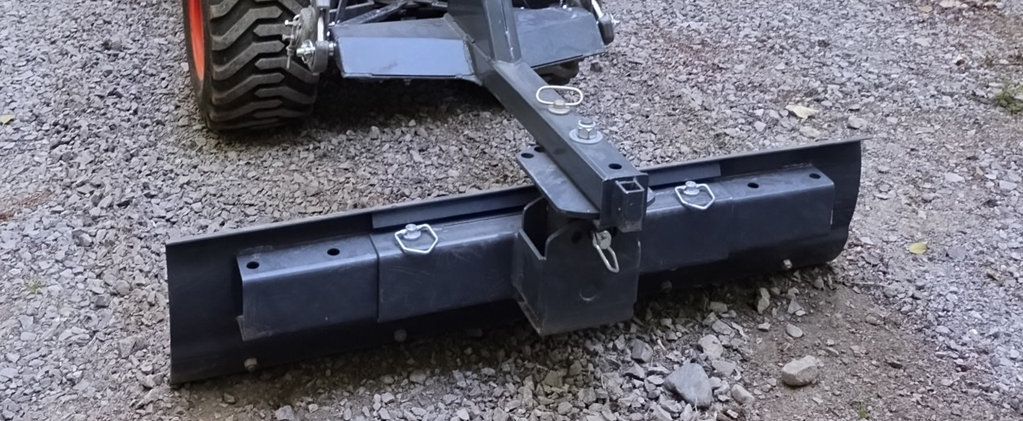

I just bought this 5' Rankin rear blade this weekend for my BX. The blade tilts and offsets. It took me a while to figure out how to get the blade to slide ... you have to hold it a certain way otherwise it binds up for reasons I don't fully understand.
I started thinking about completely sliding the blade out and slathering the whole sliding part with grease. I don't know if it will smooth things out at all.
What do you folks think ... will this just make a gloppy dirt-attracting mess? I'm used to grease on FEL and backhoe pivots but this is going to be close to the dirt, especially when I run the blade in reverse.

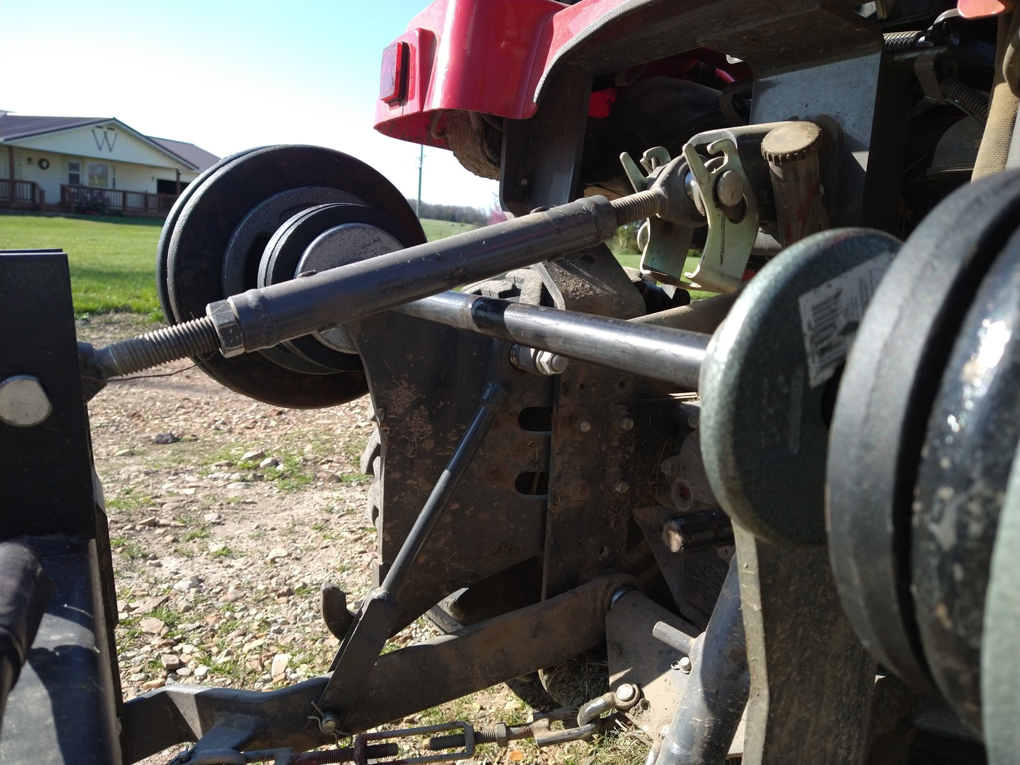

Just be aware the farther you have it off-set, the more weight on the back of the tractor you will want, if your doing more than a light scraping at an angle... Or it will push your rearend sideways ...
Not sure if your tires are filled? Doesn't look like you have wheel weights ... But seems you have a BH ...
I'm guessing your BH hooks on similar to mine ... I found my little SCUT had trouble going straight with a full load being pulled with a 6' blade at an angle, traction was also a problem, spinning 3 filled tires while crab walking ... Even with some weight in the bucket, this is where it stopped
So I added weight to the BH mount! On mine the top frame hole is 1" ... I took a piece of 3/4" black iron pipe which has a OD of 1.06" and slid it through, added weight lifting plates, had to use smaller ones closer to the center so I could get full range of the lower 3pt arms ... And my top link just barely clears it.
275 pounds of old plates I bought off eBay, at roughly $1 including shipping, plus the 70 Lb wheel weights on each side.
Now it goes straight, as the weight of the blade is resting on the ground ... So I put weight on the tractor.
