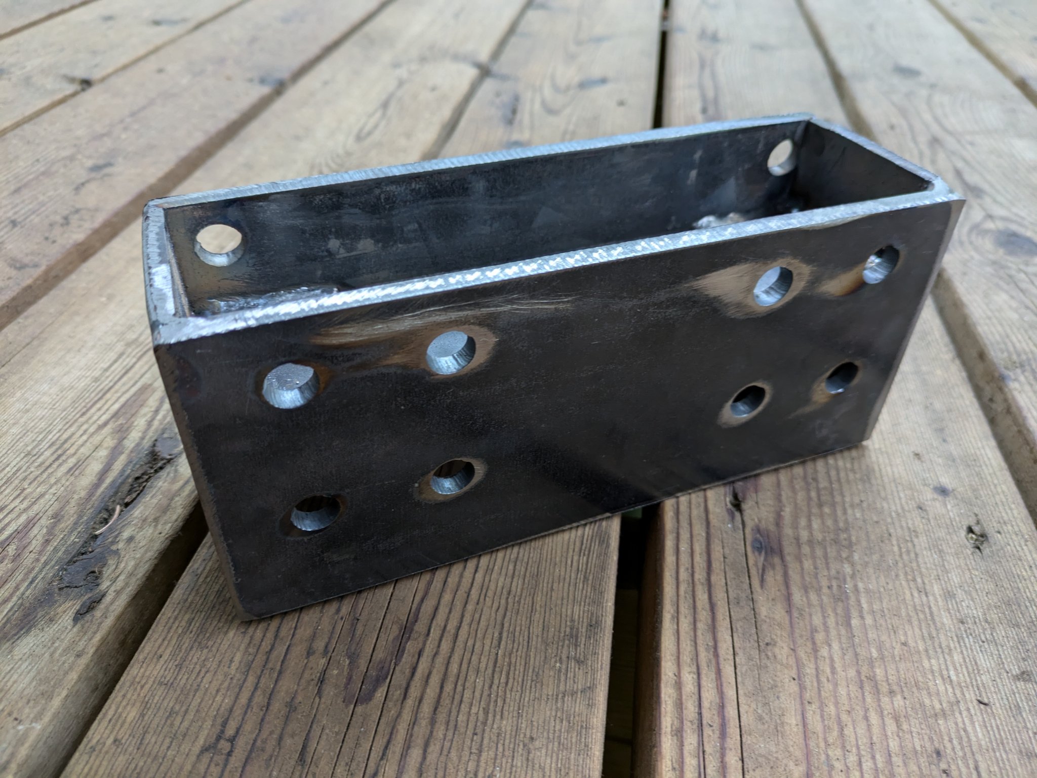

Got the plates for the spacer cut on the plasma table today.
Hopefully have it welded up tomorrow or the next day.

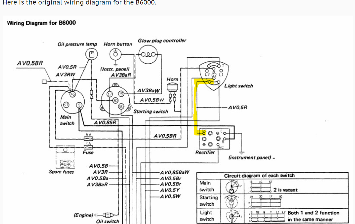

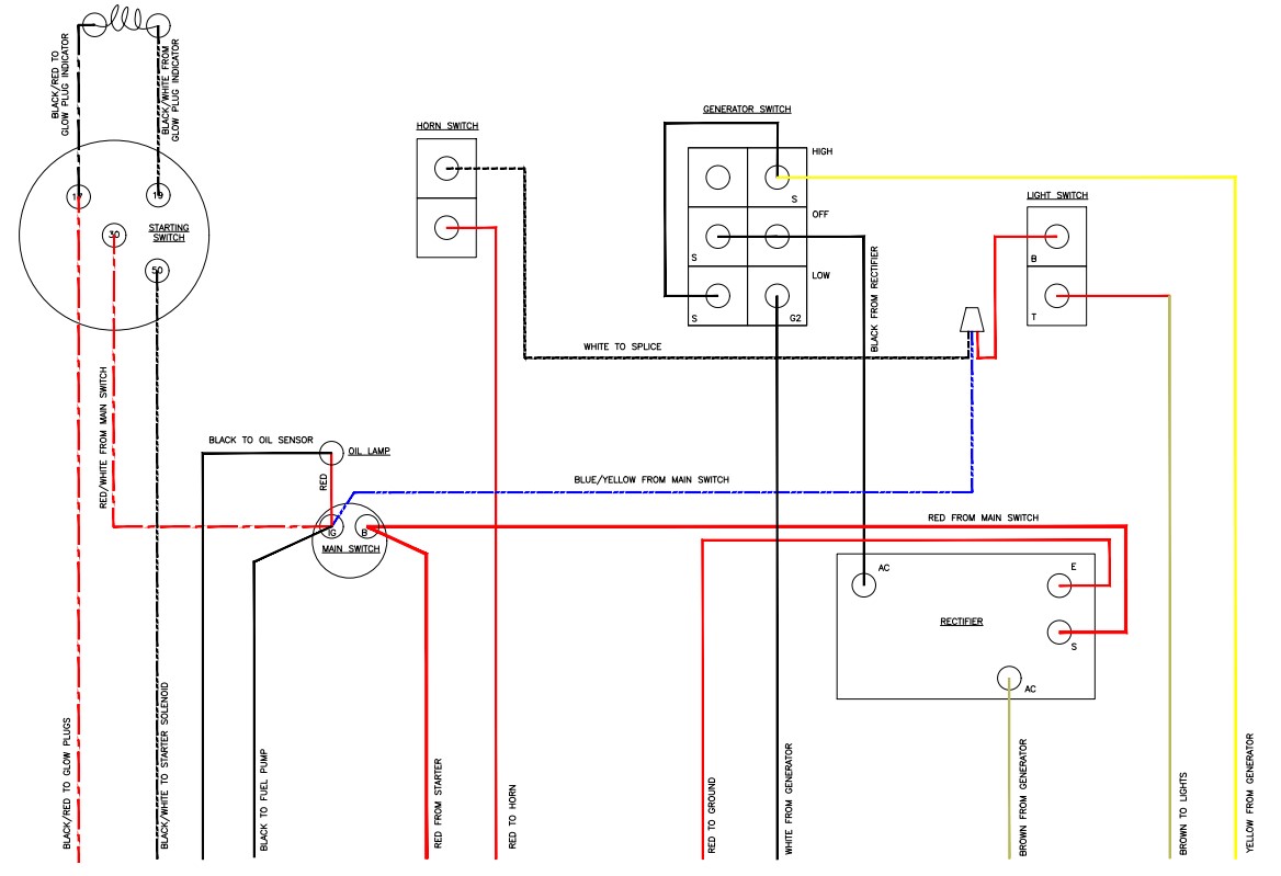

I agree that it sounds like a short in the wiring.
It would be unlikely that both the main key and starter switch both got water in them at the same time but I suppose it could happen.
I don't think the solenoid is damaged because the starter works properly as soon as the small spade plug is connected or removed.
Here is the original wiring diagram for the B6000.
But mine has had some modifications, There is a 3 position switch on the dashboard that says Generator High/Off/Low that I haven't figured out what it does.
And there is a plug for a trickle charger wired to the battery.

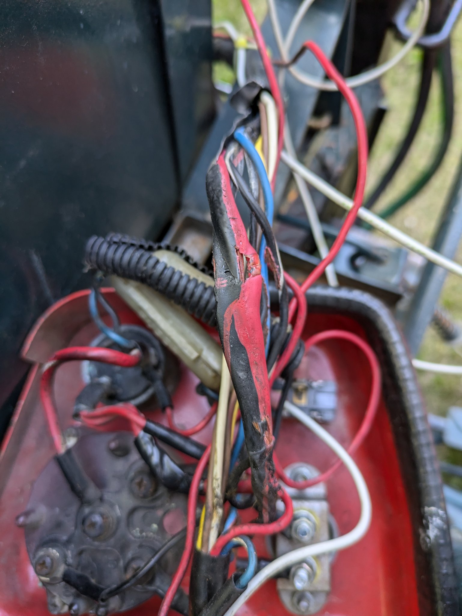

Pulled the dash off it.
Looks like a mess.
And the glow plugs aren't working either. Surprised it starts as well as it does.
Swapped in the glow plug indicator from the old one and that's about as far as I got.
I'm tempted to replace the whole wiring harness or swap it with the old one... But that's not correct either.
trevoroni
B6000
May 24, 2023
201
251
Well.... There's your problem.
Kept pulling back the covering over the loom...
It looks like the main power from the starter to the main switch and the wire going from the switch to the glow plug melted together....
Based off of the corrosion it looks like it's been starting for awhile and being parked in the rain outside did it in. Lucky it didn't catch on fire.
That's as far as I got tonight... It looks like most of the small wires are intact, a couple of tears in the insulation which is why the starter was always going when the battery was hooked up.
I ordered some 2ga wire and rings to fit the terminals. I've got enough of the smaller stuff for the rest if they're damaged beyond repair.
Hopefully the switches didn't get wrecked too... I didn't have time to test them.
I also started sketching the wiring diagram and it looks like the "generator" switch and light switch make sense. Instead of being hooked up to the 1 OEM light switch it was split into 2 easily available switches...
Not sure if I'll replace that with OEM yet or not.
One step at a time.

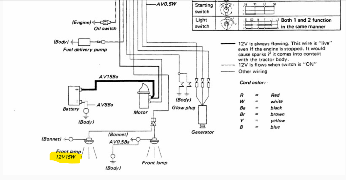

Here's the wiring diagram for the new tractors dash.
Other than some messy wires it looks like it all makes sense and replaces the OEM switches. The mysterious "Generator" switch with the 3 position switch High-Off-Low toggle is really just an On and Off.
It also appears that the headlights run on 12V DC now which will be nice for swapping to LED's.
I'm guessing the ones in the old tractor aren't going to last long. I didn't realize that the original bulbs were AC.

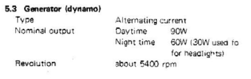

Not saying that the bulbs are any different but they have AC voltage going through them in these tractors normally and this can cause issues with LED bulbs.
If you look at the OEM wiring diagram posted above the lights are powered directly from the generator normally and do not go through the rectifier for DC.
Edit: It looks like I did say the bulbs were AC, I guess I should have said AC powered.

if the lights are being operated straight from the generator, then what is the reason for the reg/rec ?. most reg/rec convert ac voltage to dc voltage. i do see the lights are coming from the generator, but the generator is also connected to the reg/rec as well. again..never have seen any light bulbs ran off AC voltage in any system like this. last but not least..even if the bulbs were being operated off ac voltage, what is keeping them from being over powered if they are running straight from the generator ?, would it not seem logical to meter the voltage through the reg/rec ?.
trevoroni
B6000
May 24, 2023
201
251
There is just the one leg of the 3 outputs that is run through the rectifier to convert to 12V DC to charge the battery and operate the glow plugs.
I'm not sure why it was done that way. I thought they were running on 12V DC as they usually are until I was trying to figure out the differences between my wiring and the OEM one.
Dave_eng has come to the same conclusion. I
https://www.orangetractortalks.com/forums/threads/b6000-battery-charging-problem.159/post-551447
guess I could measure the AC voltage at the lights on my old tractor and compare it to the DC voltage at the lights on the new tractor to confirm.

Got the adapter/extension for the frame finished today.
And just have a few wires left in the harness to fix up...
Getting there slowly.

I hate to tell you but the original wiring for the lights was 12V and it was supplied buy the rectifier.
