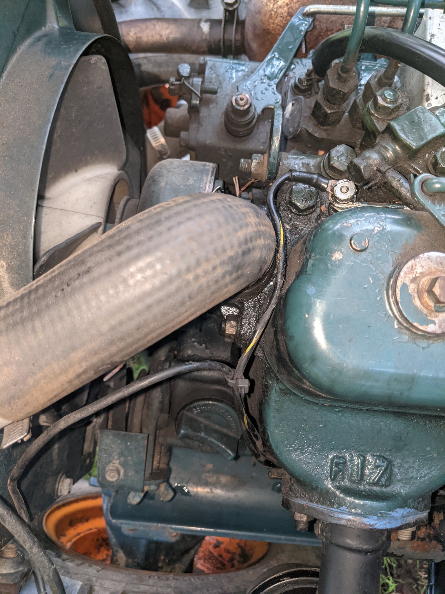

Got the fuel line replaced.
And the new glow plugs installed.
Boy it's tight to get them out but they can just squeeze out past the injectors with everything still hooked up.
Next up is the glow plug indicator. I'm not sure how bright the coiled wire is supposed to glow but mine barely does.
When I replace that I'm going to check the wiring of the glow plug circuit too.
I read 10.5 v after the indicator and at the glow plugs so I think it should be ok. Is there any other tests for the circuit?
This is my first diesel engine so it's a bit of a learning experience.

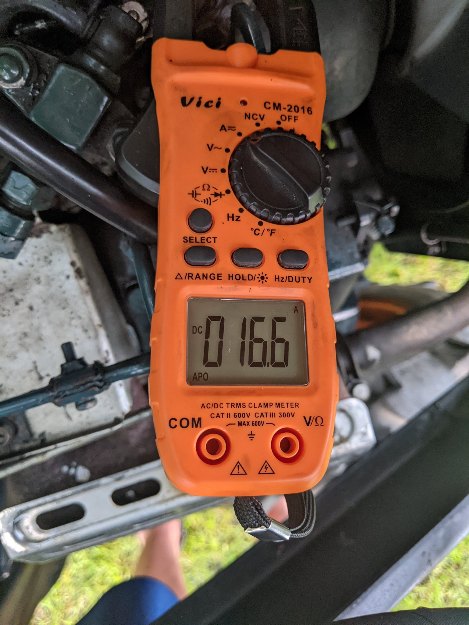

I took a quick reading with my Amazon special clamp meter and got 17.8A cold and 16.6A after 30 seconds or so over the wire going to the first glow plug.

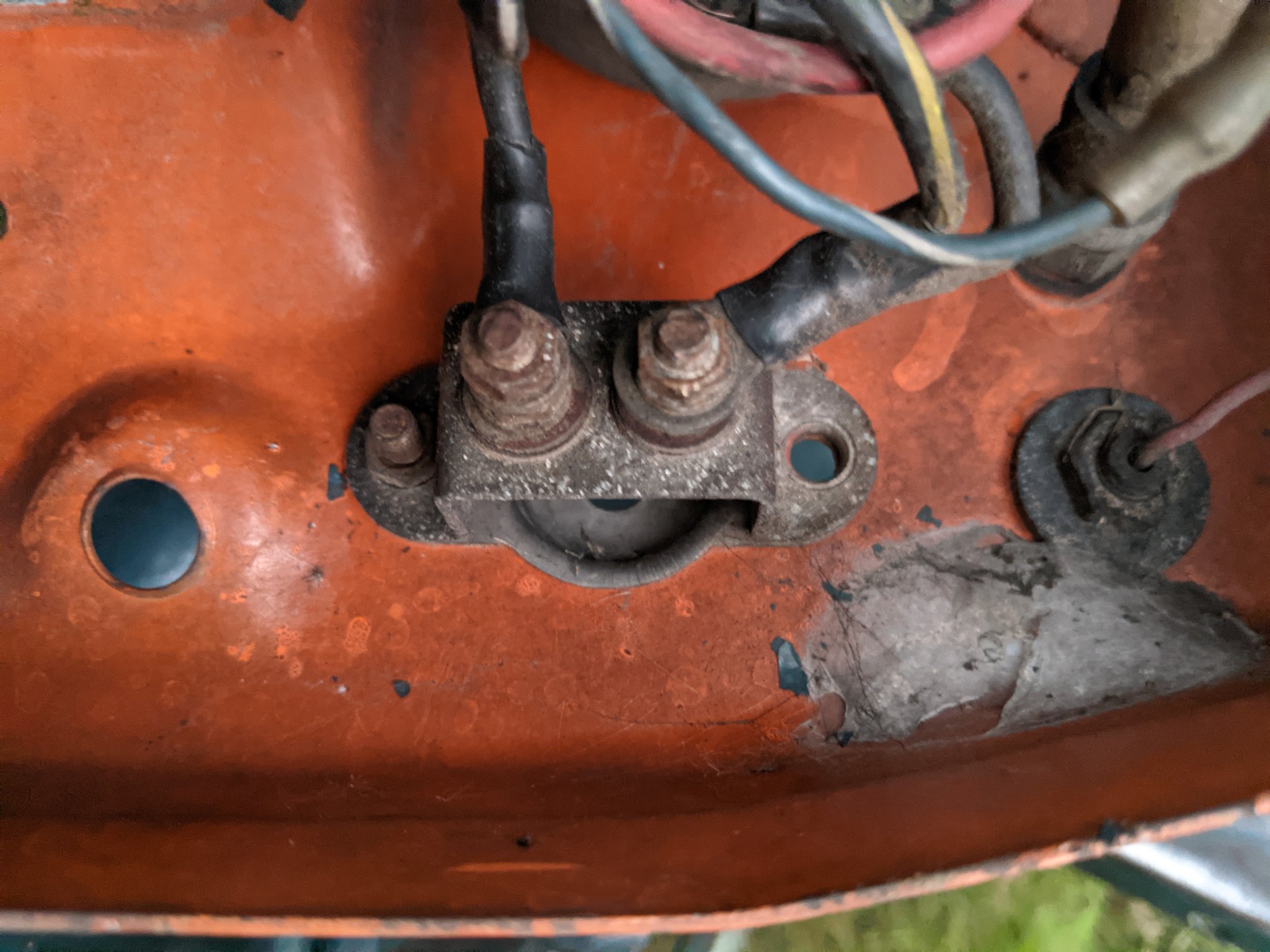

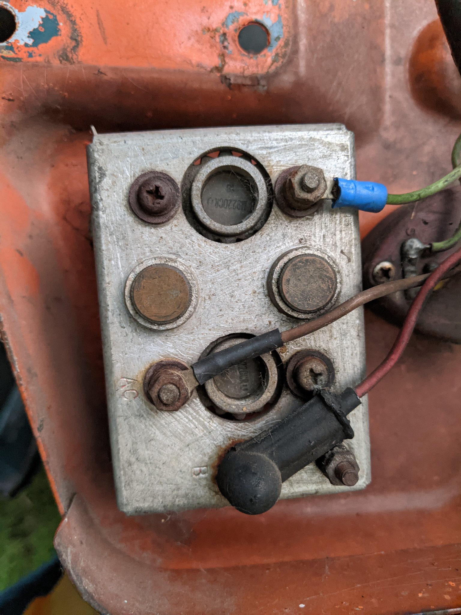

Looking at the glow plug indicator wiring…it may have been modified. If you have a wiring diagram please look into it.
On my older L185 the wiring has two connections on one of the posts is what I noticed is different on yours.
In the preheat switch position mine is wired from switch to glow plug indicator then to the glow plugs. The glow plug indicator drops the voltage in this case.
In the start switch position mine is wired from switch then to far side of the glow plug indicator (bypasses the indicator wire coil) going straight to the glow plugs. The starter drops the voltage in this case.
your glow plugs seem to be active in glow position but I don’t see if the glow plugs are active in the start position

Thanks Russel,
I'm not sure if it has been modified or if it is because it is a "Grey" tractor.
To preheat the glow plugs requires turning the key switch to the left of the off position. It is not on a separate switch as the manual indicates.
The hole where the glow plug switch should be is filled with a rather factory looking orange plastic push in plug.

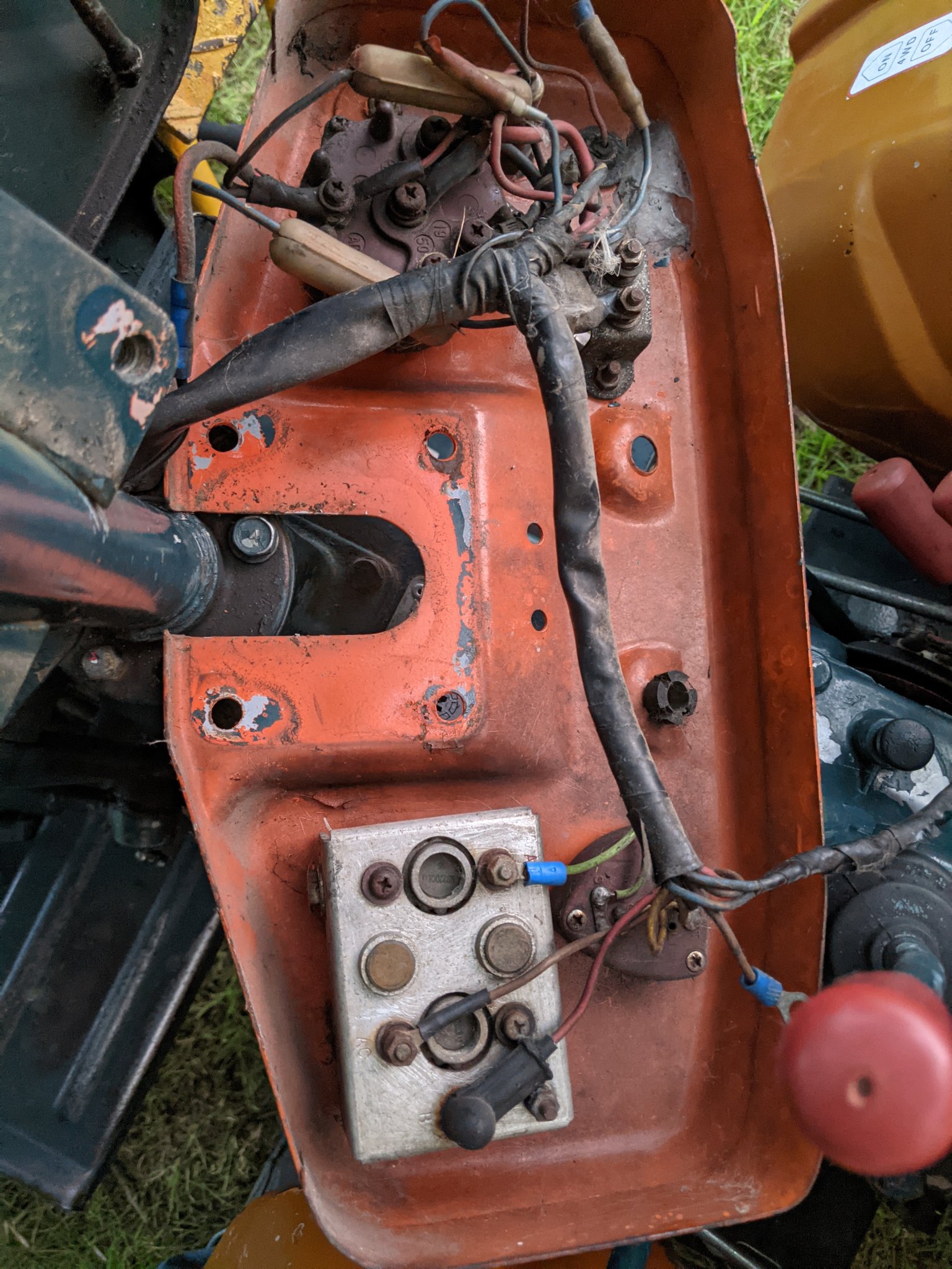

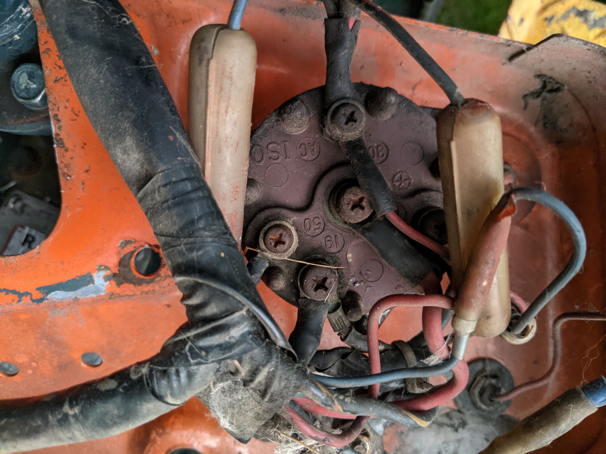

Couldn't sleep last night so after a couple of hours of tossing and turning I got out of bed to do something productive.
Drained the oil from the rototiller and put new stuff in.
And while it was draining I went through all the wire connections in the dash and cleaned them and reassembled with dielectric grease. The glow plug indicator was the worst of the bunch.
Also did the battery connections, starter and ground connections.
Got back in the house at 7 and everyone was still sleeping.
Of course I didn't take any after or during pictures but this is the underside of the dash before I started.

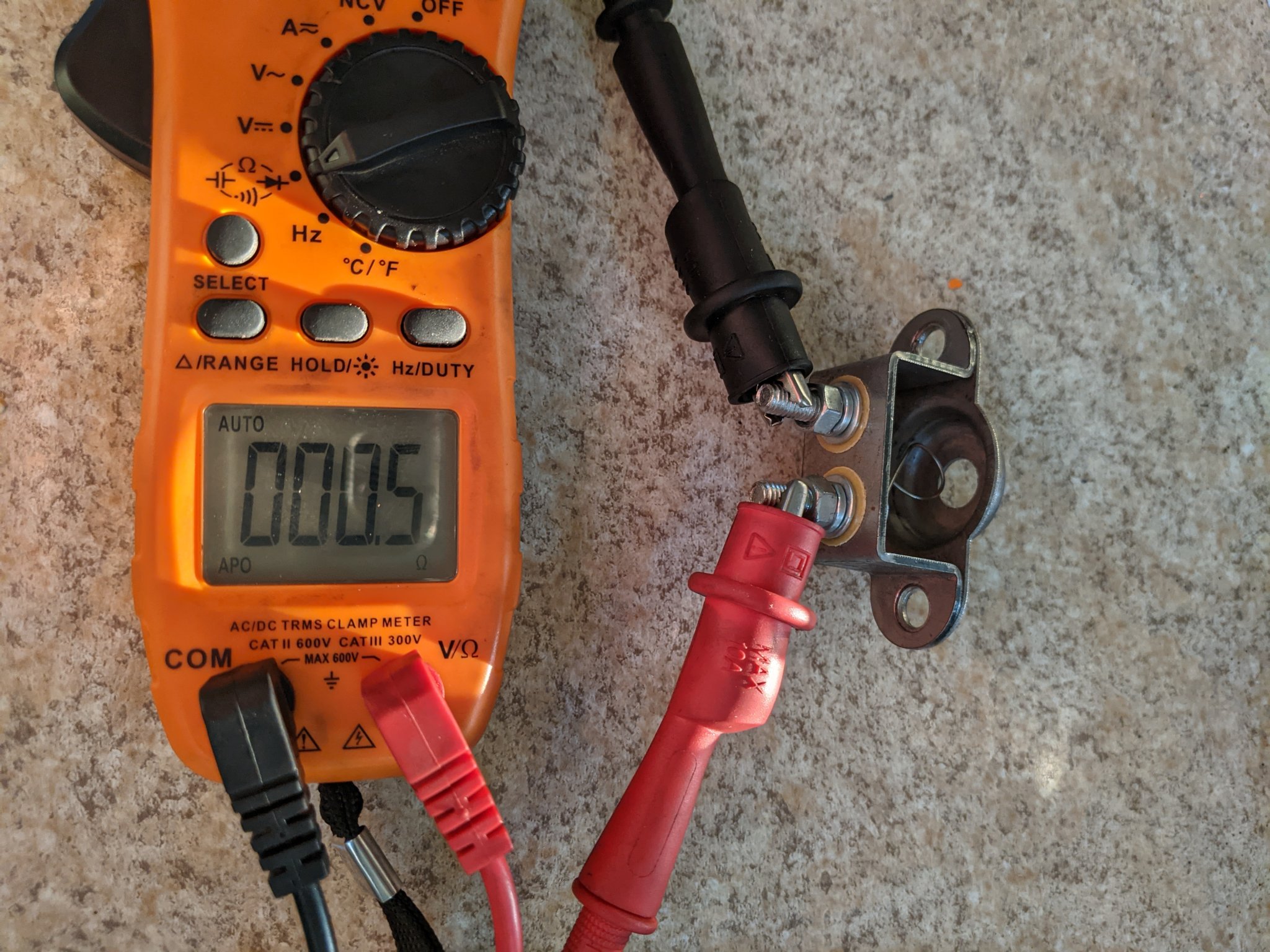

New glow plug indicator came in... It was an Amazon DVparts brand that had good reviews.
Looks like the coiled wire should light up better than what is in there now, it's a much thinner gauge. Not sure if that's a good thing.
It measures 0.5ohm. After I pull the old one I'll measure it too.
View attachment 107290 View attachment 107291 View attachment 107292 View attachment 107294
From the "before" pictures, it is quite obvious that your 0 dark thirty diaelectric grease efforts were very worthwhile!.
