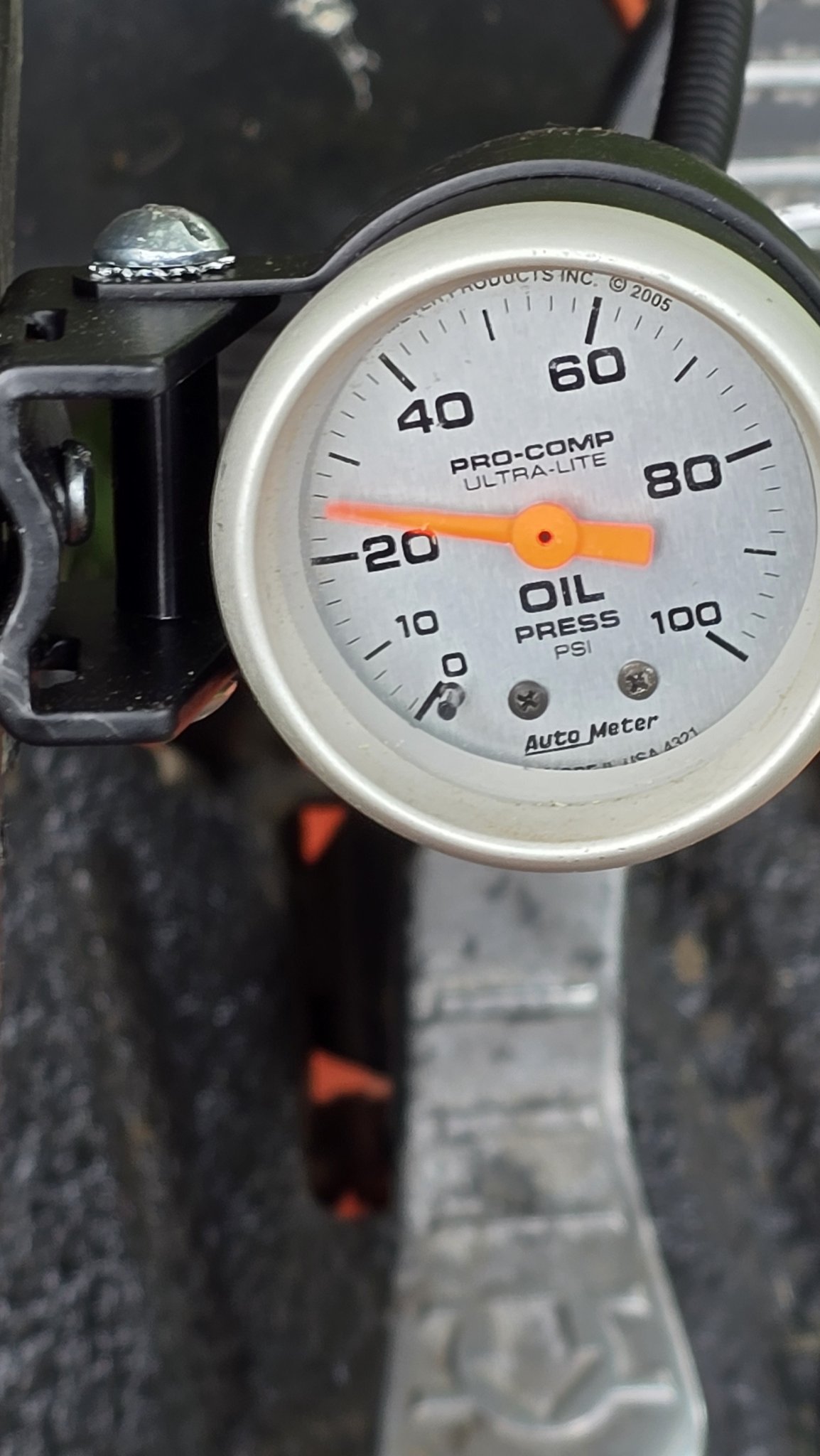

Just wondering if anyone knows the spec for normal oil pressure on a D782 engine? It's now got 1000 hours and been pretty well cared for. I run T-6 5w-40 in it.
Going to be mounting a mechanical gauge on it today. I know I can wade through my Shop Manual but just wondered since I m online not working on it right now. :D

Anyway I have it back together. Oil pressure at a "cold start" was right around 45-50 PSI at idle. As I got it hot and running doing yard work today, pressure ran more in the 35 PSI range at 2000 RPM and at idle dropped to 20-25 PSI.
So while I have not looked it up in my WSM I have a feeling that is quite normal. But I think tomorrow I'll check it out in the WSM
