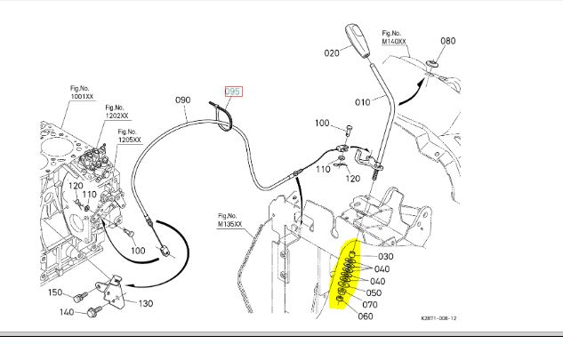

I have a 2018 BX2680 with only 26 hours on meter. When I go to give her half or full throttle, she always goes back to the idle mode. Cruse control is turned off. What am I doing wrong, do I call the Dealer? Thanks in advance.

There is 2 nuts that lock together under the dash that you adjust to keep some tension on the throttle linkage, to keep it from doing that.

Thank You Wolfman, I'll see if I can get my fingers in there.

Yes -- this happens to just about everyone with a BX. One of the first things I did was to replace the bottom factory nut with a nylock nut (then kind with the white plastic bushing inside it.) I have not had to re-tighten again ever since. I think it was 19 cents at the hardware store.

+1 on the Nylock. Poor design from Kubota. :(

Update: Found nut (Lock Nut) laying on bottom of inside when I took off cover below dash. I admit this is a poor design on Kubota's part. Found other nut loose on throttle shaft. Tighten both nuts and tractor worked fine, but would still wants to go to idle after about 5 minutes. I will wait until the 50 hour service is due, because I do not want to over tighten the two nuts and break the shaft, so will let Kubota fix it.
In the mean time I will install a nylon locknut. Thanks to Wolfman and others for your inputs.

HD, play like Columbo. Send that picture to your dealer and ask him what it might be to. Then mention the idle problem, just so he's aware it's going on.

D2Cat Thanks, I have sent the picture plus info to Dealer. We will see what happens. I had to repair tractor, because I had to mow 2 foot high weeds.
