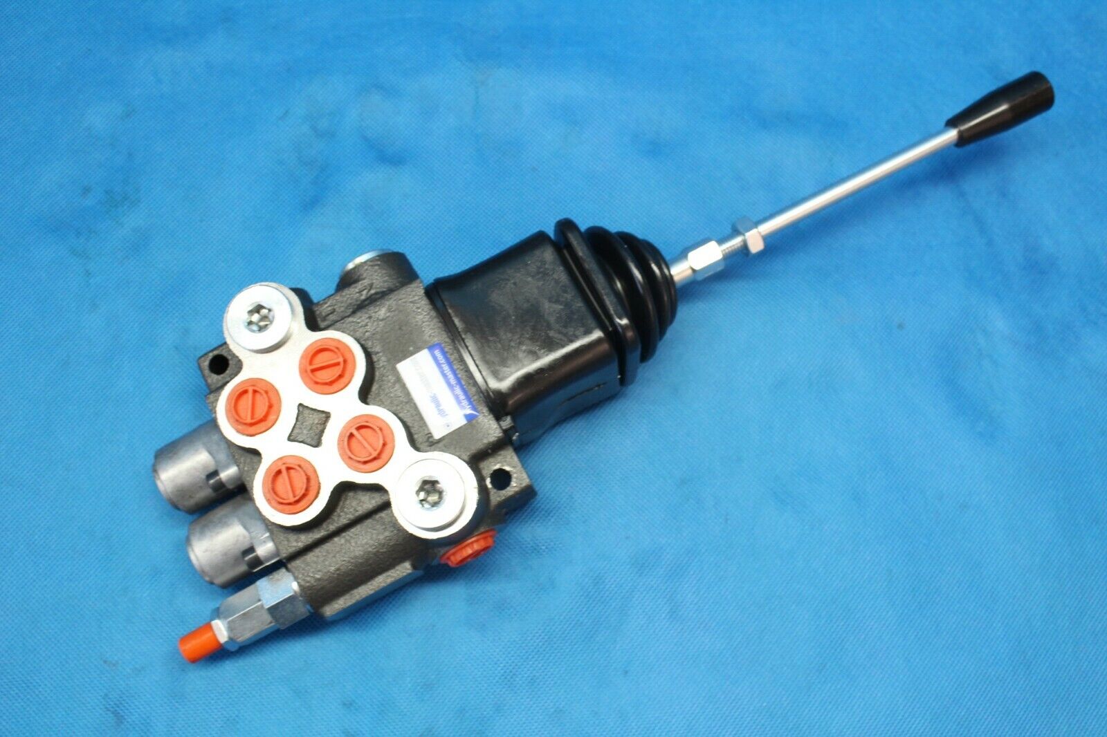

It's a Koyker 100-200 series valve, made by Hydraulic Masters.
I see that picture on eBay. There's no indication that a power beyond sleeve is included
How many total hoses are on your valve, 6 or 7? Probably 7. If so, you'll need a power beyond sleeve to fit that particular valve - shouldn't be more than $20ish.

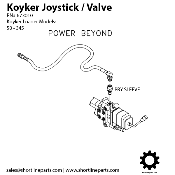

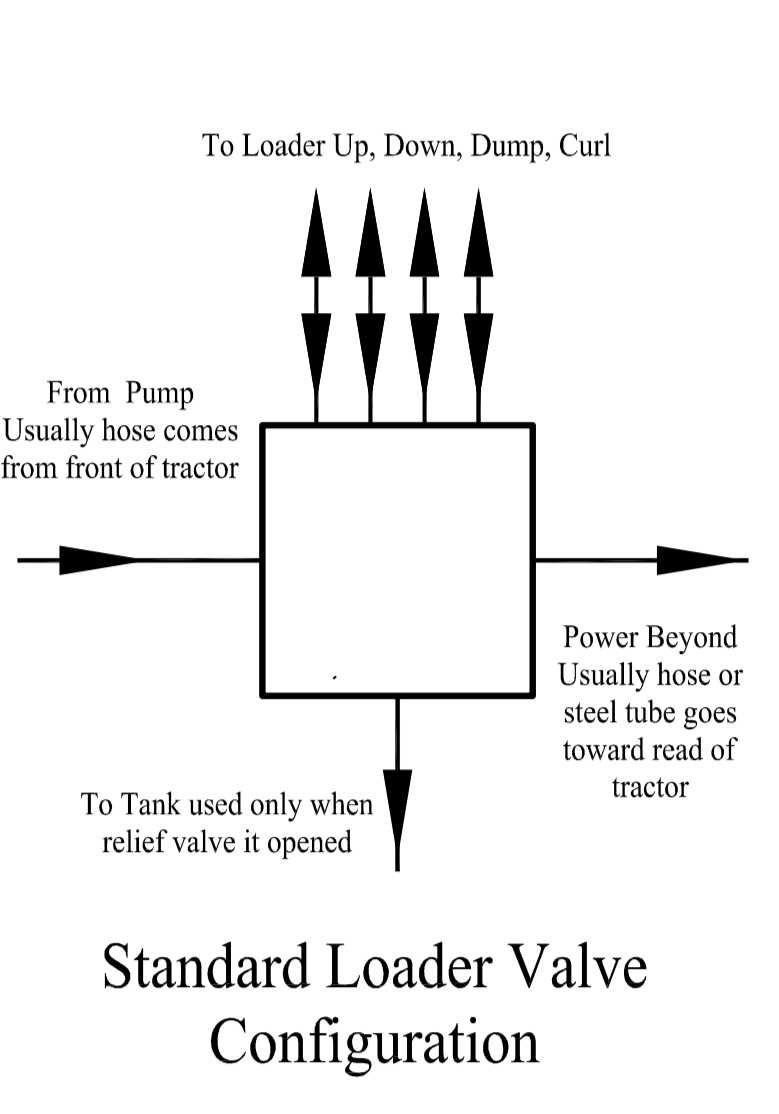

I'll edit this post to add a couple of diagrams in a few minutes. The important point of these open center systems is that the fluid flows in an open series circuit through all the valves until diverted to a cylinder. In your case, it runs from the pump to the loader valve to the 3ph. The extra connection on the loader valve lets the relief valve discharge back to the sump unobstructed.
Here's what you need:
Here's a general diagram of what you're trying to accomplish:

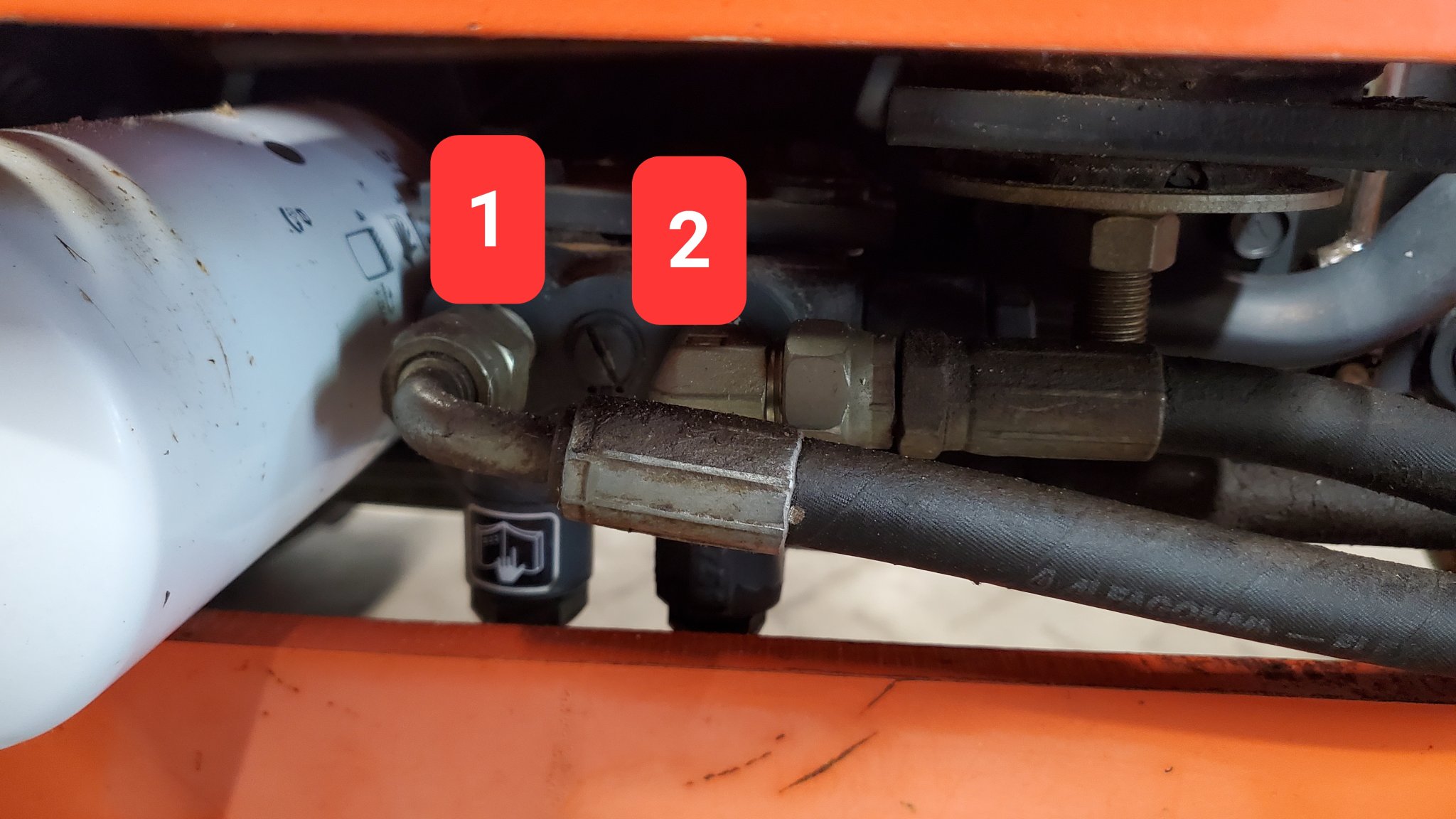

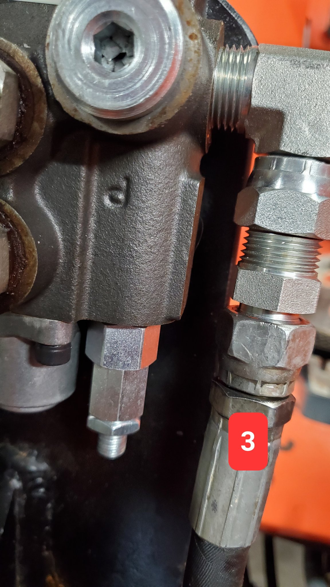

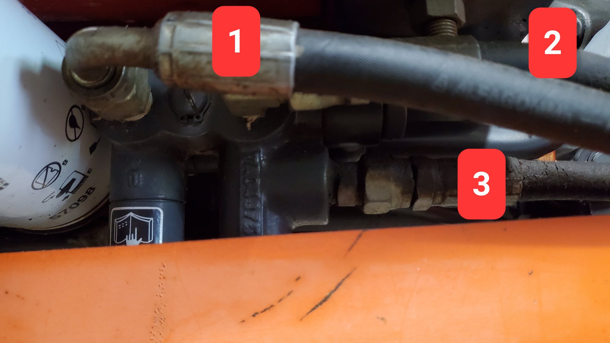

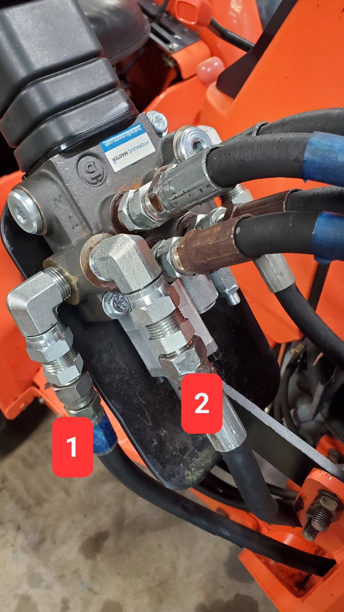

Here is the valve, the stamps, the hose arrangements (numbered). From y'alls info it sounds like I've got shit plumped incorrectly, but take a look at the pics & see what I've done wrong/right.
Hoses 1 and 2 are both connected to the tank (T) port. Hose 1 should be connected to the N port but only AFTER you install the optional power beyond sleeve. I also question your choice of fittings. Those ports are usually SAE not NPT. The N port and power beyond sleeve are DEFINITELY not NPT.

I had to adapt the 1/2 pipe threads in the valve to the 1/2 JIC threads of the hoses. Only way I could get it work. Again, hydraulics/plumbing are not my strong suit & I honestly can't afford to send it to a shop.
So, if I put hose 1 in the other port with a power beyond sleeve, it should work? What about line 3? I now see there's a P marking on the top port, so do I move line 3 to it also?

Once again - I do not think the ports in the valve are NPT. That would be an unusual option for a Badenost valve. Ilets and outlets are usually SAE 10 or 1/2" BSPP. I am POSITIVE the N port is not NPT. Likewise the work ports are either SAE-8 or 3/8" BSPP.
There are two inlet ports on the left side of the valve - one on the top and one on the side. You can use which ever one you like.
There are two tank ports on the right side of the valve - one on top and one on the side. You can use which ever on you like. You can even use both if you ever need a tank return for another valve
There is one power beyond port on the right side of the valve. It is marked N and is connected to the open center and both tank passages in the valve. Installing the power beyond sleeve connects it to the open center for high pressure carry over and also isolates it from the tank ports.
