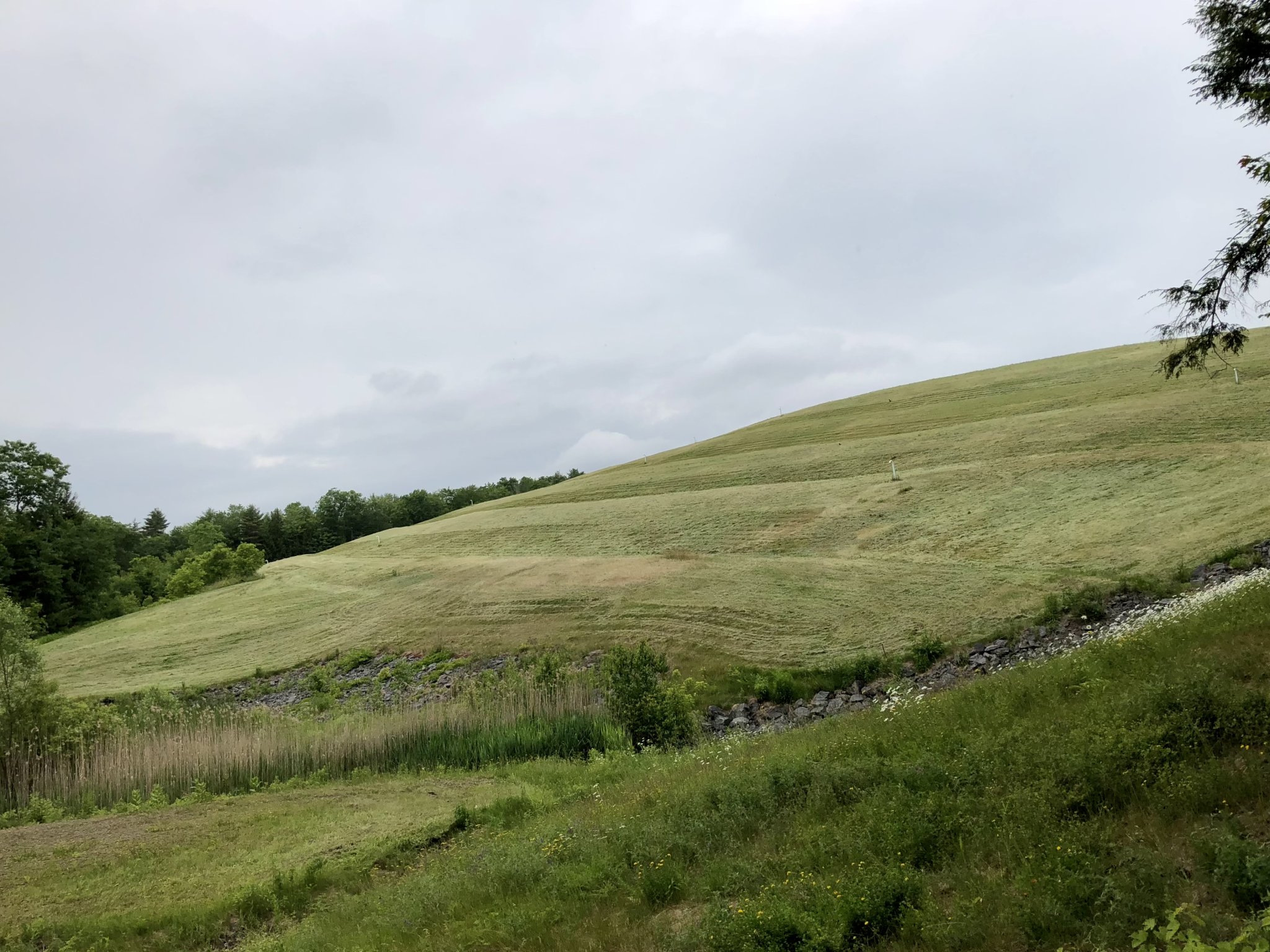

I mow on steeper slopes than probably most here. I'm including a photo of a capped landfill I mow with the MX - note the sidehill mowing - with no loader, and no weights. I run +2" wheel spacers at the rear, plus have the tires set to their widest position, and the rear wheels are loaded. Very stable operation with the 1000+ lb flail mower on the ground right behind the tractor.

Oh my…I believe my calibrated tiltometer 😉 would deform the vinyl seat…that being said I’d love a bank angle sensor/light in the dash that would work with a loader loaded or without and or rear implement attached. I am sure I may piss and moan on the price but it could be a shutoff mechanism as in a motorcyle rather than light / readout?

That's some serious mowing there! :oops: No wonder you have such a wide rear wheel spacing on the MX.
