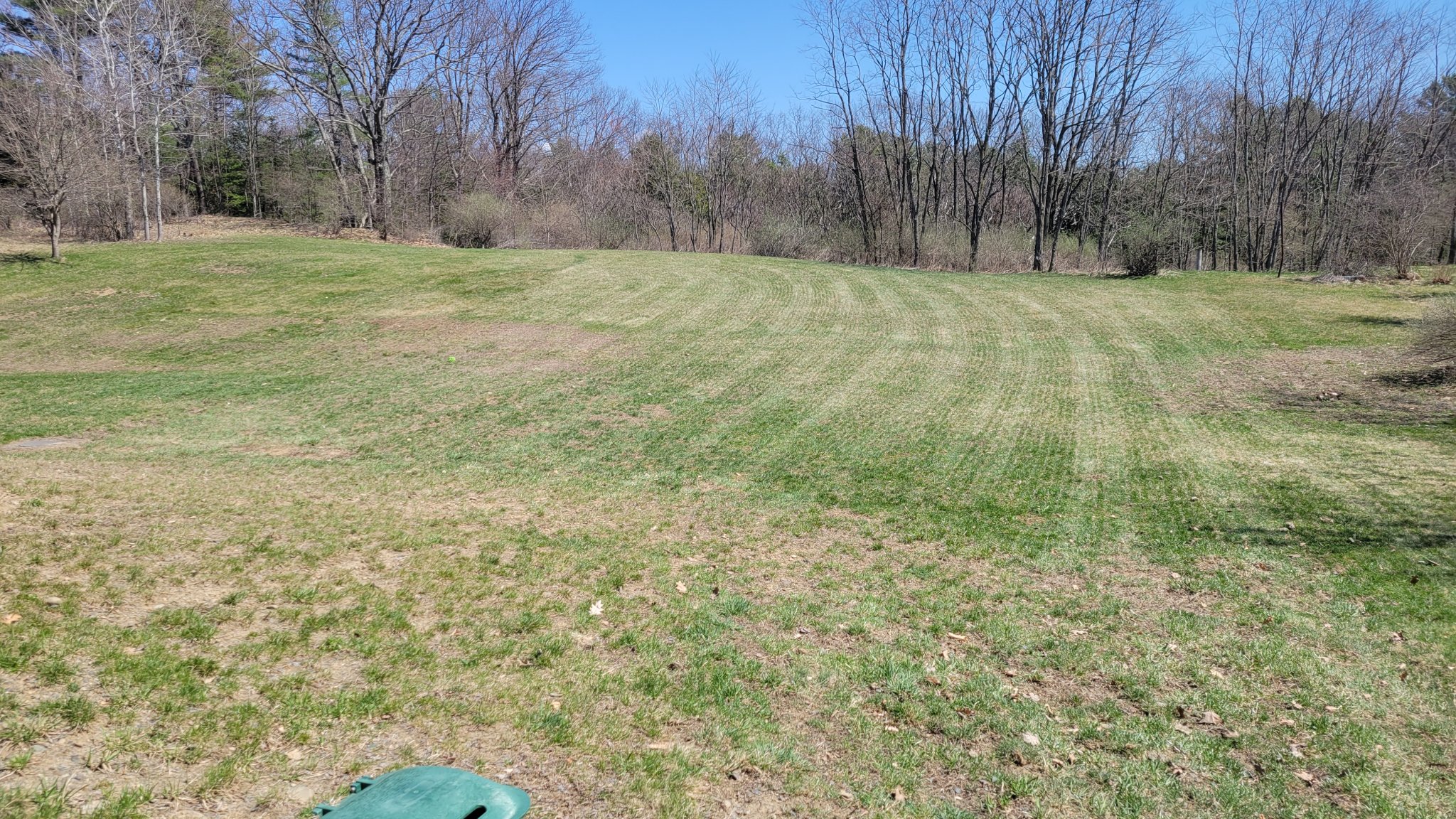

The B2601 is a fine machine. 90% of people would say I overbought for my 2.5 acre property. Like you, I wanted this to be my last tractor purchase. The chain harrow is a great tool for dethatching and sowing seed into your soil. I purchased a 6' wide by 4' long unit from tractor supply for ~$300 that does everything I've asked of it. In fact, here's a recent picture where I used it to dethatch my backyard. House is less than 2 years old so don't judge me but I hope to have a decent lawn at some point.

Property looks awesome! Where are you located? Enjoy the process. I'm 60 and see less time ahead than behind. Hopefully an old dog can learn new tricks. The chain harrow seems like an excellent purchase for me as I was thinking of buying a tine rake for detaching. I also need a tool for spreading top dressing so I might be able to kill two birds with one stone. Still much to learn. Much appreciate your input. Awesome machine you got enjoy it.

Thanks. Upstate NY between Albany and Massachusetts. You will love having a tractor. With a handful of implements, it will greatly simplify everything you need to do on your land.
