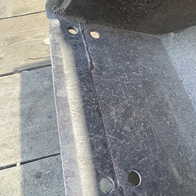

Looking at my Kubota B7100HST-D FEL bucket: What are these 'features'
used for??
?? Loose pin with hole for retaining pin
?? The rectangular piece on the side?
?? The side hole aligned with a threaded 'bracket'
And.. at the front end:
The round bar across the bucket looks like its been used for lifting
IS that common??
One metal hydraulic line has been bent. Straighten it?? Leave it alone ??
THe gray section of the tractor frame has sets of holes in it, maybe threaded. What are those for??
The bucket has those series of holes.. What are those used for?? Lift points??

The brackets and pins on the loader bucket were to hold the bars to remove the loader.
No your not supposed to use the center cross bar for lifting.
Bend the line back.
Someone drilled those holes for something the made up, they are not factory.

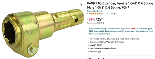

Sometimes the PTO shaft for an implement is cut too short and that is a cheap way to add some length back.
Also, there are some tractors that have a shield that makes it difficult to get the PTO shaft onto and off the PTO stub shaft. This would get it to be more accessible for that situation.
