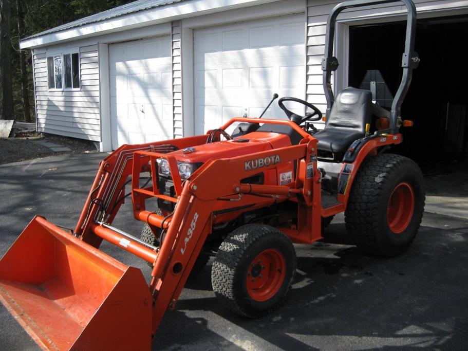

Hello. I just bought my new (for me) Kubota B7610. Love this machine and got a fairly good deal on this used one at my local dealer. Also got a MMM for it, but it has not arrived yet...
Two things... The one thing that bothers me is the exhaust pipe is low and to the front. When traveling forward there is a constant wafting of exhaust in my face. Is there an extension for the pipe that will direct it elsewhere??
Second, I notice that the two speed rear pto is engaged when the mid pto is engaged. I there something I'm missing here? Can I disengage the rear pto when operating the mid for the mower??
Here is my ride...
