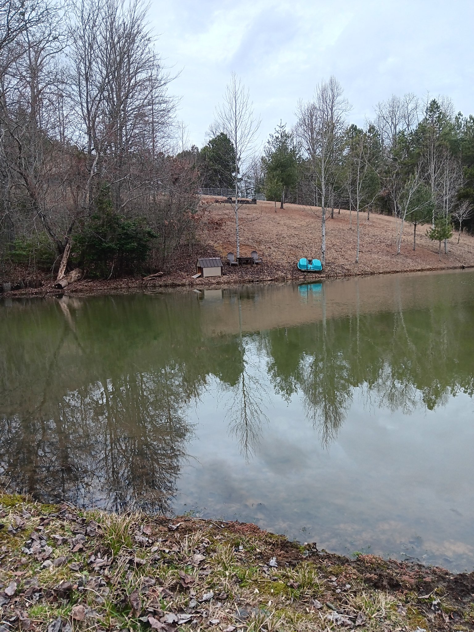

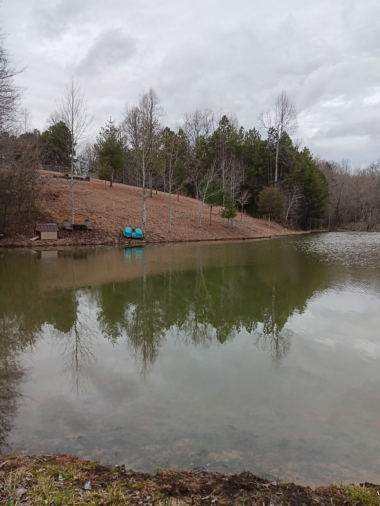

Hi all. I have had my BX2200 for ever. but I just moved to NC mountains and have a steep slope to mow. .looking for more stable feel. has anyone moved the Guage wheels and put 3 inch spacers on the rear? did it help? was it worth it? should I go to a zero turn?. if I roll this I end up in a pond....

Its actually pretty hard to roll a little tractor with a belly mower. Three inch spacers seems a bit excessive but I will defer to your judgement. I have never sat in that seat or on that hillside.

I understand zero turns can get a bit unwieldy on cross slopes and turning around on the same. The pond may be a concern with either piece of equipment? I’ve seen pictures of both stuck in a pond.

Straight up and down slopes is the safest way to cut the grass. If it’s a steep slope, I prefer to back up it and cut on the way down. My experience is that a FEL won’t help make a tractor more stable in this situation. I think it tends to destabilize it and increase the odds of whacking something unintentionally. YMMV.

That said, I have to say this still seems like a sketchy proposition. While it's generally safer and you should have more traction going up/down vs side/side on slopes, that's really difficult to do mowing up/down a pond bank with a tractor, ZTR or other wheeled vehicle. You'd have to drive down the bank and precisely stop/reverse just before the wheels reach the water... multiple times.
If it were my place I'd be liking the goats or weedeater solutions. Best of luck and please be safe!

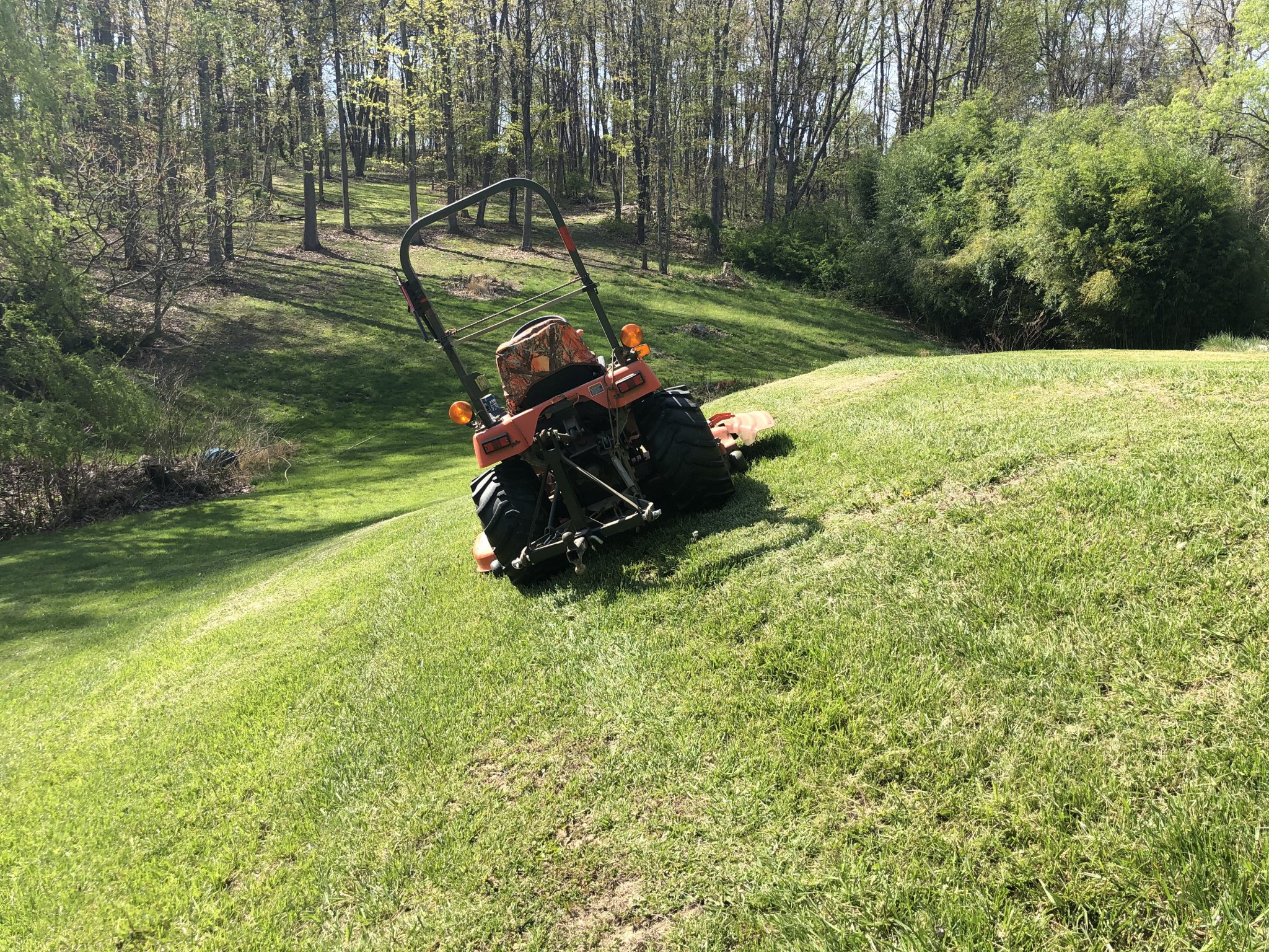

When you say steep slope, how many degrees is that slope?
I had my four tires foam filled by an industrial tire shop to increase stability. Actually, the front were foam filled first to prevent punctures. Puts a lot of weight down where needed for stability.
My BX with the foam filled tires and the 60 inch MMM hanging down low is quite stable. This is about my limit (pucker factor) for sides slopes though. I did get off on the high side and push on the ROPS hard and it was rock solid. Of course, that was a static test. The dynamics are different when the tractor is moving. Mowing a cross slope only when it is dry is good advice.

That looks just like the hills south of Da Burgh ,, lol
I did put 2 inch spacers on the B, did they help, I think so. MHO is that tractor should be 6 inches wider anyways,, But I digress.

You don't need spacers, you don't need a tractor, you need a BULLDOZER ! with a skilled operator (one who has done 100s of ponds,especially golf course ponds ) to terrace the land and carve in a wide 'switchback'. Yes, it's a small 'pouch of gold' up front, but the right guy on the machine will do the PROPER grading and then have a landscaper put the proper 'green stuff' into the ground. After 1-2-3- seasons it'll look great and most of all SAFE.
Yours is a bit steeper and longer than the one I had to fish the ZT out of.

well you have hit the plan. I want to do a 6 ft path along the pond and plant the steep hill with low shrubs and ground cover
