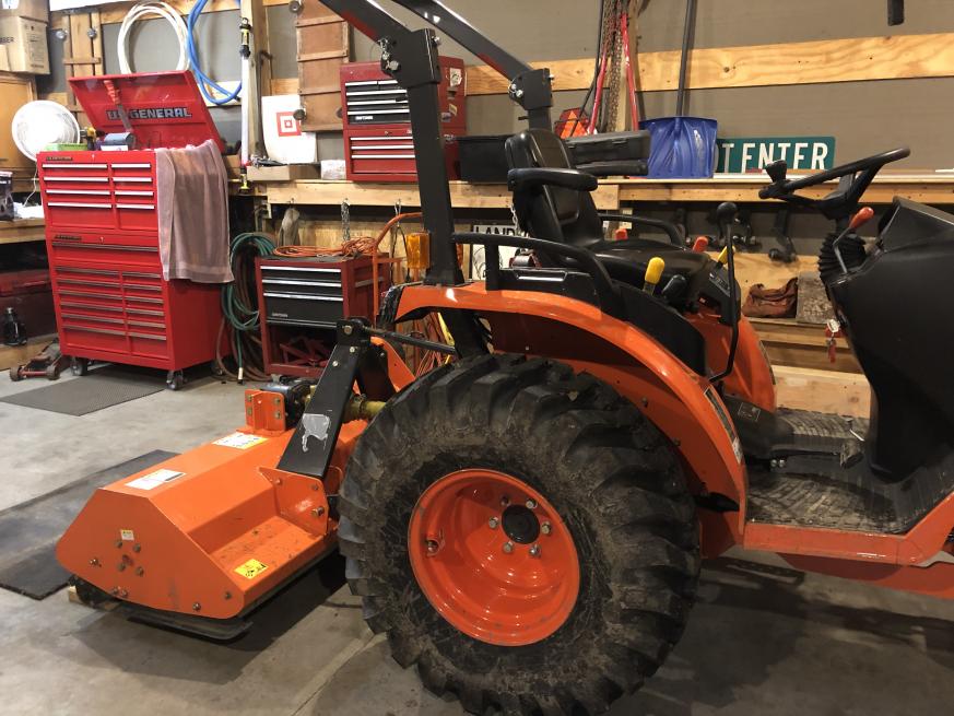

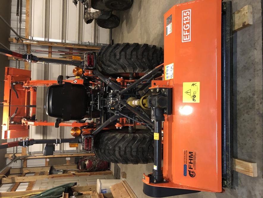

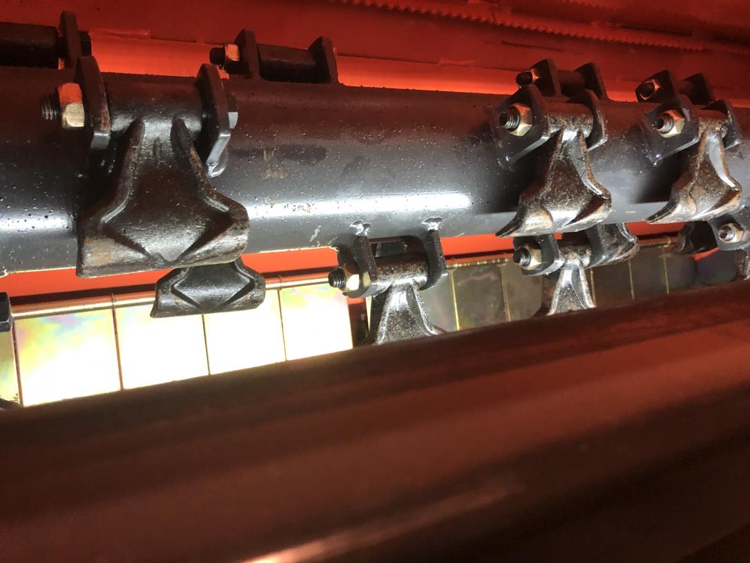

Yes. I have the FHM EFG-135. This is a medium duty flail with hammers. I specifically chose the hammers because they will cut both brush (up to around 2" diameter) and grass.
No problems with the unit as yet although I haven't really used it all that hard but for cutting approx 5 acres of waist/hood height weeds.
I'm sure there are better units, but the FHM from Betstco was very reasonably priced with free shipping as well.
here's a few pics of mine with the hammers.
