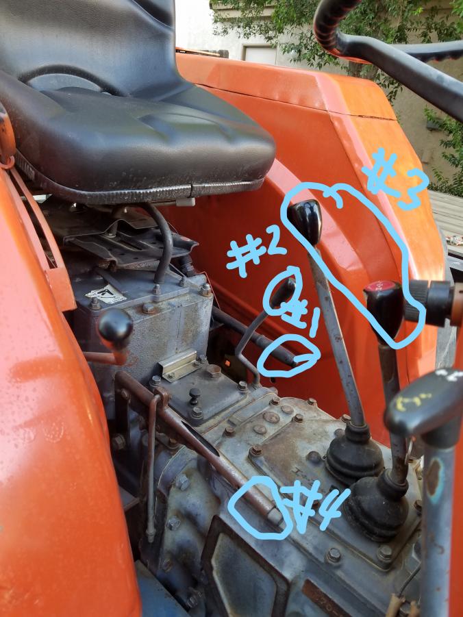

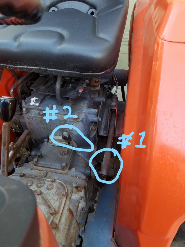

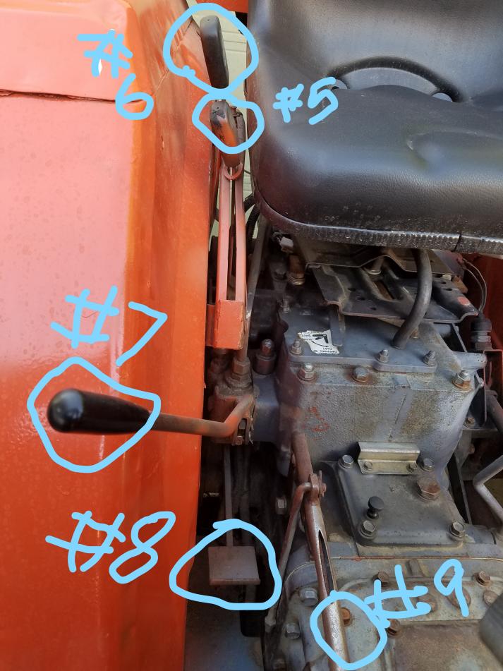

I just picked up this tractor and can not for the life of me figure out how to engauge the 4X4!! I have the owners man. and it shows several more levers than I have. I think that is due to mine being a "N" for narrow. I took pics of all the levers I could find. Does anyone have any ideas?
#1 is PTO clutch
#2 is PTO engauge
#3 is gear shift levers
#4 and #9 is E-Brake
#5 is 3 point float
#6 is 3 point up and down
#7 is rear auxiliary hyd.
#8 is rear diff lock (I think?)

The 4wd is electrically controlled because it has bispeed steering, so no manual 4wd engagement. ;)
