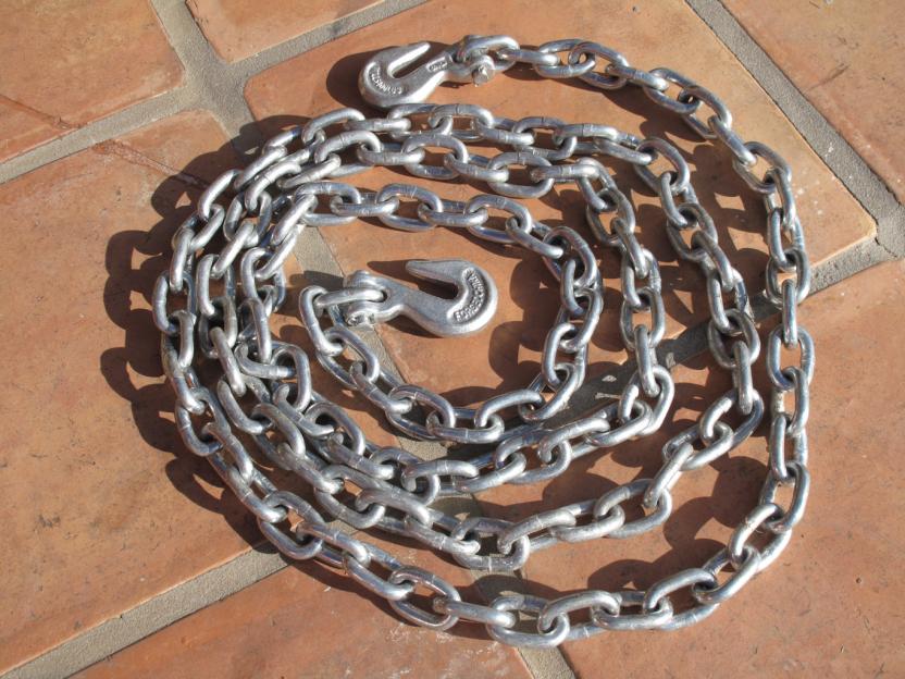

Getting those roots out, try a chain hooked to the top of your bucket or the lip. Harbor Freight has nice 14' chains with hooks. Raise the FEL and if that doesn't pull it out, rotate the bucket and that just might.

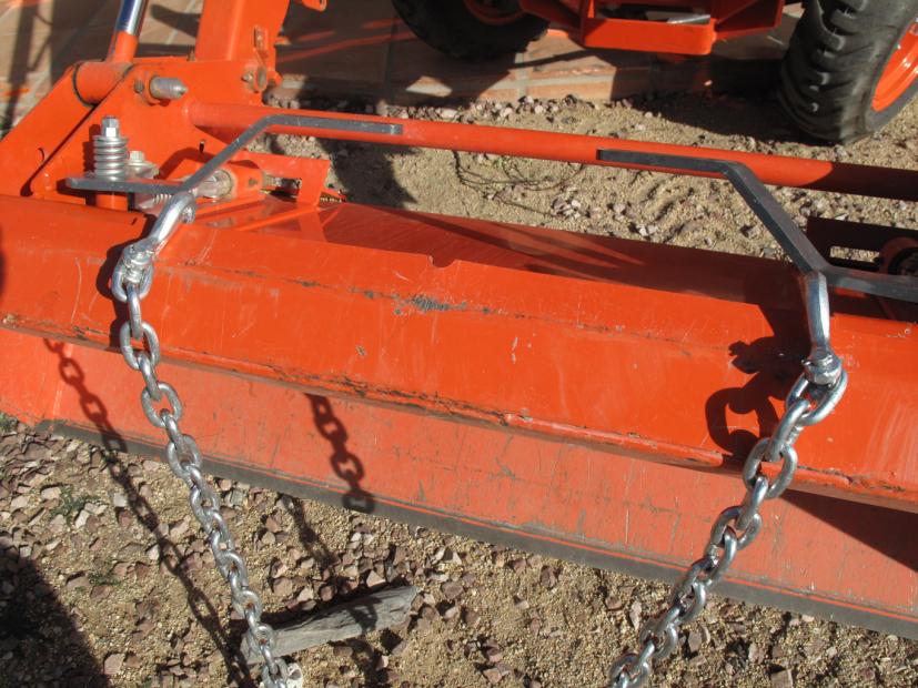

Here's what I use...
You can use this rig to pull tree stakes and other items out of the ground easily using the curl feature of the bucket -if the lift features doesn't get it.

D2's idea is a great one I have not tried. HF has longer chains if you want to double them but the chain I pictured has a 7000lb breaking strength so a single chain would probably get it.
