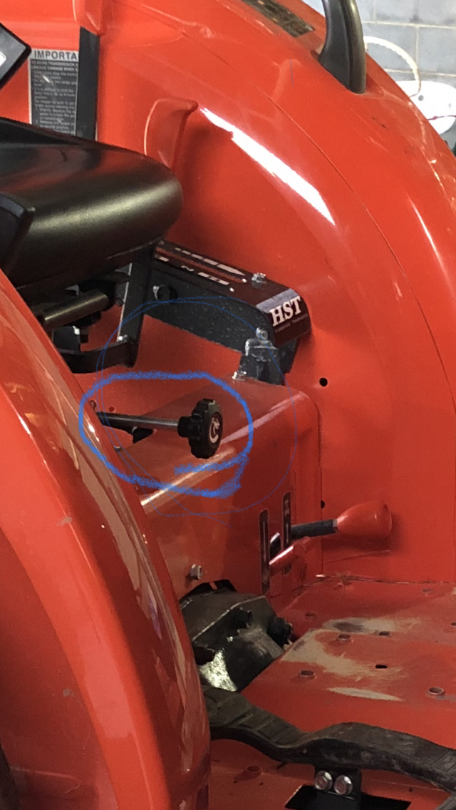

I am a new owner of an L3650 and waiting on the manuals from the previous owner. I am trying to figure out the valve under the seat that reads OPEN — CLOSE. Any other tips appreciated.

Given the location....most likely the valve adjustment for the speed of lowering your 3 point arms. Unless its a an actual OPEN/ClOSE valve that has only two positions.
A picture would be great.
3,016
4,744
Obviously, this isn’t the same model but the control and placement is pretty common. If it looks like this and is a twist off/on like a water hose faucet, it’s probably the thing that adjusts how fast the 3 point lowers.

Thanks all. I had a feeling that is what it was after getting responses. My older tractors did not have it. Found a great response on YouTube. I was used to draft control or selective draft / implement control. This makes adjusting to implement control only a little easier.

If you have a heavy implement on and the valve isn't fully closed, it will eventually fall to the ground because the 3-point hitch usually will leak past the seals when there is a heavy implement on the 3-point. I suggest closing it off unless you want it to come to rest on the ground. I have a weight box on my tractor for snow blowing, and it will settle to the ground unless the valve is fully closed.
