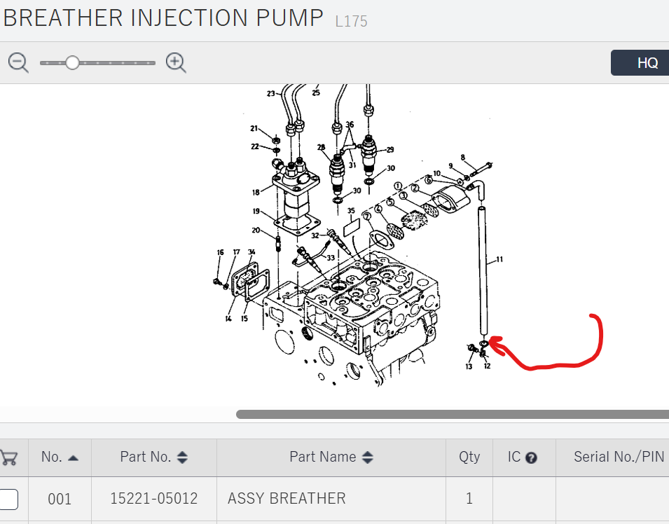

Timing is set via shims (#19) under the injection pump.
