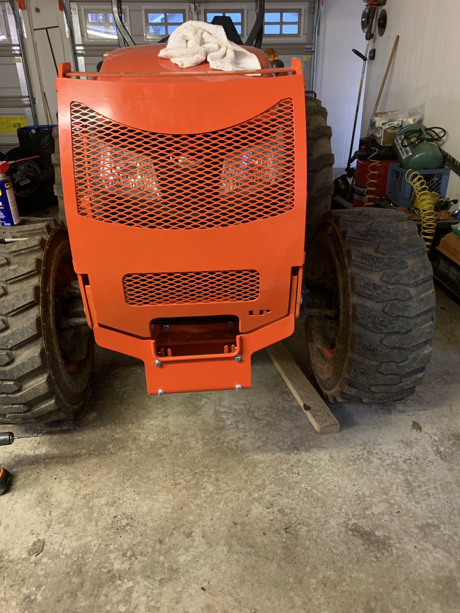

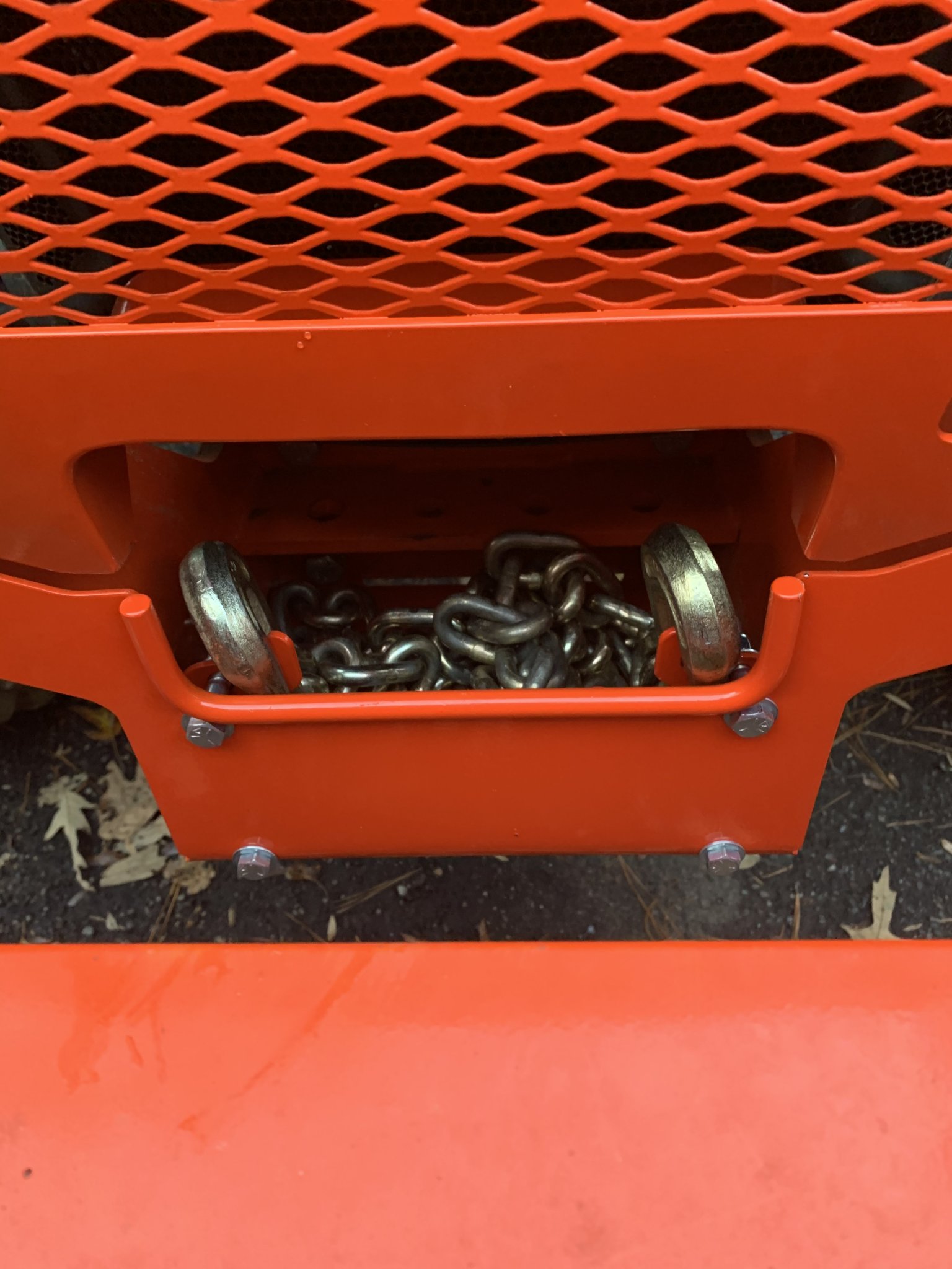

As for the chain holders, have you looked into a grill guard, for that grapple you will be buying soon?! Lol. Seriously, you need a grapple. I have a lown performance on my MX with a chain box. Very handy and is right there near the bucket. I’m sure other manufacturers make something similar.
View attachment 91073 View attachment 91074
Nice guard. I did get the expanded metal out to make one but don't think I need it yet.
Looking good Matt!!!!
