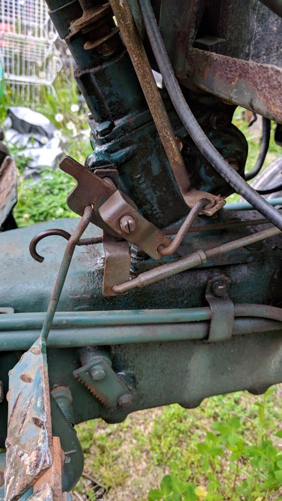

1. The throttle linkages seem to be all messed up. The hand lever is disconnected, only the foot throttle works now. I've attached a picture of what it looks like now. Could someone post a picture of what it should look like so I can fix it?

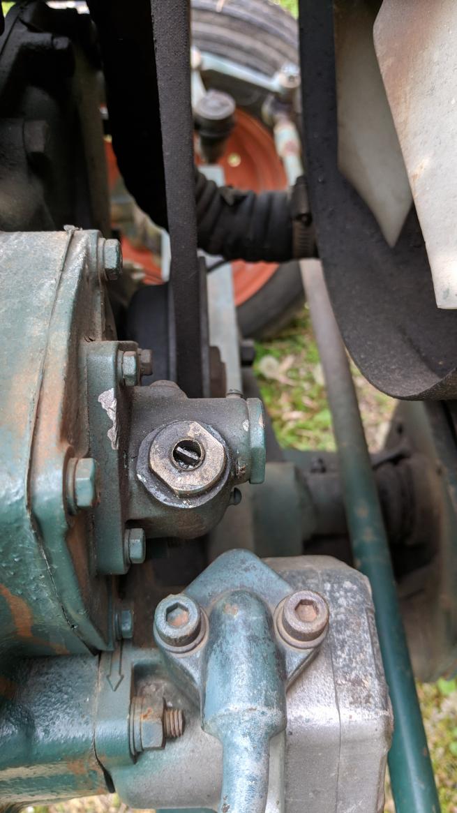

3. The fitting the RPM cable attaches to is broke. I can't find it in the parts manual to buy a new one. Does anyone know if it is available & what the part number is? I've attached a pic of it too.

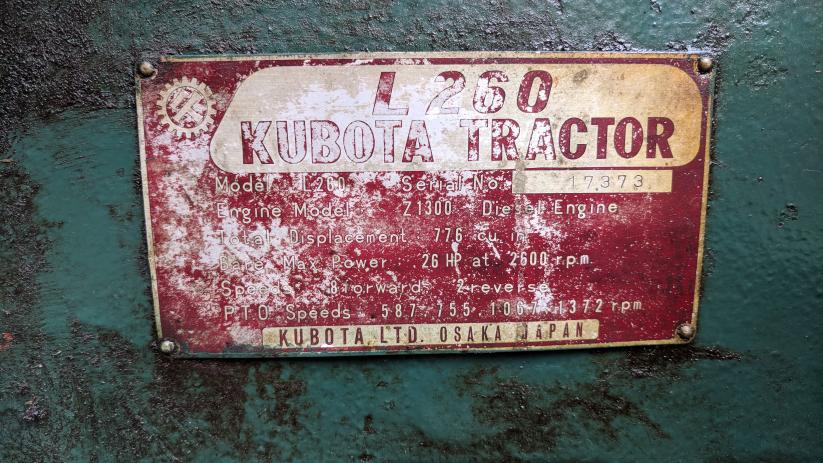

6. I added a picture of the name plate. Is this a gray market tractor? I'm thinking no since the plate is in English, but I'm not sure.

None of the L260's were Gray's so your good there.

Just by looking at the picture, it looks like all of the hand throttle parts are there, might just need adjusting.

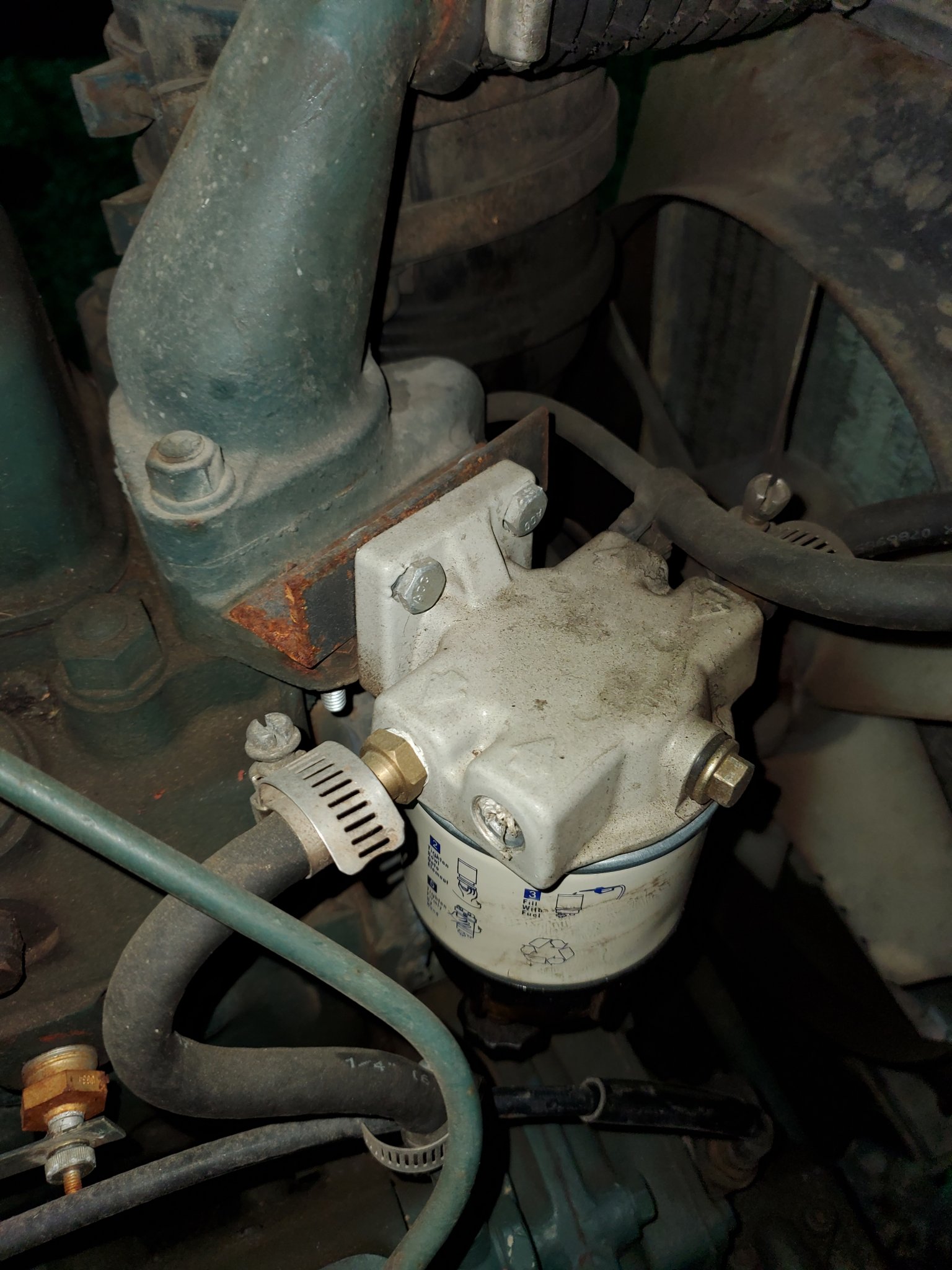

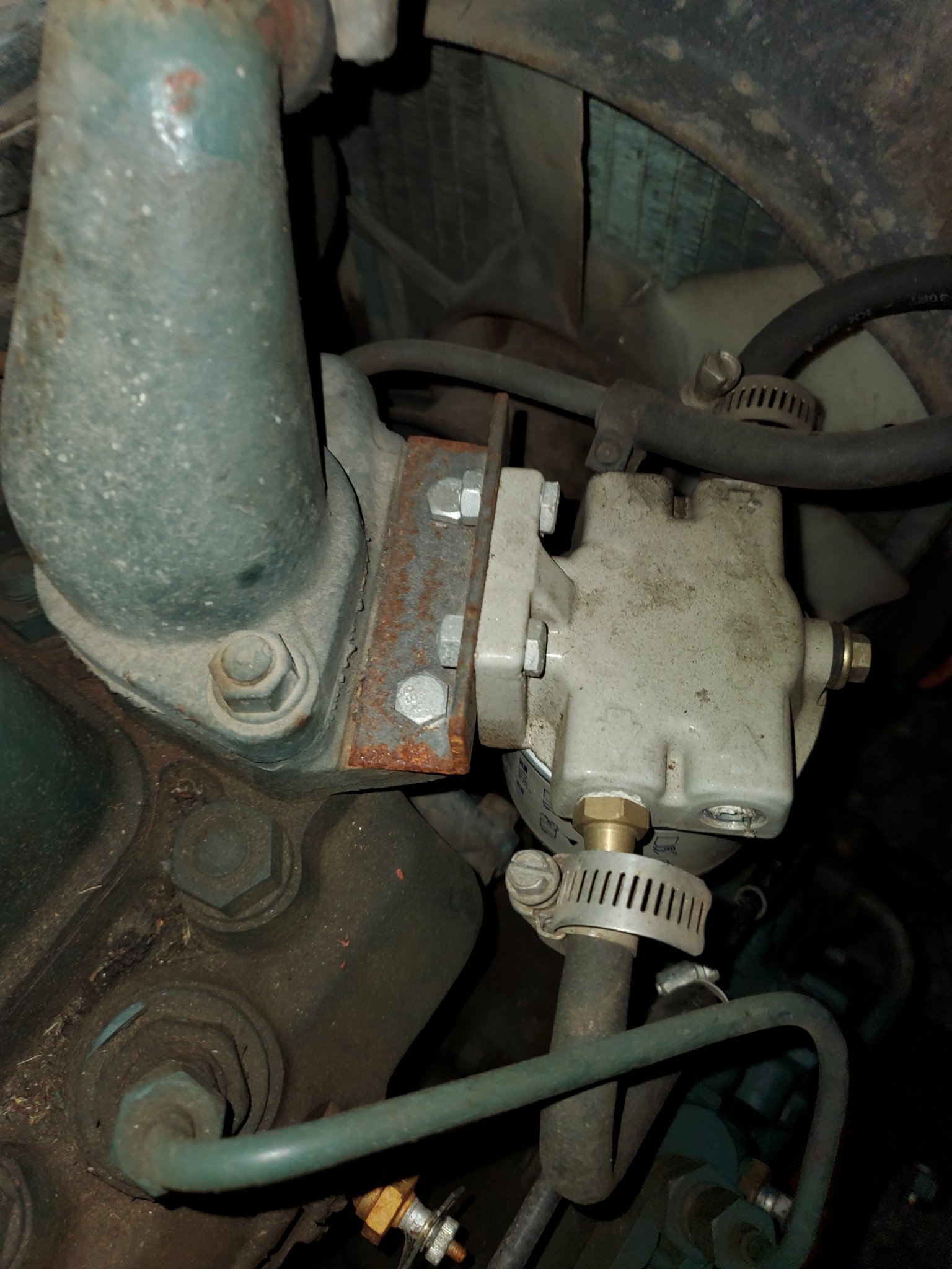

Here's a pic of the fuel filters that are on it now. I assume that the stock one is supposed to mount on the two bolt holes?
Also, is the other pic the cartridge oil filter housing?

The fuel filter housing is P/N 15109-43012
looks like its not avalible either.
Yes the bottom picture is the oil filter housing it's a canister filter.

Thanks again Wolfman. I thought that was it, just wanted to make sure.
I found an aftermarket fuel filter I'll probably get for it. Should work just fine.

I was able to rearrange the throttle linkages to get the hand lever working along with the foot pedal today. I'm not sure if it's right, but it works good now!
Also, I was able to solder the RPM cable fitting together. Now I find that the inner cable is broke! I'll check the gauge to make sure it's not froze before I replace it.
