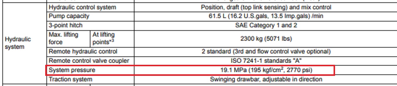

I looked up the relief pressure for the M70160 and its brothers which is 2770 psi
Remember this is described as the system pressure and you will get slightly different values depending upon where you measure it.
For the problems you describe you are not talking about a missing 100 to 200 psi. so don't get focused on slightly bumping up relief settings. Pressure gauges you and I can afford are not able to measure with great accuracy too.
Dave
I have the gauges I just have to get the remote plug in to Adapt it. I’ll report back soon.
