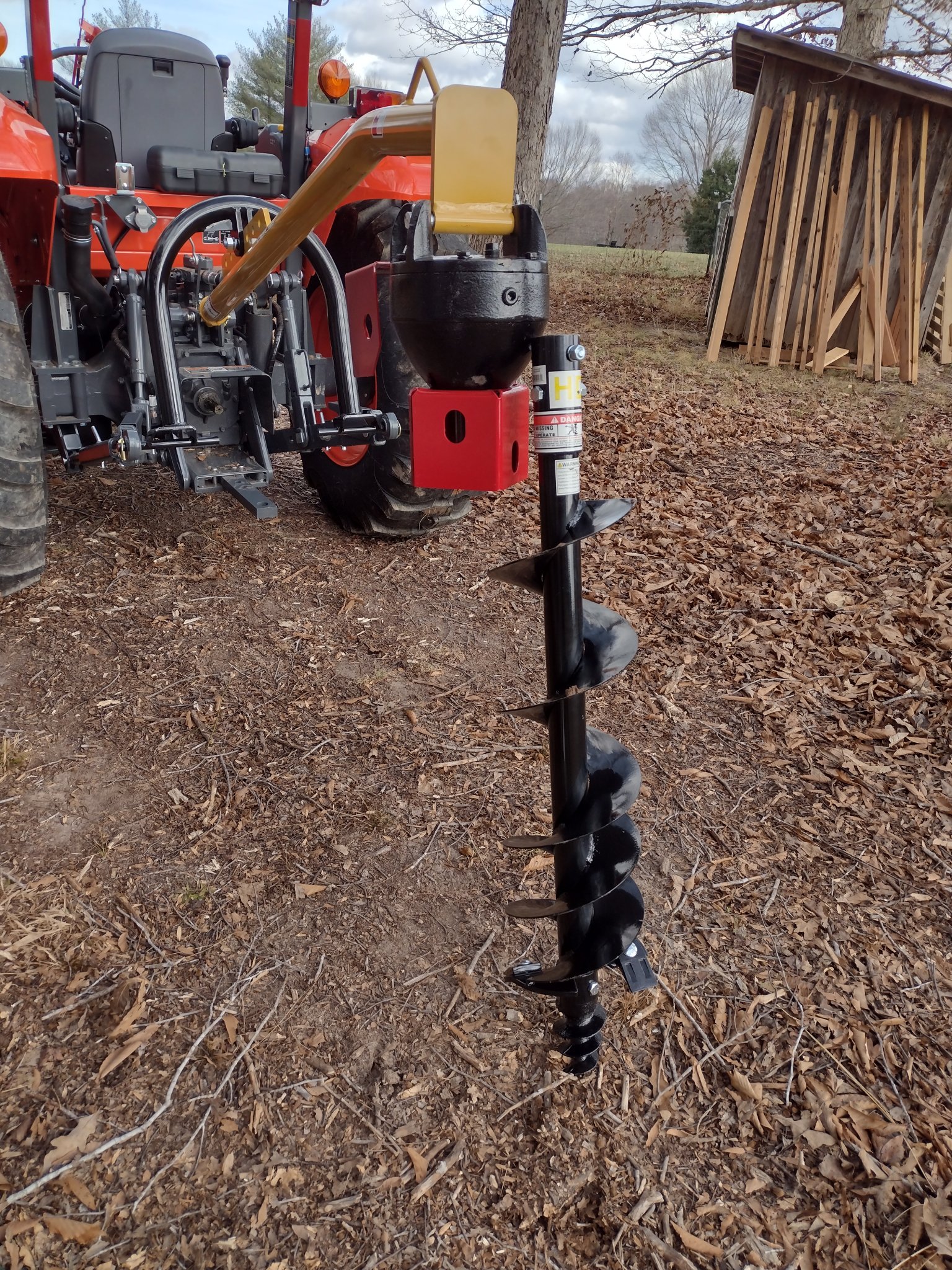

When trying to connect my auger this as high as it goes ... Cannot even get the auger under the gear box View attachment 72665
Have you moved the bolt that connects the boom to the auger frame?

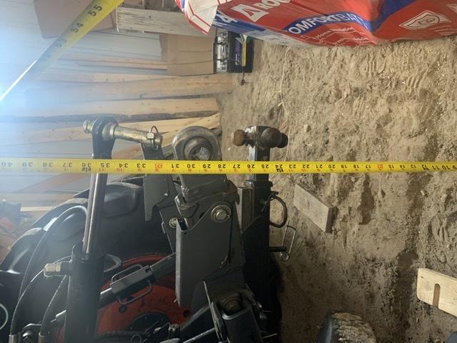

I just took delivery of a new M6060 and the 3 point will not raise high enough to mount the auger on my post hole digger. I also noticed it only lifts my BushHog about 5 inches off the ground.

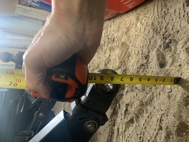

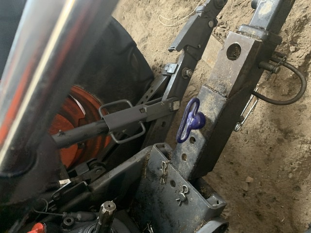

I checked both side linkages to make sure they are as short as possible, and adjusted the hole on the lower arm to try and maximize lift
Not sure what else to try to get it to have more travel - it only moves about 17 inches total from lowest point to highest measured at the end of the lower connecting ball.
