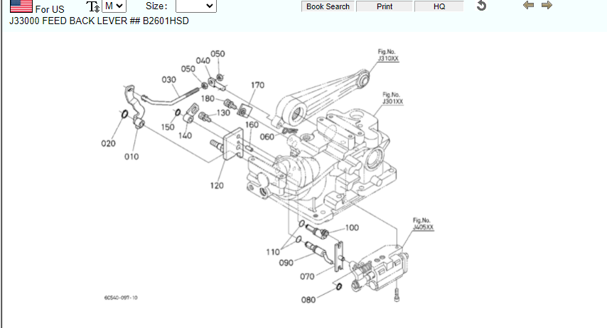

This is a L5030, but will give you an idea what to look for. And here is the breakdown of your machine. #30 is the rod.

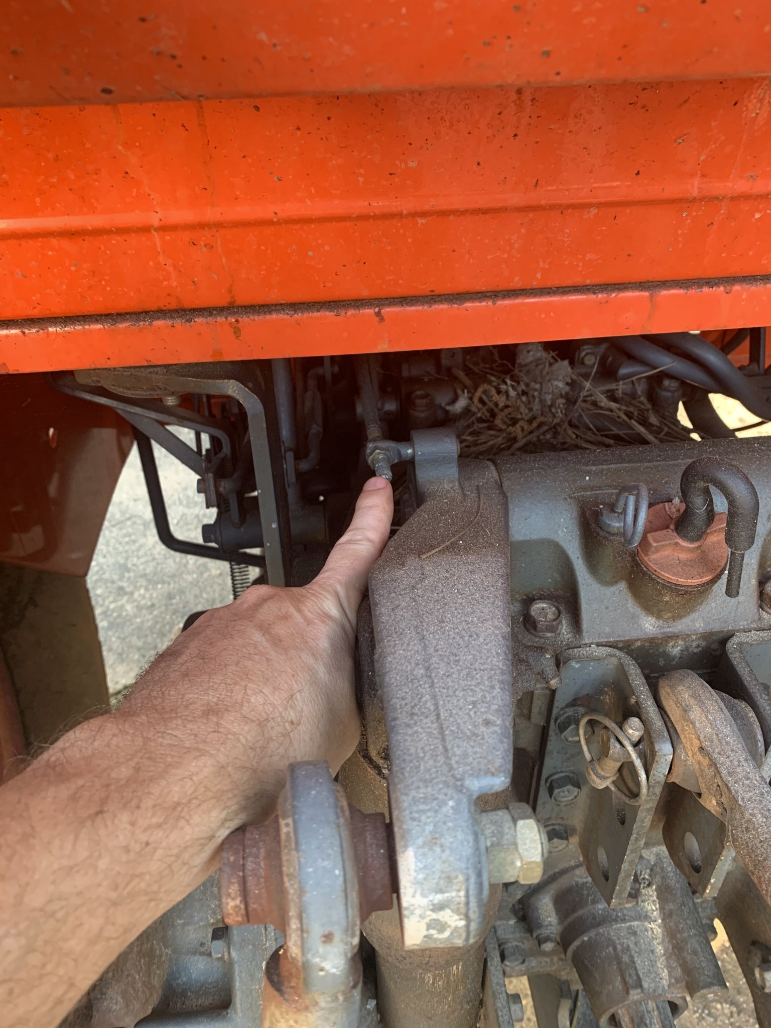

Thanks so much, Matt. I was just going out to tackle it again! Will try this.
I got that lift arm adjusted no problem. I am not very mechanical but adjusting the lift was super easy. And the system does not go into relief with it raising an inch less. Actually I killed two birds with one stone. When the ROPS is down, the top link was hitting it before at max lift. The top link was already slightly bent.
Thanks to everyone for trying to help. And especially to Matt for solving the issue. I think lowering the top link to the bottom hole might have worked too. But I have a quick hitch on and didn't want to mess with having possibly to adjust everything.

Glad you got her fixed! @NCL4701 told you what was wrong, I just helped with pictures.... I like pictures.

Right—it took a village. The image was the capper. I did have it reversed in my mind so I looked on the wrong side at first!
