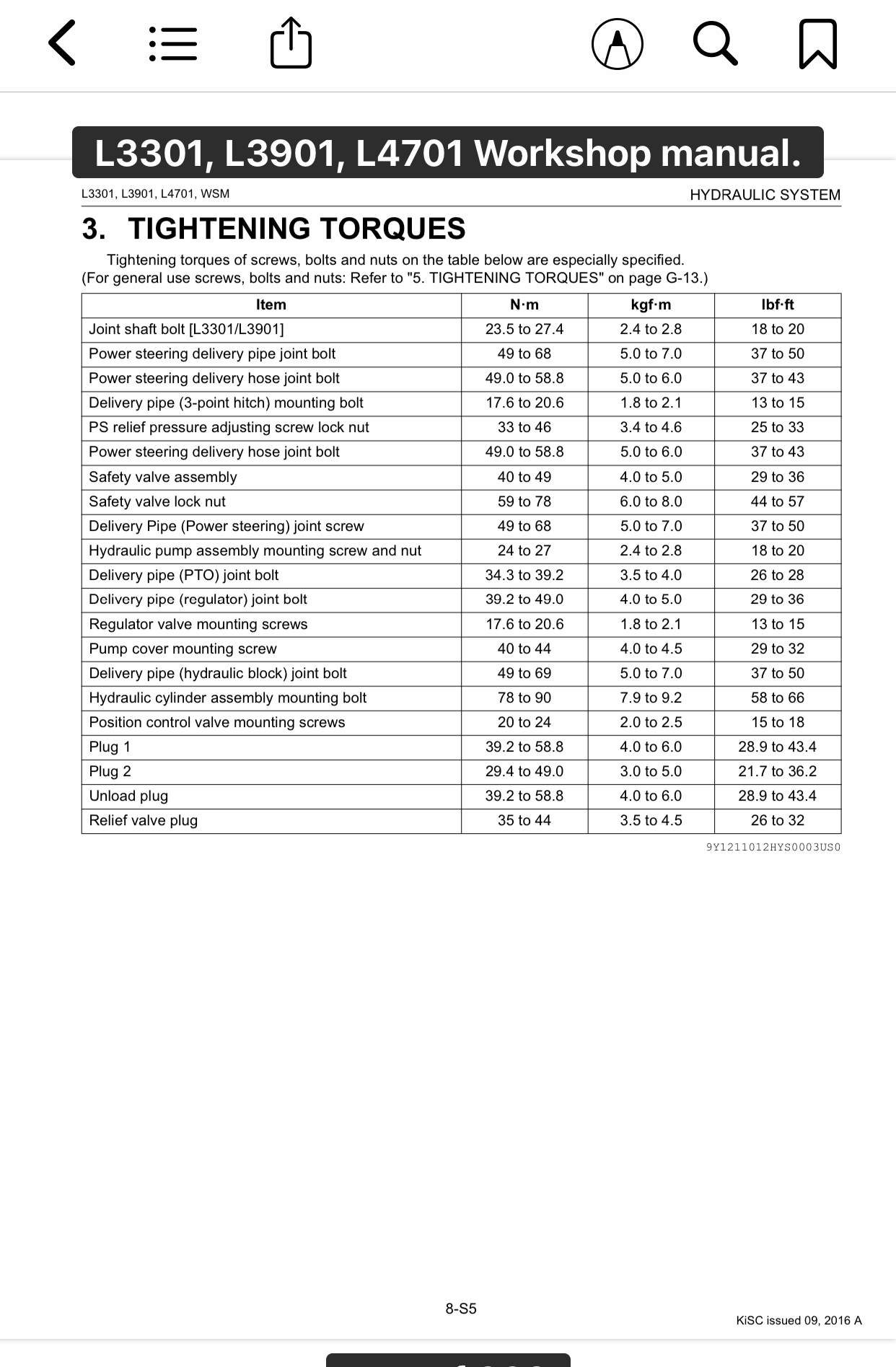

Thanks for all the quick replies. The bolts have got the 7 imprinted in the head. I believe with the chart above they should be 47ft.lbs on the low end if they're aluminum. I could tell 2 of them were definitely not there. So I snugged all down a without getting out the torque wrench. Should know in a few hours if it helped.
The correct torque for the hydraulic block mounting bolts is 17.0 ft-lbs. If the bolts are snug and oil is leaking from behind the block, the o-rings need to be replaced as one is missing or damaged.
