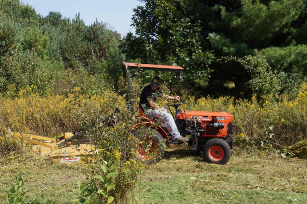

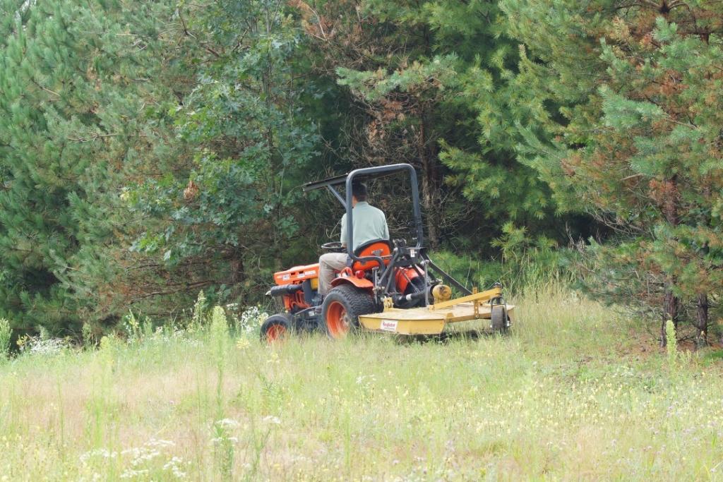

This picture shows a maintenance mowing on 5 acres that was seeded this June.
The seeding included about 25 different native wild flowers and 5 native grasses.
As you might be able to tell the brush cutter is set to about 6 to 7 inches for this session. Just cutting the tops off of weeds before they can mature and go to seed. But this gives you an idea of the light cutting that will be involved on the complete 28 acres starting next summer.

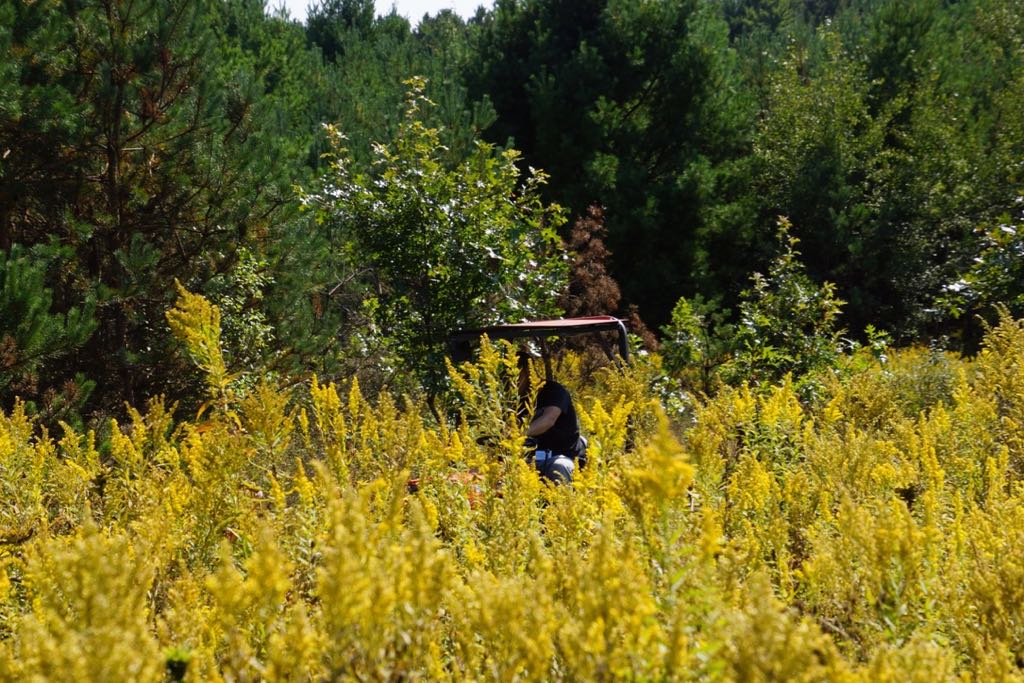

A few more pictures of my B7100 , 13 pto hp , with 4 foot cutter in thick goldenrod and grasses. Cut well but of course slowed the travel speed way down.
