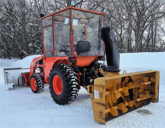

I asked you about your blower recently and a few days later a 7ft version of what you have showed up on Craigslist. If I didn't have a Land Pride SB1574 that works well for me, I would most likely be dragging another implement home.
At that price, you could afford to have it sit in the corner until needed. LOL
But I'm sure you'd first be sandblasting and giving it a fresh Kubota orange paint job. The Catepillar Yellow desn't really compliment Kubota's orange color! :LOL:
