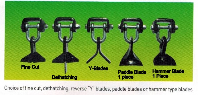

The only reason that I mentioned a flail is that they can perform both duties (finish and rough cut) and you can generally run a larger sized flail than a rotary with limited PTO HP.

A note on flail mowers: There are two main types of flails that I hear discussed on OTT, Y-shaped for cutting grass, and hammer flails for beating the pulp out of stuff. Flails "should" be swappable in my opinion, but I guess that's not always the case and some mowers take one type or the other--at least so says WoodMaxx regarding the mower I bought (as far as I understand, and since at this point I just want to pulverize stuff it doesn't so much matter). So you might need to look into what type of flails you want before you buy a mower, and if a particular flail is available and will fit a particular mower. (I also bought extra flails when I bought the mower because....rocks. So far the flails took out two rocks with only minor nicks and no imbalance on the shaft.)

Note on flail mowers, there are two main types of flails that I hear discussed on OTT: Y-shaped for cutting grass, and hammer flails for beating the pulp out of stuff. Flails "should" be swappable in my opinion, but I guess that's not always the case and some mowers take one type or the other--at least so says WoodMaxx regarding the mower I bought (as far as I understand, and since at this point I just want to pulverize stuff it doesn't so much matter).
