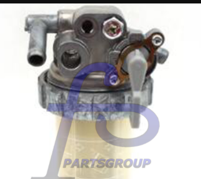

Is it like this one? Make sure if it has the pressed in elbow, that it is not loose. Seen that happen as well.
single screw version,

Thanks for the pic's and advice . I will have to check again and look better as the single screw version seems to be like mine but I did not notice the screw
