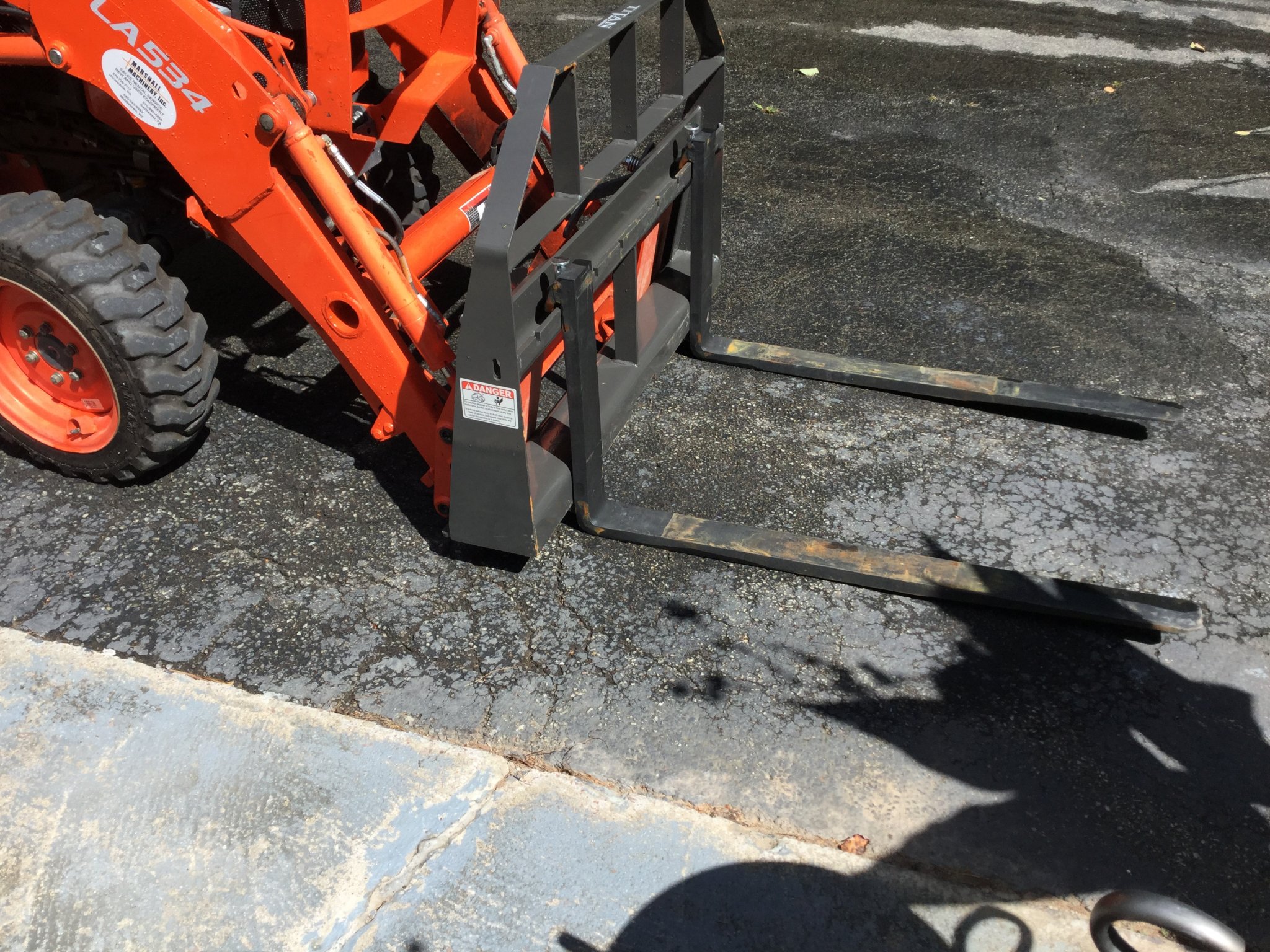

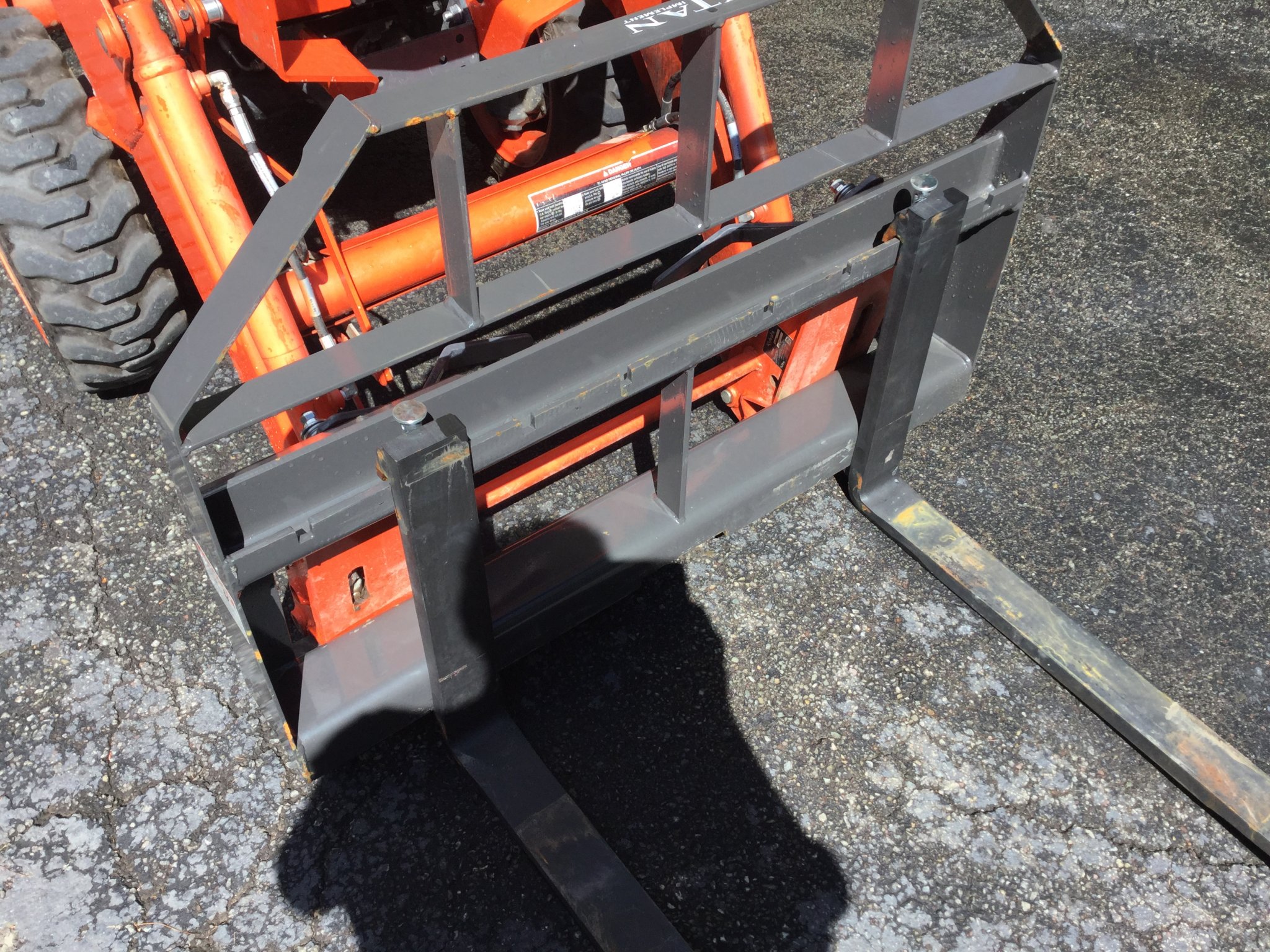

Happy
They look good
Danmorea,
Those forks look ideal for your loader, width adjustable and with a headache rack, you will amazed at just how much you use them. I recommend a couple of 6' straps, 2" wide (harbor freight or amazon) and a couple of heavy clevis shackles 3/4 / 7/8" pin, they will help you lift any attachments or similar. Good luck with them.
