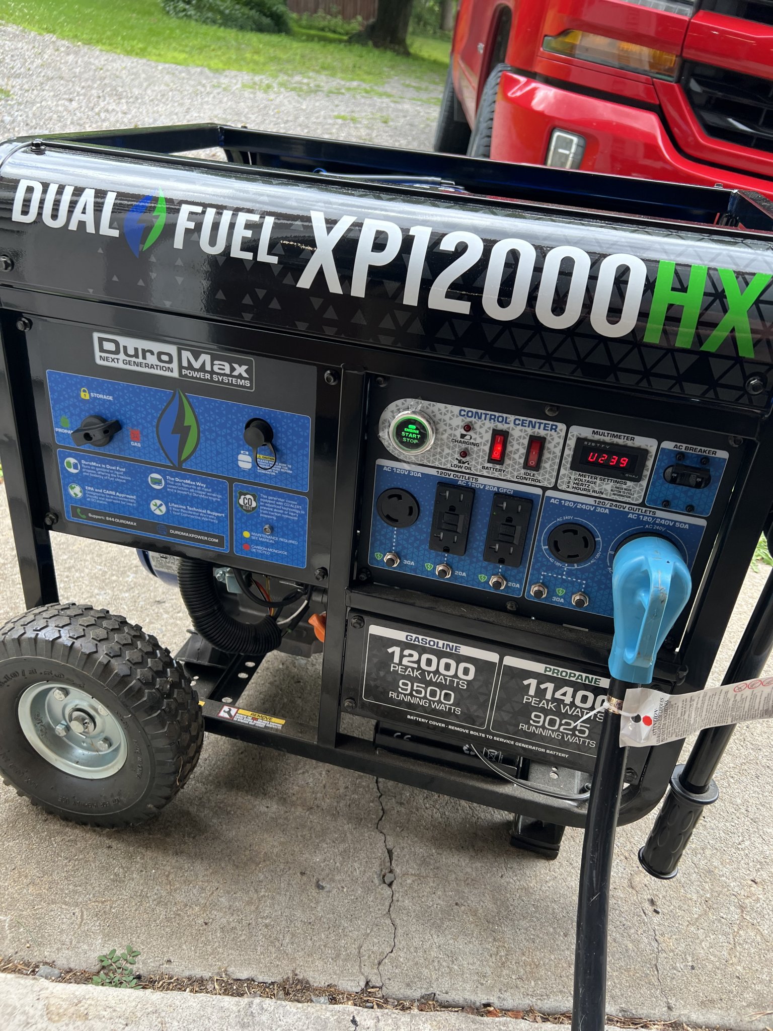

skeets- I can’t really recommend this one yet because it’s too new. It has run the house for a few hours without issues. Probably could also run the water heater if needed.
Dual fuel 12kw with 9.5kw running watts on gasoline.
This one is a floating neutral generator. That’s important if feeding a grounded panel.
It is kind of stout at almost 300 (?) pounds - not sure on weight.

6500W Honda, 8500W dual fuel DuroMax, 3750W ( Honda power ) Porter Cable, and 2800W Yamaha here..
DuroMax is a $732 low price experiment, since my 6500W Honda seems to have migrated to my youngest son's garage.
All good, ....but the DuroMax is just too recent to make a guess.
