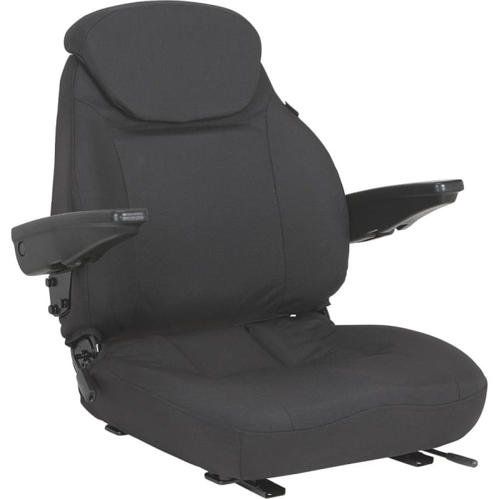

You can mount it on anything base wise because all seats made today have a standard ISO pattern.
I would opt for the rural king low profile seat suspension as well. In reality, it's a K&M low mount ISO base. Got one of those with my seat when I ordered it. The seat on my OS9 was bent sideways, It went in the garbage.

Gorgeous seat. If they offered it covered in heavy vinyl, I'd grab one to replace the OEM seat.

Thanks, I have the OEM flip seat, so I may need to make up a similar bracket to bolt the new seat to... Thanks!

Shootem604, mounting on an L245 should not be much of a problem. A little fabrication surely will be required. I had that seat on my B7100 for a couple of years. I now have one on my L4240. Both required more than just bolting on, but they are nice seats. Nice arm rest with adjustments underneath each on for preferred angle of rest.
I had to Fab up a plate to match the OME mounting holes on the hinges and to bolt the new seat on to. This allowed me to keep the Dead Man and the Rear PTO switches in operation. Overall a great and comfy seat, big up grade from the stocker seat.
They do but not for the killer price that these are being sold for.
Cordura fabric is better than the vinyl in the sun and heat. ;)
That is the fabric they use on all the awnings down there.

I have a B26 with a seat that twists to the back for the backhoe. Would this one fit? Is there a site with applications that fit?
3,394
4,878
Can't say for sure, but, I hope it does. My seat twists as well. I can let you know when it arrives. I just took the chance that it will anyway. If not, I have other stuff I plan on using it on.
If you want a rotating seat you need to buy a swivel plus the seat and most likely a base as well.
