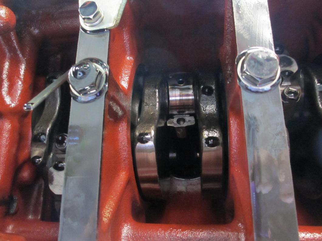

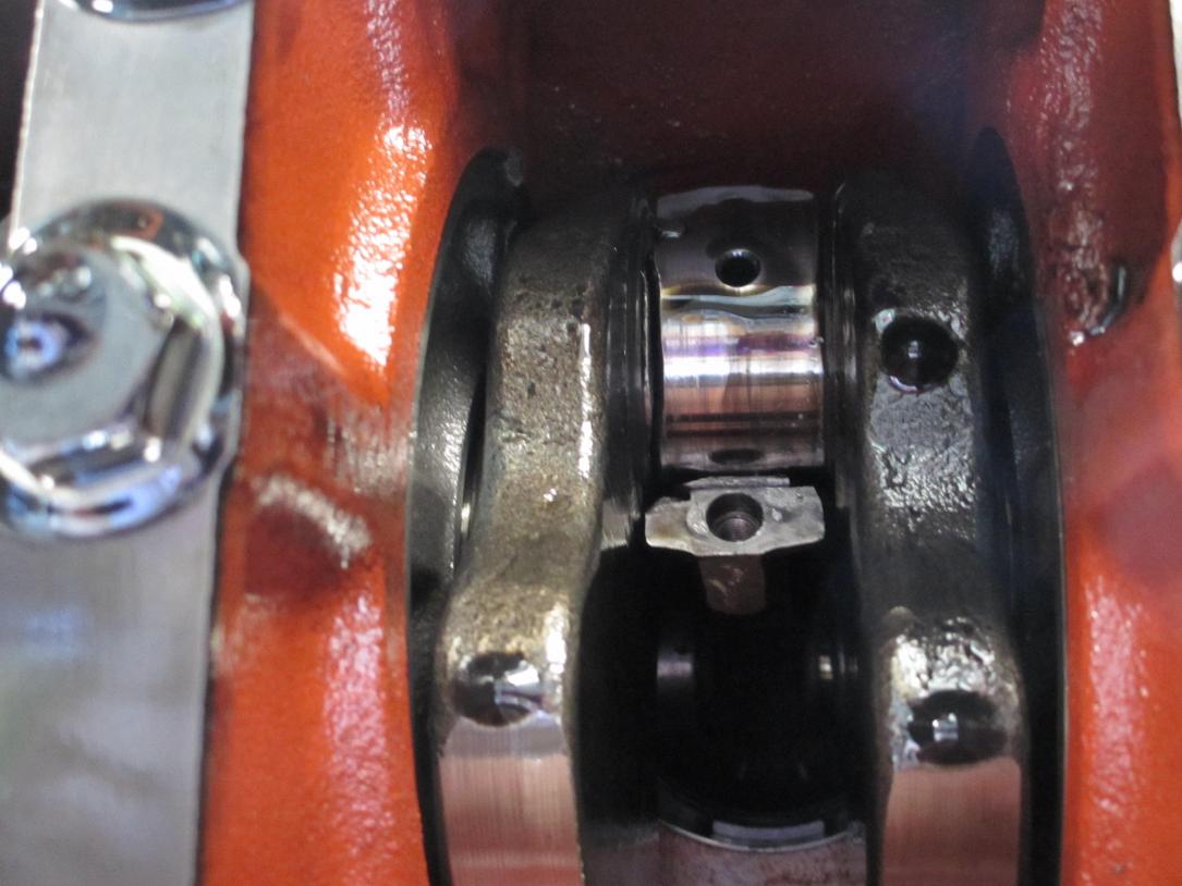

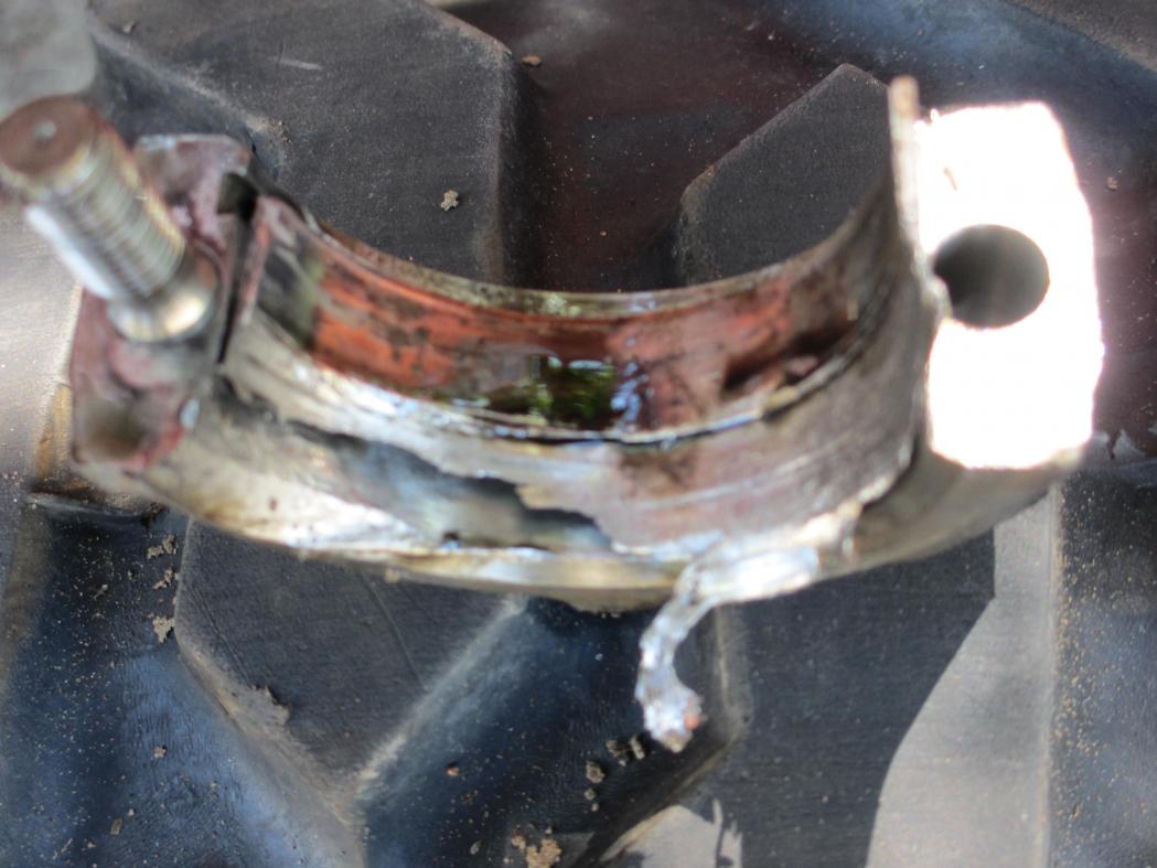

Dropped the oil pan and found the crank shaft broke on the front edge of the #2 rod journal, the rod cap was the only thing holding it together, answers the question as to why the front crank seal hemorrhaging oil during only a few seconds of craning it over now too. Now to start pricing things out knowing what I am looking for.
Here is some eye candy of the carnage I know everyone wants to see.
36,121
