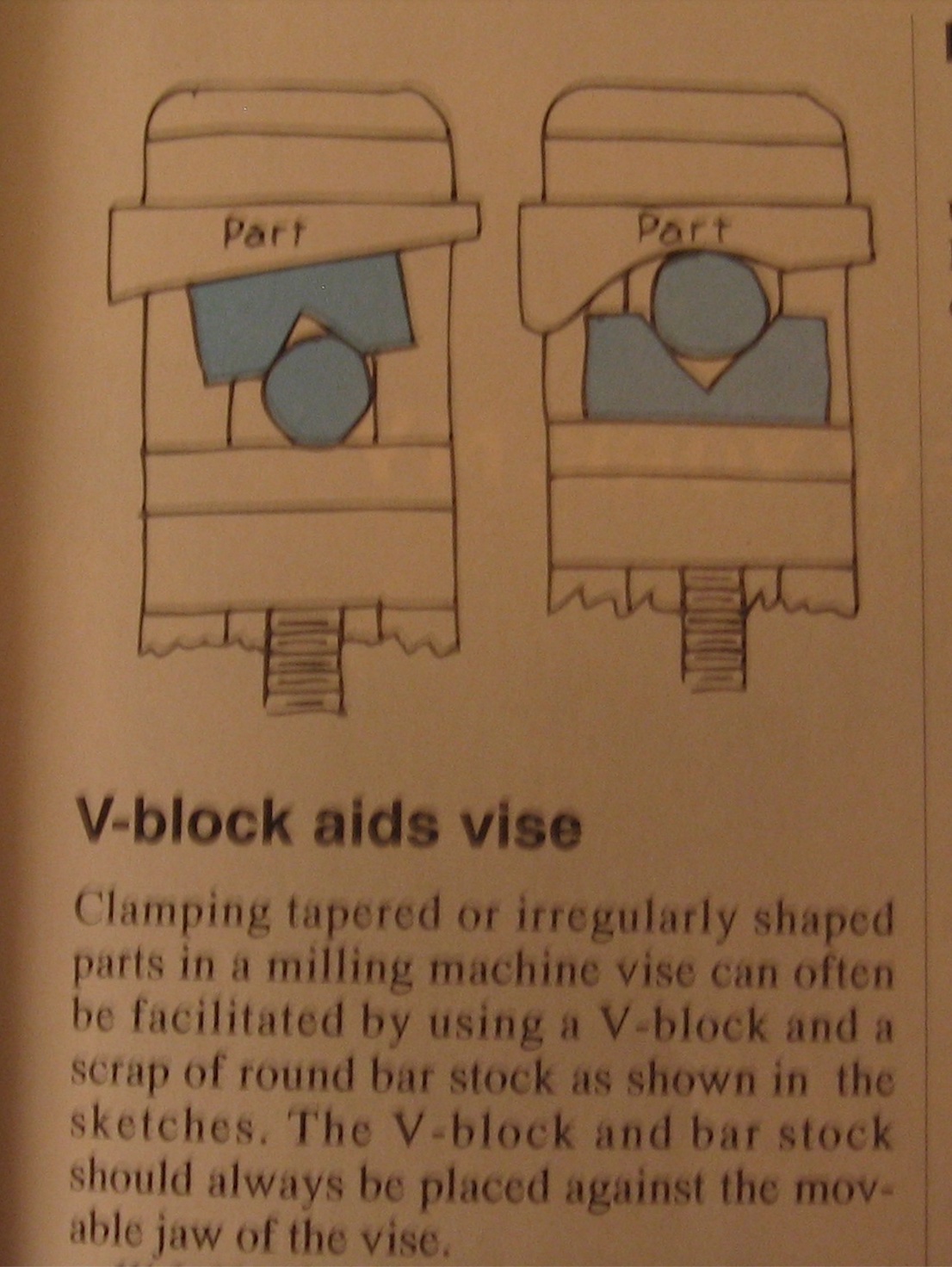

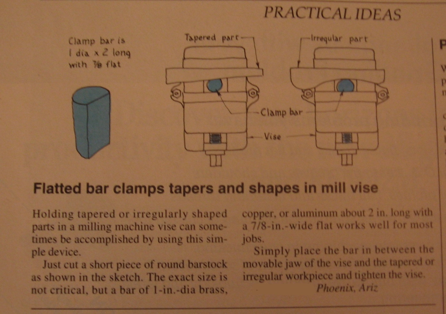

I used to be a regular contributor to the "Practical Ideas" feature of "American Machinist".
Two of my published contributions dealt with vises holding odd shaped parts, although admittedly no where near as complex or effective as a fractal vise.
