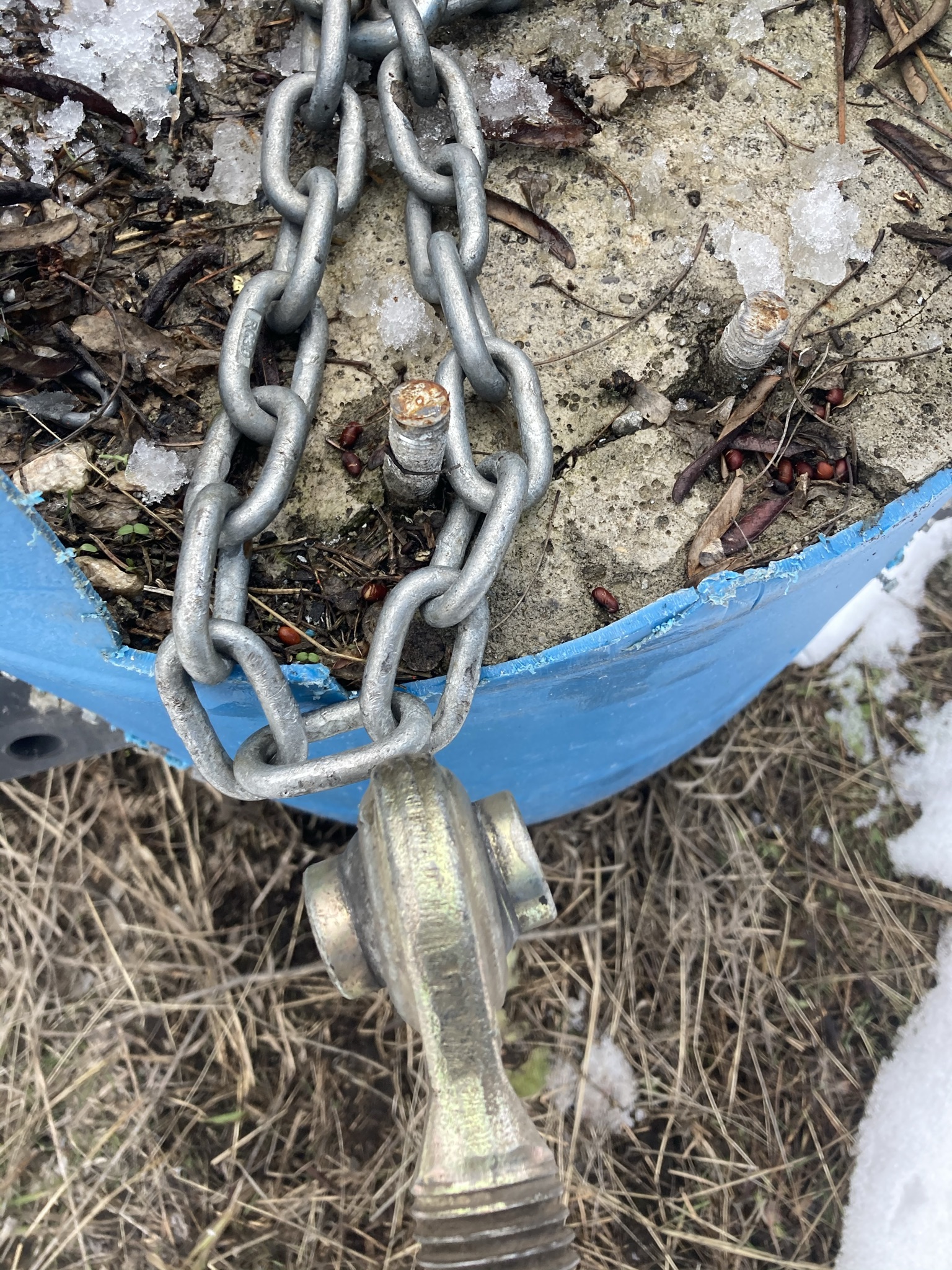

Just switched from a QH to a Pat’s system. My only issue is my homemade ballast barrel. I had a chain embedded in the barrel‘s cement looped over the top hook of the QH as a ”top link” attachment. Now with the Pat’s, I don’t have that attach point anymore. What would be acceptable ways to attach that chain to the end of my top link? Are there some kind of hooks that can attach onto the end of the top link? Shackles? It’s a 1.5” gap. Any ideas?

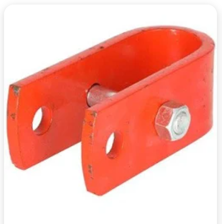

Unless I'm not understanding the problem (very possible), the OP wants to attach his top link to the top of his ballast barrel. If he has an eye sticking up couldn't something like this:
be used to connect to a conventional top link

Fastball, I'm going to throw you a curve! See ctfjr's post #8? Take a piece of metal and form a "U" like he shows and weld it to the two steel bolts/studs sticking up in the concrete. Form as needed and make sure the open end goes over the top link swivel.

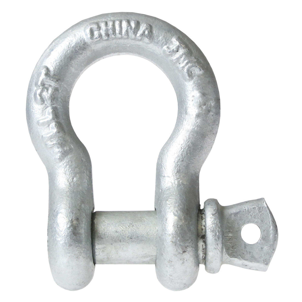

something like this?

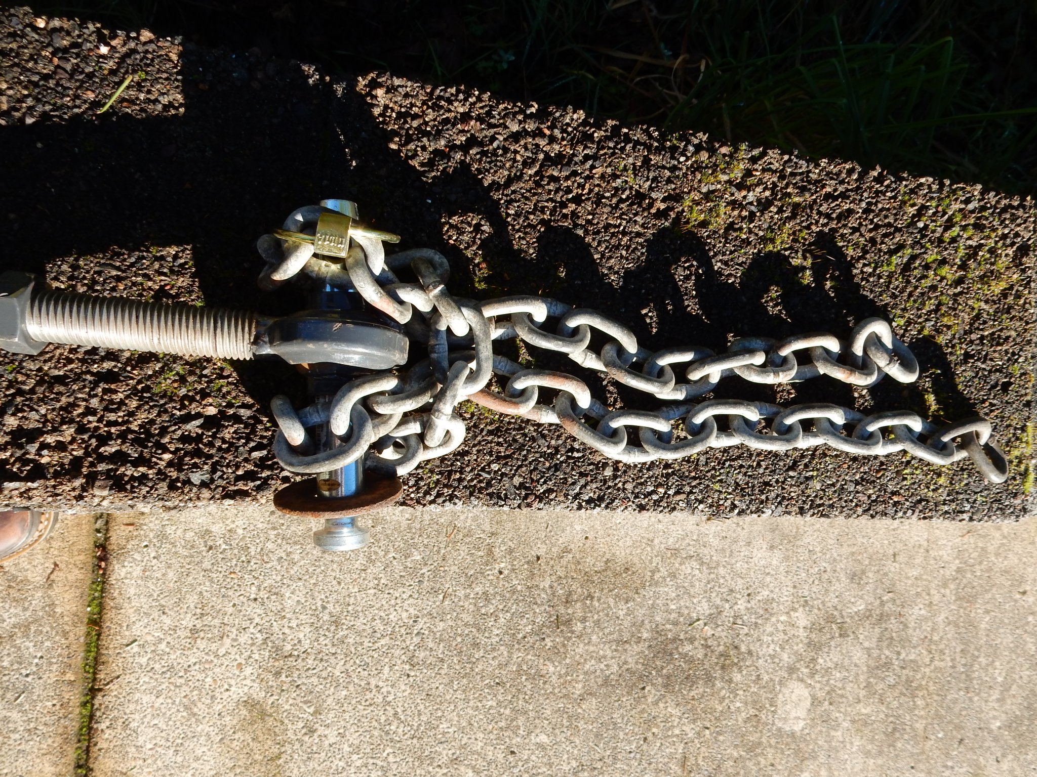

or this don't know if your chain is long enough
I could just attach that to my top link ith a 3/4” pin, and run my chain through it, hiw thick would that metal need to be? 3/16? 1/4”? It doesn't need to lift anything...merely to keep the top of the ballast barrel from swinging.

I had a QH with its rigid hook. I had a chain embedded in the concrete of the ballast barrel, and it merely looped onto the QH’s hook. All it does is prevent the barrel from swinging as it’s being picked up by the tractor’s 3-point arms. Now with the Pat’s, the rigid hook is gone and I have to use the tractor’s top link. My quandary is what to loop that chain onto now? I’m either going to try the metal loop in post #8, or try to drill some eyebolts down into the cement of the barrel and see if I can thread a toplink pin through those.

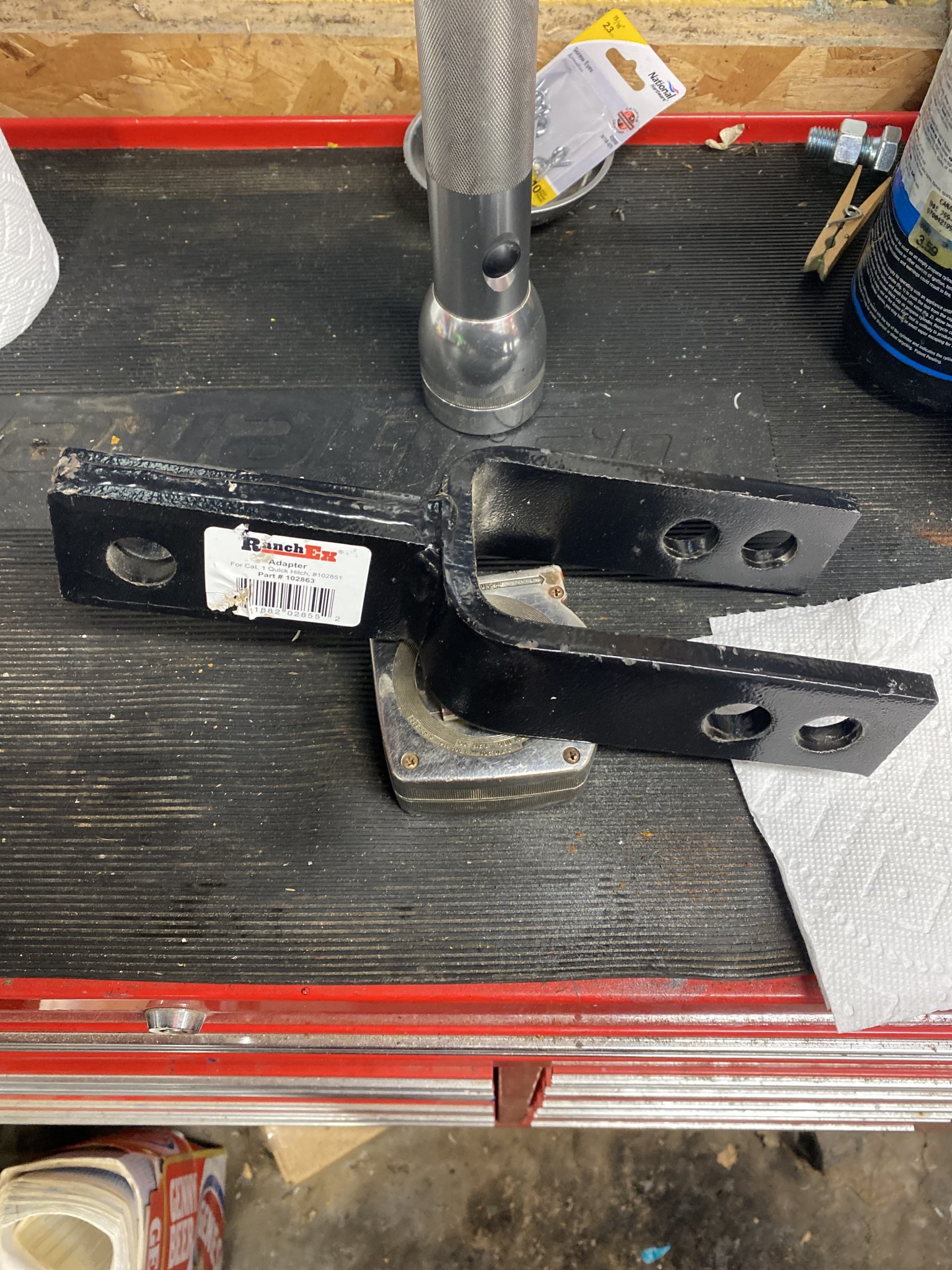

What about something like this? Still a variation of post #8.
Maybe a through bolt on the “tongue” side to fasten the chain to the adapter, then just pin the U side to the top link....
Yup, I have one of those. As you said, will have to try to find a way to shackle the chain to the hole. Or just get a skinnier chain and feed it thru....haha.
