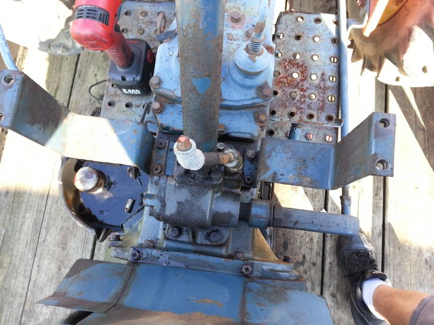

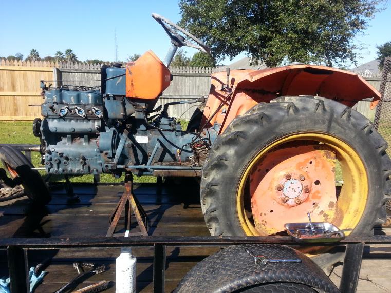

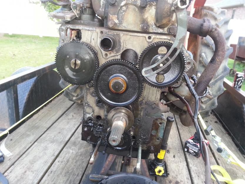

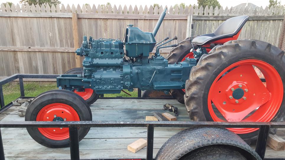

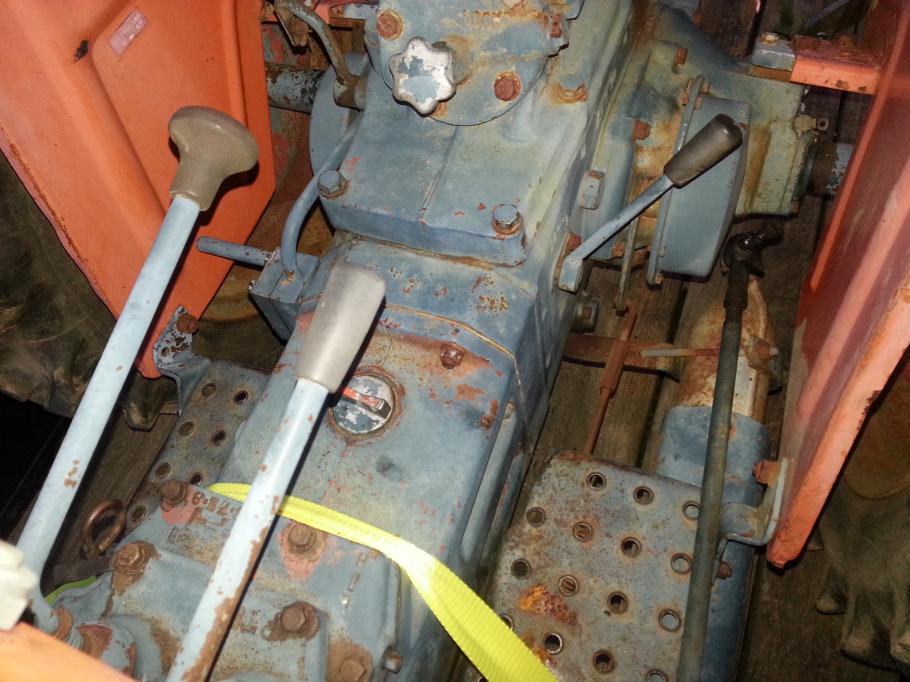

I was given a L225 from my father-in-law cuz it would not run. It had straight water in the radiator , froze, and blew the freeze plug behind the front cover. I also checked the radiator and found about a dozen pin hole leaks.
Where can I get a radiator for this thing?? Kubota wants over $550.00, aftermarket wants about 350-400 (no one can get it seems like), checked at two radiator shops and they want over $500 to recore.

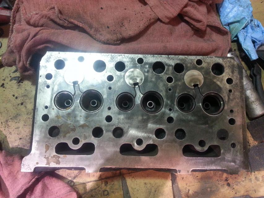

Since I didn't have any money into this L225 and I was looking for a tractor for my deer camp, I figured I should do a restoration. I now have about $2k into it with many many gaskets, seals, wheel bearings, steering overhaul,seat, New cylinder Head (cracked at valve seat) valves, and muffler. I guess I should bite the bullet and get one from Kubota . Just seems really high priced. Does anyone have a source for one?
I have some pictures. Hope it posts ok.

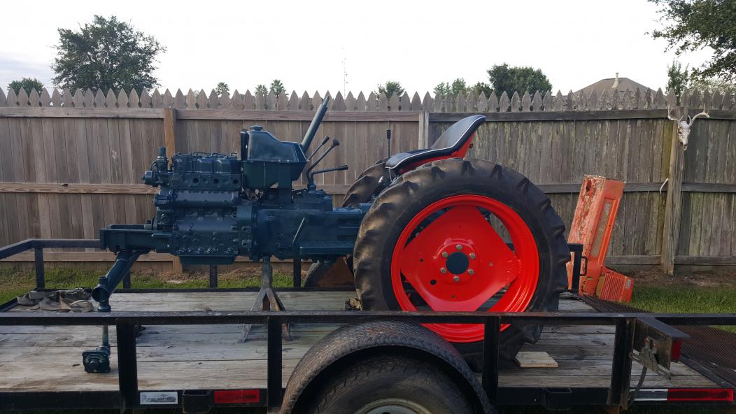

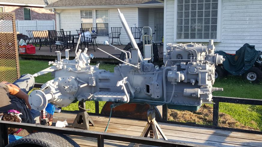

Here are a few more pics. I wetblasted the tractor, picklex 20 it, primed with a 2k primer, and used factory paint. Now I need to tackle the sheet metal. Fenders rusted through on both sides. I will have to cut and replace metal. I hate this part worse than paying $560 for a radiator

Thanks billrigby. It took several months, on the weekends. After jacking up on the rear axles, it started to leak. The axle seals were hard and brittle. Took both rear axles out and replaced all seals and bearings, and nuts. Also replaced all seals for the hydrolic lift(every o ring and seals). I still have ALL the sheat metal to do. I fear that part.
D2Cat , your 100% right. Its more than likely what I'll do. I'm just a bit nervous, but it's not like I'll be using it all the time.
