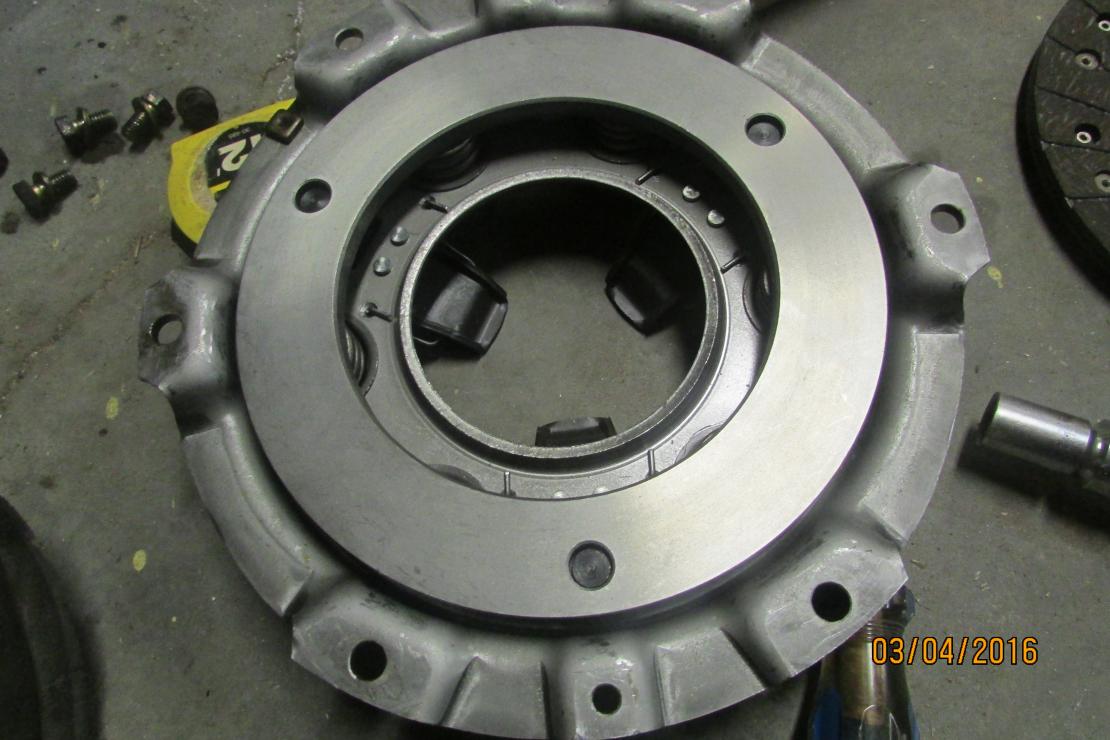

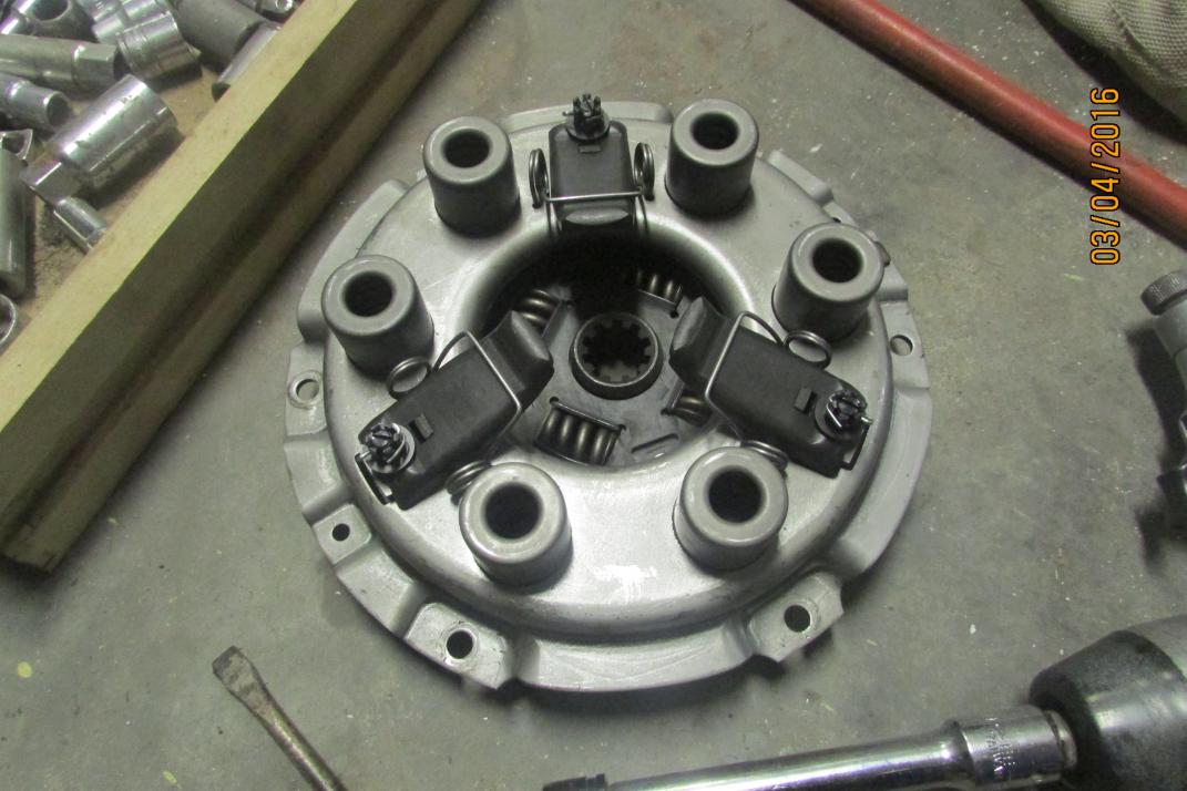

If you post a picture of the clutch disk and the pressure plate we should be able to confirm that. ;)

Here are some pictures, and thanks for your help. Well, my camera shoots too large of pictures, so I will try to find a camera that shoots small ones, sorry.
