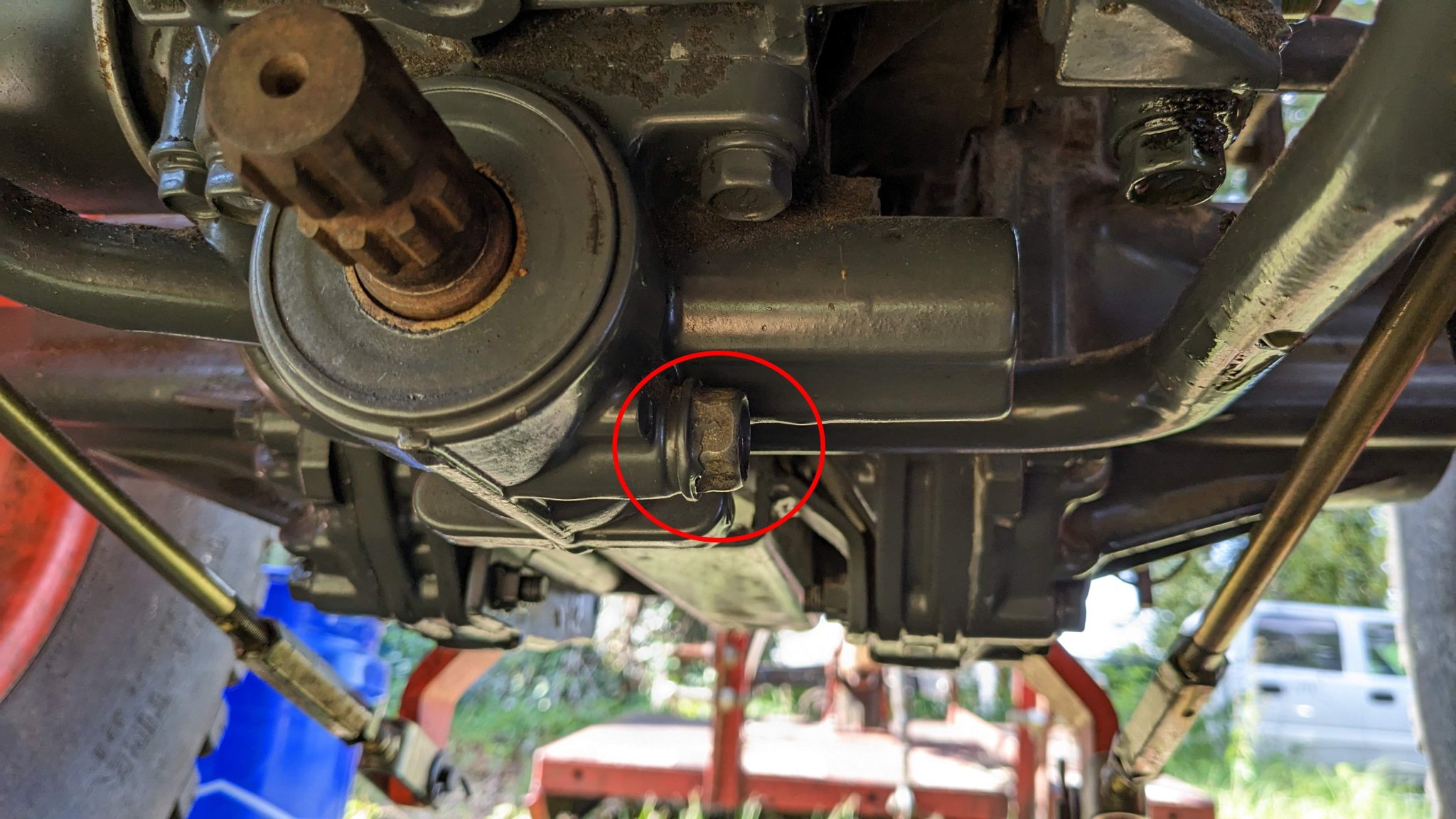

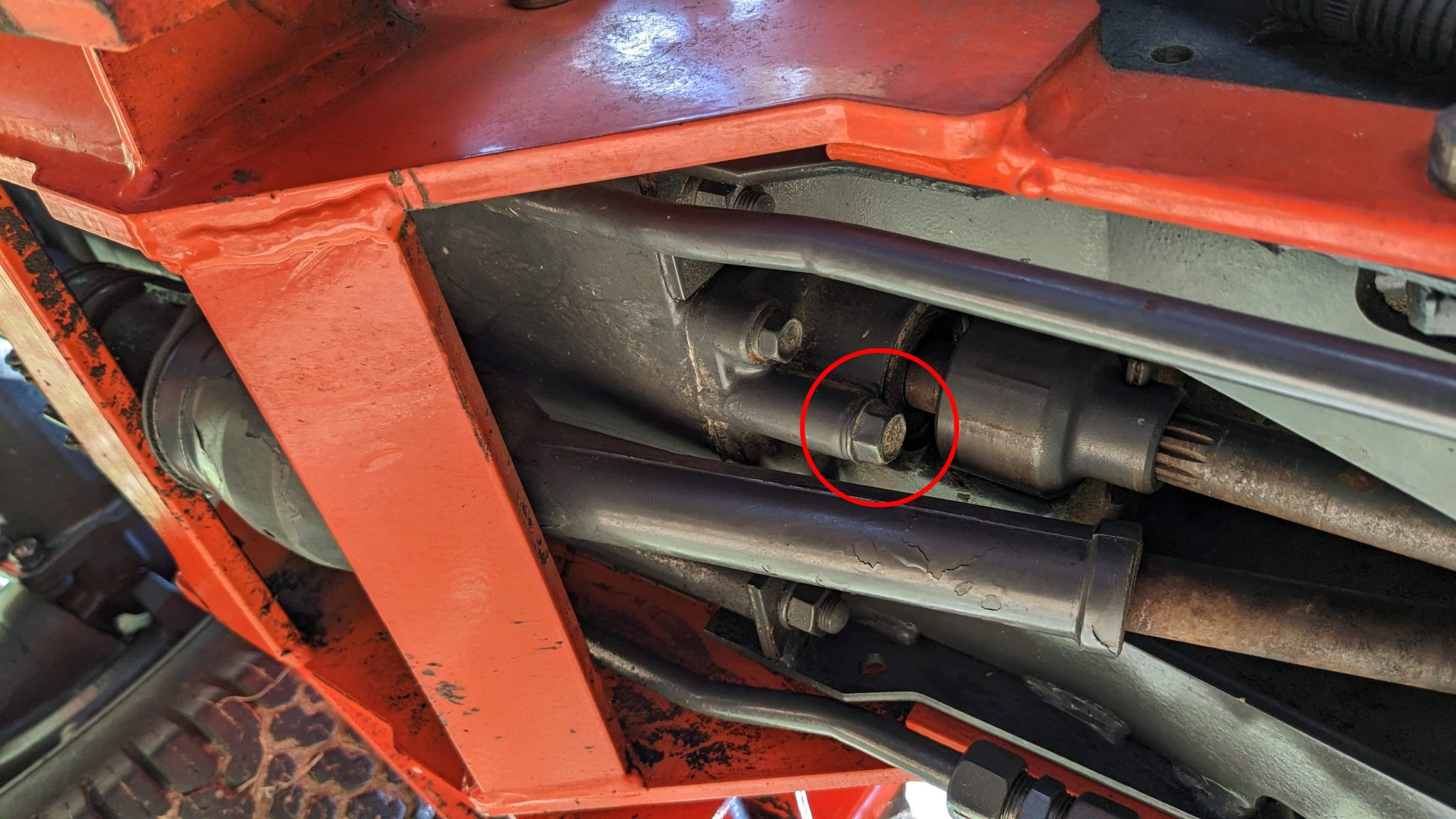

Hi all, I'm working on a 2005 B7610 for the first time in a semi-serious way and am having trouble with the info in the manual vs the info online. The manual indicates there are 2 drain plugs (beside each rear wheel) but many others refer to either 3 or even 4 plugs. I've located what seems to be 2 additional drain plugs but I'm not sure if they are - and if they are, where do I refill the fluid that drains out? Does the fluid from the trans flow all over the place? Or are there other fill points?

I’m not familiar with your tractor at all but the first picture. you posted is not where I would think the drain plugs would be. But the plugs are normally hex heads like a bolt and will have a sealing washer underneath the head and the plug head may have a flange.
If the second picture is the mid pto I think that is a drain plug.
there should be a similar drain plug on the tractor case where the shaft goes into the case from the rear wheel.

Your first picture shows the drain plug for what Kubota refers to as the front transmission, When I drain my B7500 I do not get much out of this drain plug. Yout second picture shows the drain plug on the bottom of the transmission/diferential case. Most of the fluid will come out of this drain plug. Ther are 2 more drain plugs, one on each of the final drive cases {where each rear axel comes out}.
The first picture shows the Clutch Gearbox drain plug and the second picture shows the transmission drain plug. Both plugs must be removed along with the 2 final drive drain plugs to fully drain the system.
To refill the system, you pour the hydraulic oil in through the fill port at the rear of the tractor. The oil will run through a tube between the transmission and the clutch gearbox. Run the engine for several minutes, shut off the tractor, and recheck the hydraulic oil level.

Yes both points you show are drains, along with the two on the rear axles.
All fluid is shared in that model except for the front drive.

Thank you all very much, that's good to know. I took those two other drain plugs out and very little of the fluid must have been left, after I removed the two that were mentioned in the operator's manual, but there is definitely some left in there. I've read others indicating it would be good to leave the plugs out to let the draining continue so I've done that and it's got a steady drip going on.
