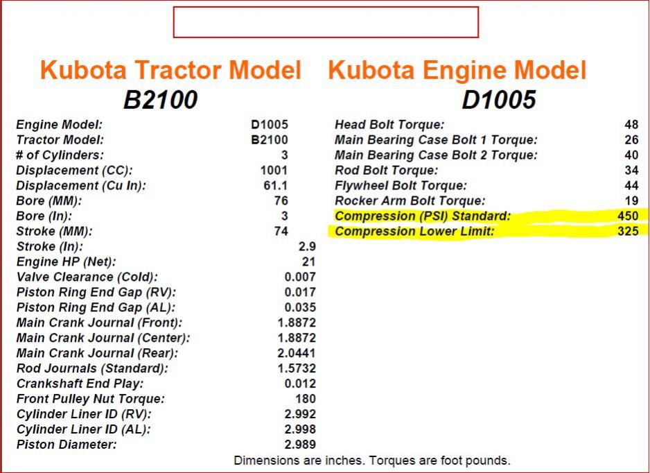

well finally got a compression tester.. #1 cylinder 190 psi. sprayed wd 40 into intake and it climbed up to around 210 psi.. #2 cylinder was about the same and # 3 cylinder was around 270 psi

I'm betting it's got low compression.

Pull the valve cover a check for tight valves.
Other wise I'm sorry but your looking like your in for a motor rebuild. :(
