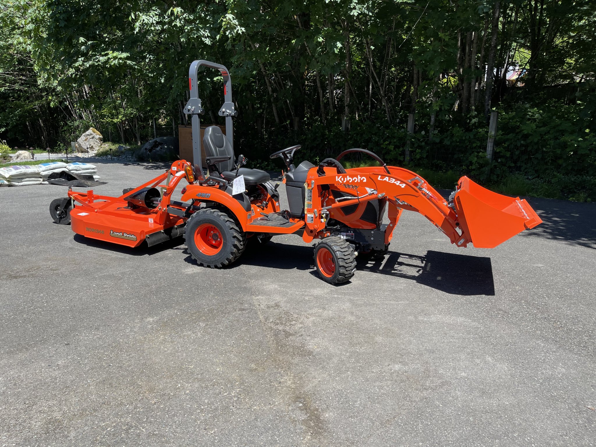

Hello folks,
I admit that I AM new to tractors, so I have some questions for those with way more experience.
First off I own a BX2680, quick mount bucket, grapple. brush cutter ...stuff. Live in some hilly property.
First, what are the opinions on bucket "edge tamers"? With the quick mount bucket ... it seems to have a fair amount of play in it and digs in when I don't want it to. Also .. is this possibly an adjustment on the mounts that I haven't figured out?
Secondly - Wheel spacers, I'm thinking some wheel spacers will help improve stability and the sense of stability that's not there with the narrow foot print. If this is a solution I should consider, how much space should I aim for?
Thank you for any information and guidance.

The edge tamers will help keep it from digging in. That can be a double-edged sword, sometimes you WANT the bucket to dig. Not sure how easy they are to install/remove.
Not a huge fan of spacers, they put a lot of stress on axles and axle bearings.
Technique is more effective:
1. Go straight up and down steep places, avoid driving across slopes if at all possible.
2. Carry loads, whether front or rear, as low as possible. Keep the loader low even if it's empty.
3. Rear ballast for loader work is important. A ballast box is ideal, but ANYTHING is better than nothing. The further from the rear tires it is, the more effective it is, but it's also more likely to hit things and it's harder on the hydraulics. If using an implement as ballast, see #2.
4. Go slow, especially as you're getting used to using a tractor.

Hey Timoth, welcome aboard! Nice set up you got there, I have grapple envy.
Your rotary cutter is just over 400 lbs. so it should do until you get a ballast box. As mentioned above keep it low (back wheel on the ground). It may tail drag or hang up if you have sharp dips and hills.
A ballast box would be more maneuverable and you can add or subtract weight as needed.
You could also get your back tires filled, adds stability AND weight for FEL work.

I'm not sure what you mean by "With the quick mount bucket ... it seems to have a fair amount of play in it".
The two locking arms should be fully engaged in the bottom slots of the bucket and there should be no play or gap. Is the bucket sitting flat against the SSQA? Are the loader arms bolted securely to the tractor frame, check the bolts.

Welcome to the orange crush. Nice Kubota you have there!
If I were you i would gain experience with the bucket before throwing money at it. There's a good chance that with a few hours experience you'll be pulling off the bucket tamers and they'll be paper weights to you.
There shouldn't be too much slop in the bucket attachment. Post a picture of your quick attach to bucket mounts if you can. And the experienced guys on here might see an issue with it.
Hilly terrain can be scary, even for experienced operators. To add to what others have said:
Just remember; Travel straight up the hill, and straight down. Front of the tractor facing uphill - if you can. There aren't brakes on the front axle, so have it in 4WD always on hills. The only braking action to the front axle is thru the drivetrain and ONLY in 4WD.
Go (DON"T) downhill with a load in your bucket in 2WD and you might mess your pants. Most of us have done it once, most live to tell about it. If that happens drop the bucket to the ground immediately, (Slam the loader stick full forward), you might actually be able to stop before crashing into your pickup truck at the bottom of the hill. Or worse.
& Wheel spacers are not a bad idea.

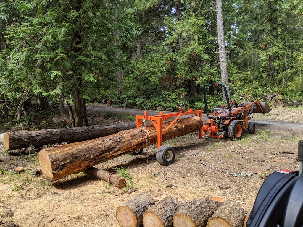

I'll chime in as well; I use our little B5100 on our hilly property to move logs, gravel, etc. I'll repeat:
  • Go slow, esp. going down hills or when carrying things in the loader. You don't want to drop a wheel into a hole and launch the rig over.
  • Turning on a hill with a load in the bucket can be a terrifying experience; keep that load LOW.
  • You should be close to maxed out on your 3pt hitch if you're maxing out the bucket weight-wise. Too much weight on the front wheels is not a good thing.
  • A box blade makes a nice counterweight; you can hang suitcase weights on the box if you need more weight.
Oblig photo of dubious tractor shenanigans: moving cedar logs w/ a home built log arch.

I was in conversation with McMXI about my purchasing an MX 6000 to assist with my log cabin project. One issue we discussed was my wanting to know about pulling a Berkelman tandem lil 3 ton flat bed dump on a QHitch as it reached out further that the drawbar. The spec math look ok but no real info on the lower cat 2 lower links connected to a QH tow bar with pulling 9000lbs. I found out in the print the some QH tow bars say up to 3700lbs pound trailers only no additional load. What man does not push his equipment as you demonstrated. I love it! Nice log jockey by the way!
I found out from discussions with veteran tractor guys and said if I extended a long drawbar to extend past a QH used just for implementations with out a lower tow bar onto a heavy load it can be sloppy and dangerous turn on hills. Longer bars are ok for Improving flat field implements turning radius and don’t advise pulling heavy loads with extended drawbar .
My question to you, is how is that load to maneuver on say flat area. Did you pull that tree out with that tractor assembly?
Joe
I try to balance the load as best I can; clearly here it wasn't that great. These logs had been left in a big pile along with fir logs too twisted to mill into siding. I spent some time cleaning that up; the B5100 didn't have enough pull to disassemble the pile, but my 4x4 F250 managed with a long chain and a front hitch.. Once the fir logs had been converted to rounds and moved elsewhere using the trailer my son and I built for the tractor, I could snake the log arch in and pick up the cedar logs. I then milled them w/ an Alaska mill (chain saw accessory) w/ a ripping chain into rough cut 2"x14" slabs; my wife used these to make a series of raised beds next the house protected by deer fencing.
Once the log is balanced preferably nose heavy on the arch, the tractor will move it ok. Obvious not a rig for side hills; I built the log arch to fit in the woods, but it's a bit long as it takes 14' logs.
We now have a 7000 lb JD 110 TLB which could have picked up this log w/ the pallet forks... but not gotten it into the right place. My brother and I have some logging coming up on the land we inherited from our parents; a bunch of dead firs that need to come down. We do need to wait until the ground firms up; we've had a wet spring here in the San Juan Islands.
