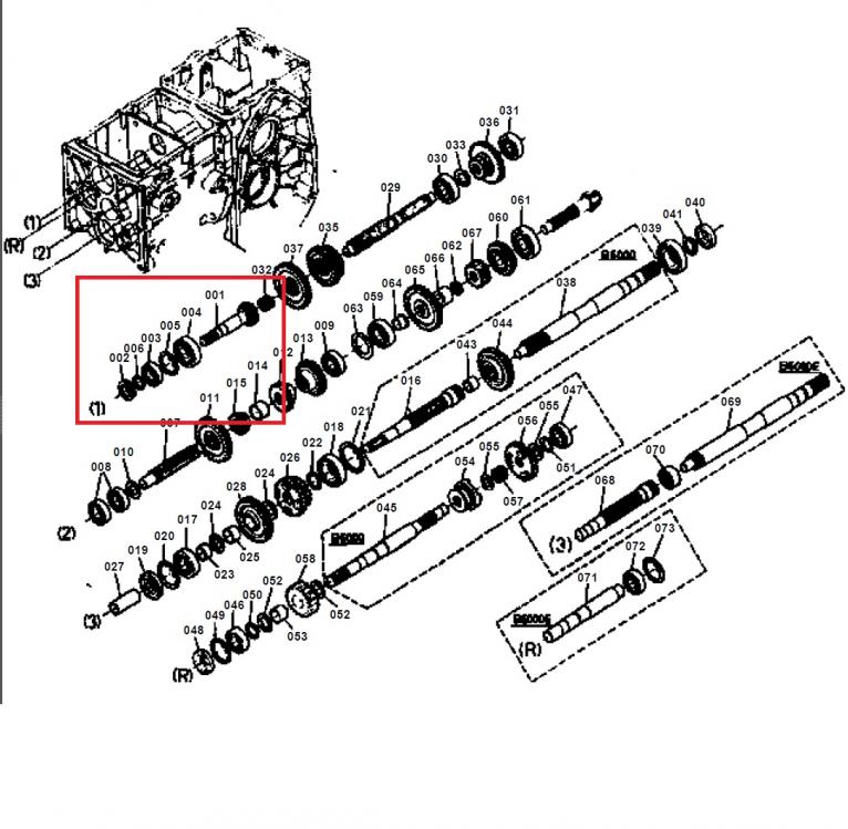

b4 I can take a picture, this is from the parts manual. The first shaft is enclosed in red. The parts from left to right are: oil seal, clip, bearing, clip, bearing, 1st shaft and needle bearing. The cover holds these except the needle bearing. One concern of using a gear puller is that the clips may be bent?

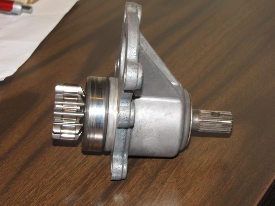

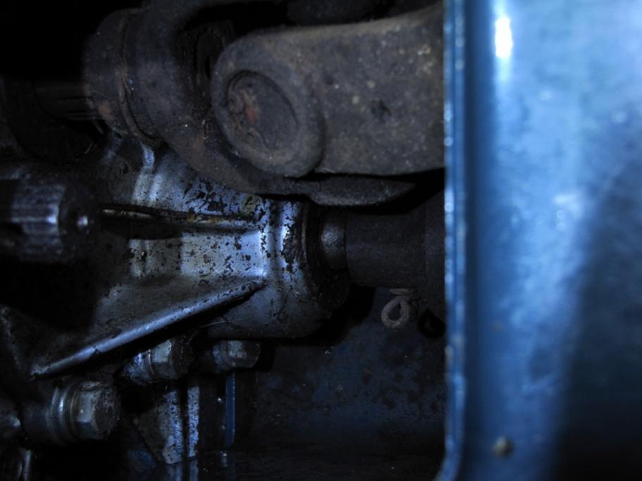

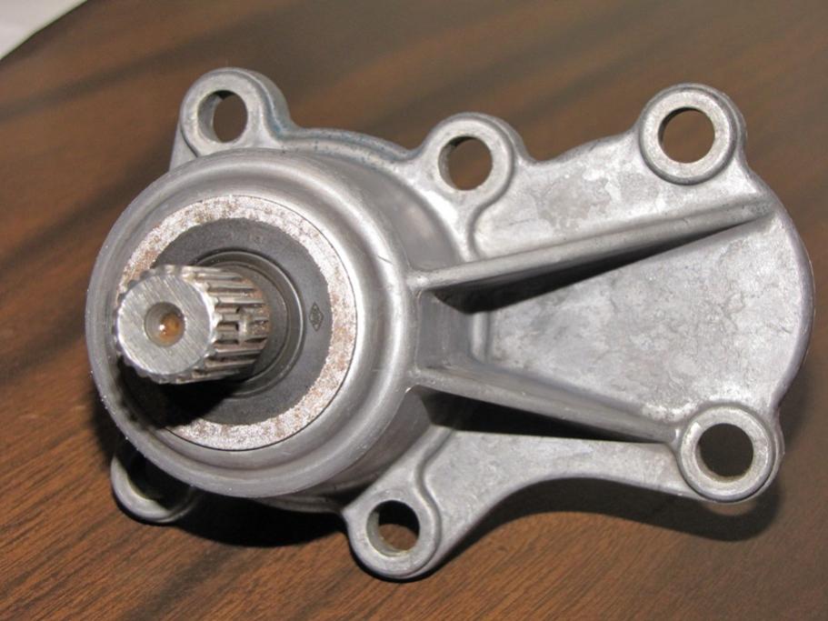

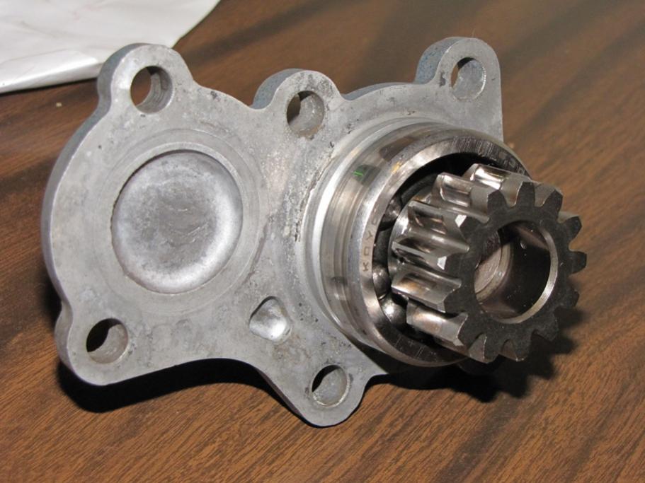

Here are the pictures. The assembly goes onto the front of the transmission case. The spline connects to the propeller shaft from the engine. The gear connects to the third shaft?
By looking at the parts diagram, I would think it should just slide out. You can see there are quite a few balls missing in the outside bearing which I need to replace. I tried to pry out the bearing too that didn't work either.
The last picture shows how it was installed on the transmission.

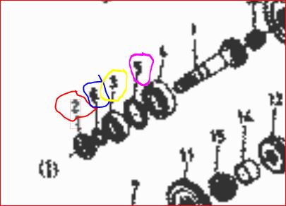

Got it, You need to remove the seal #2 (red) on the splined side of #1
Behind the seal is cir clip ext #6 (blue) remove it.
Shaft #1 and Bearing # 4 will come out the back, look inside and remove Cir Clip int. #5(purple) then remove bearing #3(yellow) out of the back.

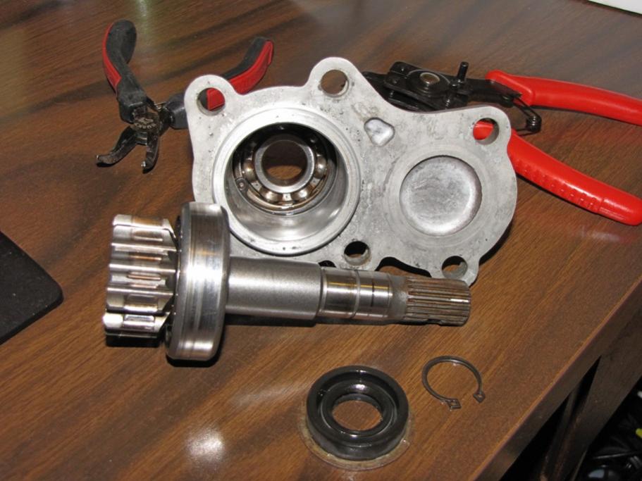

Thank you Wolfman! It never occurred to me that a cir clip could be reached through the oil seal opening. It comes apart literally in a few minutes after I got your instructions. Here is the picture in case someone else may need the info later.
The bad bearing still would not budge due to rust? I am putting on some WD-40 and later a gear puller should get the job done.
Thank you again Wolfman and everybody!
