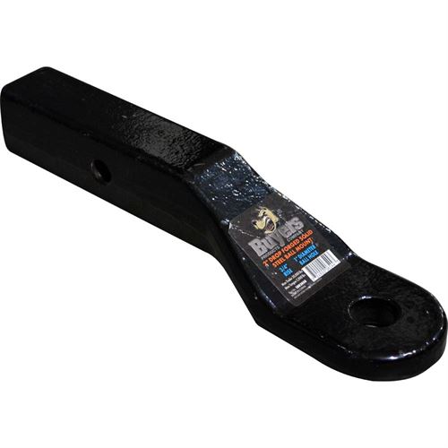

I bought my receiver/hitch from Agri Supply. Went with the 2 inch receiver that's rated for 20,000 lbs and 2,000 lbs tongue weight. I put the 2 5/16th ball on it that is rated for 15,000 lbs. The whole setup was less than $40. Solid. I have 0 worries when towing with this setup. I tow just over 10k when you add tractor, trailer and bush hog. I honestly don't even know I'm towing anything it tows so smoothly.
Here is a link to Agri Supply. They are an awesome company with great products.
http://www.agrisupply.com/ball-mount-solid-drop-hole-lb/p/32376/
