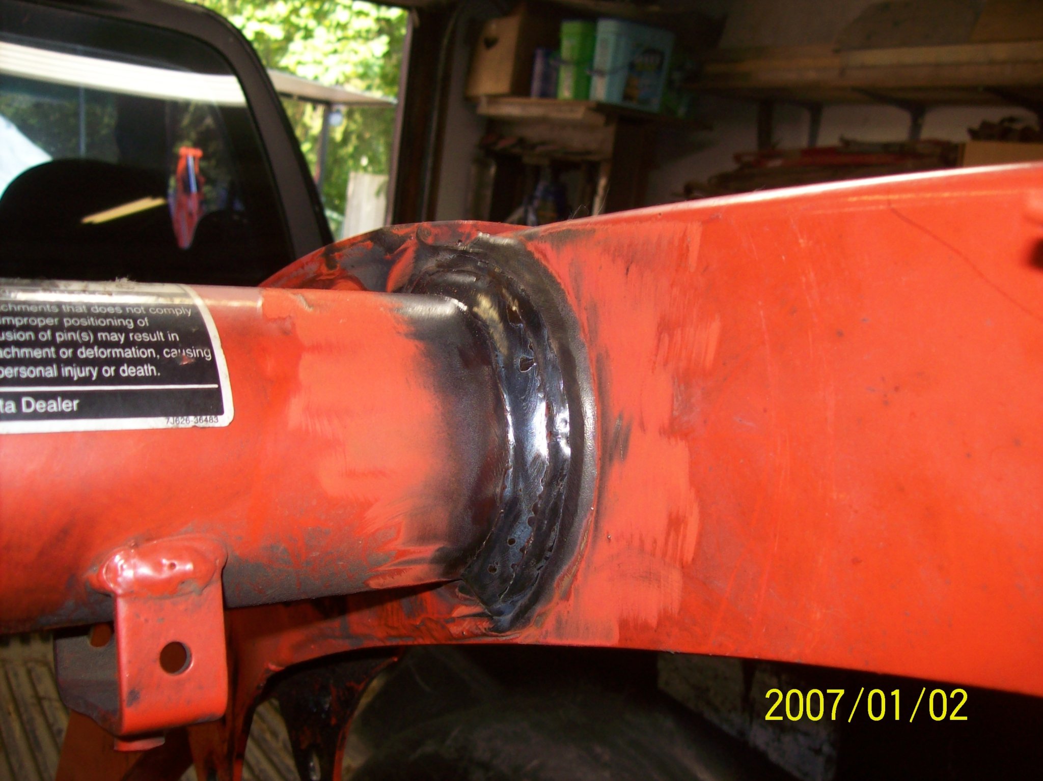

Well the good news is I've moved 2-3 tandem loads of dirt over the past 2 days, ZERO issues. Would have moved more but Mother Nature decided to 'cry' BIG time !
I know the new welds will outlive me.
Sad thing is Kubota wanted close to $3000 CDN for the 2 arms and tube naked 'assembly' !! That's about 15% of what I paid for the WHOLE tractor, 5 years ago.yeesh....

booboo repaired !!!
Neighbour fixed BOTH sides BEFORE I took SSQA frame over for 'aligning' the arms ! His work table is a 6 by 10 slab of steel 4" thick, precision ground flat and true. So as of noon, 'Humpty Dumpty' is back into service and NO 'extra' parts on the work bench. I'd thought I'd get it back Saturday afternoon so super happy now that I can go play......
He said it was a bad weld from the factory and since he has a wall full of welding 'tickets', I believe him.
Both sides, good.

That is cold lapping. Not enough heat and too fast on the travel. Mig looks easy, but can be screwed up just as easily.
