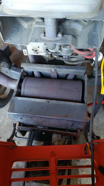

Started it up, and about a cup of coolant poured out from the front of the muffler. I'm completely at a loss as to where it came from. The only wet spots I found were directly underneath the muffler, and looking with a mirror I can't see any holes in the muffler that would suggest a head gasket leak, nor any obvious drips or wet spots (there are preexisting oil spots). After a couple minutes it seemed to stop dripping. This is the first subzero day, but we've had some single digits before.
Any suggestions on where to look are appreciated.

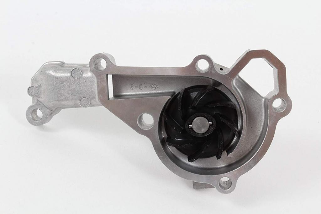

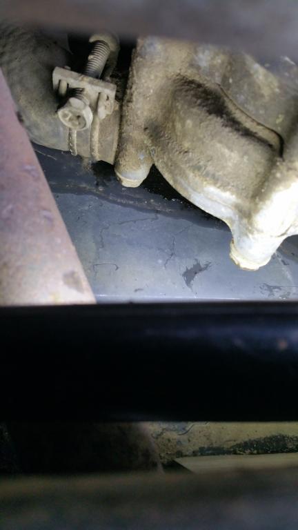

So my theory was wrong. It's not the radiator hose. I started it this morning and the same amount of coolant leaked out, and again only for a short time before it stopped. It's coming from somewhere near the water pump, although the bottom side of the pump and hose fitting are completely dry (used a mirror).
Any ideas from here? I'd like to tear it down, but I need the snowblower until winter is done. I'm still don't think it's a head gasket since the heads are on the outside, they're completely dry, it leaks from somewhere far from them, and the oil is fine.
The part baffling me is the temporary leak, as if it's draining down somewhere and then getting purged on start. But why doesn't it keep leaking?
Edit: second picture is the pump, and closest to the "source" I could find traces of water.
Edit 2: I think I found the source. The hardest to reach water pump bolt is dripping with coolant. I can't tell if it's a crack in the pump housing, or the gasket, but it's something on the block/water pump side leaking. As long as it continues to leak only a small amount on start, I'll wait until warmer weather to fix it.

For future reference of anyone having this problem, the weep hole is in the attached picture at about the 12:30 position from the impeller. The bolt to the left of it is in my other picture with the red arrow.
I decided to replace the pump sooner than later since the gear side of the water pump (drive side) goes into the crankcase/oil. I'd rather not have the seal fail completely while using it and take out the engine via contaminated oil.
