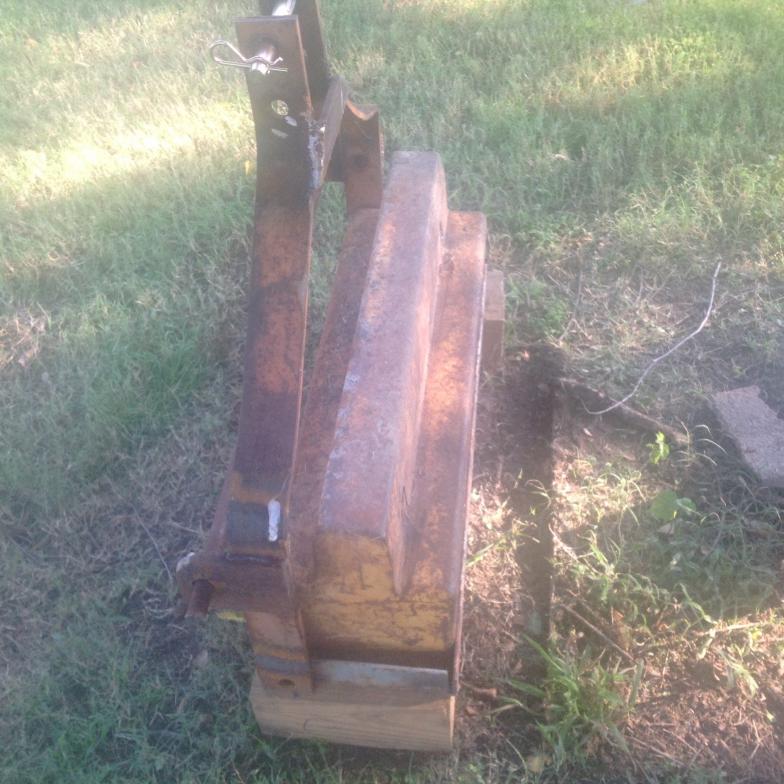

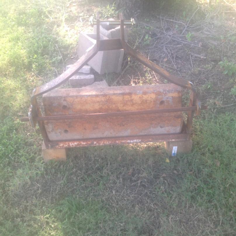

My simple ballast weight, small footprint
man00
Jul 3, 2013
197
10
okla
29" long 8.5" wide at the widest part...6" thick
the top piece is 29" long 3" wide and 4" thick...Thinking little over 500 pound?

That's a winner - small compact! Prefect;)
