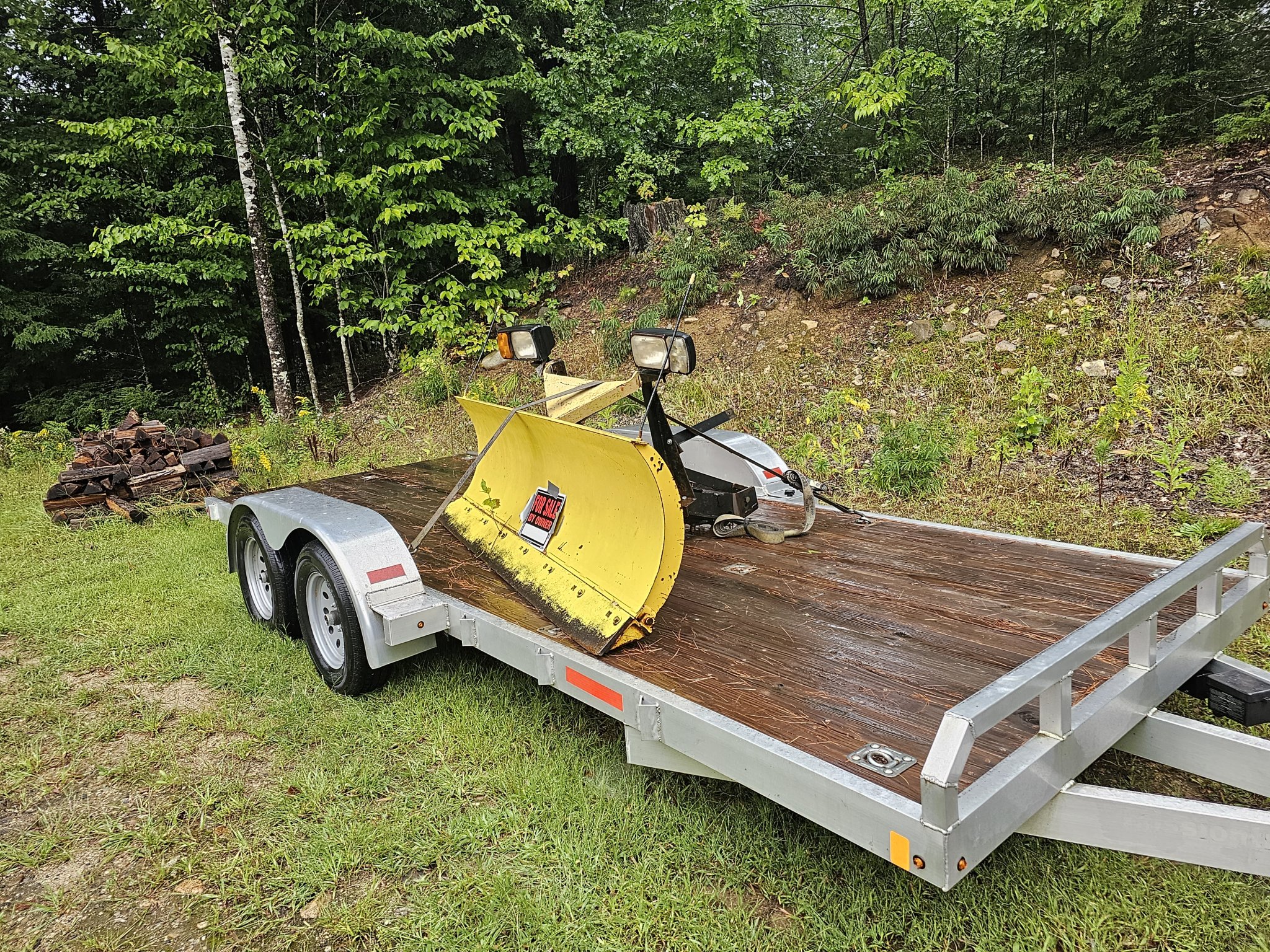

With winter looming I had been thinking of adding a plow for my tractor to push snow.
I found this plow locally from a friend/customer I had done work for in the past. He had it for sale beside the road, but wouldn't take a dime for it.
He said how many projects have you welded for me and never charged me ? It's all yours. So a good find.
I'm going to cut the head gear frame off and make two "quick connect " mounts just like the back of my kubota bucket. Quick on, quick off, ill post a photo as it progresses.

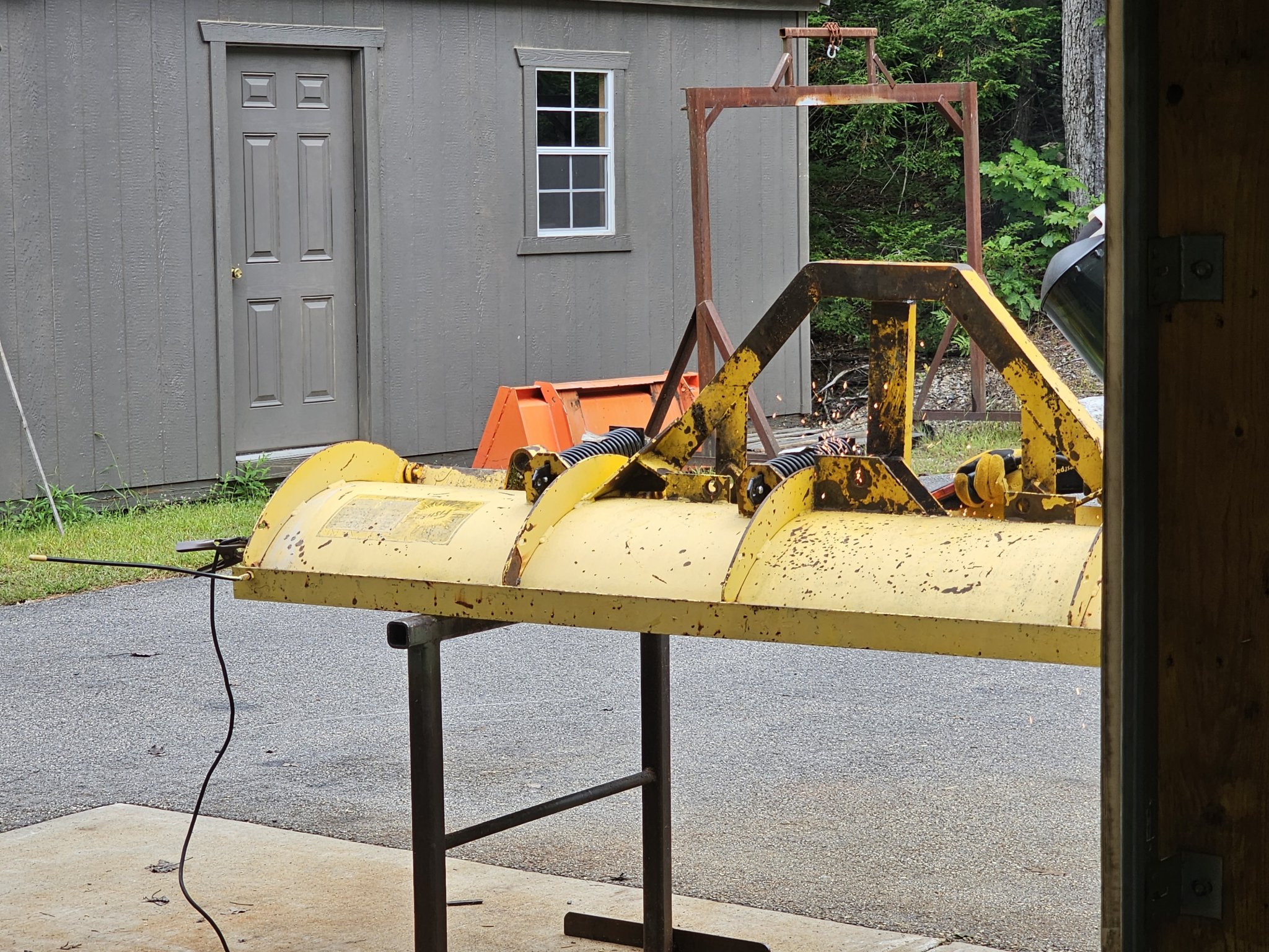

Wacked off the head gear today and order a 4x8x1/4" sheet of plate($260.)
I'm hoping for two sets of mounts. One set so the plow is centered on the tractor.
'Then' one set when the plow is angled about about 12" to the ditch side. So that set of mounts will be offset. With one mount extending off the back of the plow to angle it. It works in my head.

I put in a few hours making brackets/mounts today.
Tomorrow hope to gusset/box them in.
I'm loaded up with work so not sure I'll take the time to do the angle set of mounts. So will try it this winter straight mount.

Seeing alot of the quick hitch plows forsale online most had a pin that you pull and swivel left right or center. But having that mount pushes the plow out five feet in front of the tractor head gear mount. The only complaint you'll ever hear me mention about my L3800 is the lift capacity of 1000 lbs. Where other brands , koiti LS New Holand ect there 38 hp lift over 2000 lbs. But it is what it is as they say. That said I wanted to keep the plow(I'm guessing 500 lbs) as close to the tractor as possible because of the lift constrant. As far as the trip edge after removing two springs the edge was very very weak. I used two ratchet straps pulled it all the way up/ closed then stitched the edge in place. I figured just like my bucket which doesn't trip I just go slow and easy and never a problem. I know, call me stupid but I'm racing around at 1 mph, not 25 mph like plowing with my truck. So I did make progress this week. Finished the mounts, gave it a coat of OSPHO , let dry 24 hrs, then a good coat of rusty metal primer. Just waiting on my kubota paint from Home depot to show up. A couple coats of that. It's done.

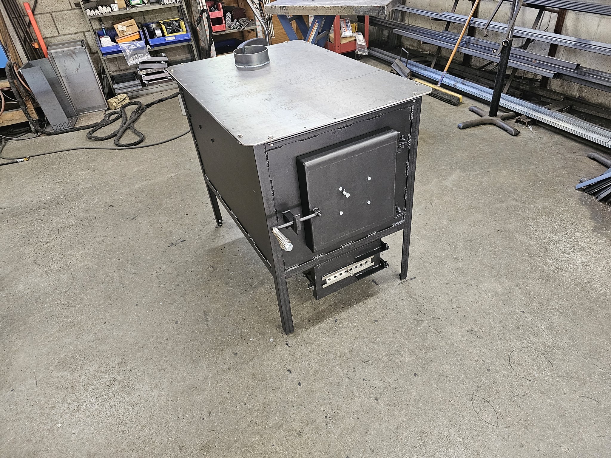

My hired man has been working on this project this week a customer ordered. He wanted to be able to use a 30" stick of firewood. It has the gasification reburn shelf with is EPA approved emissions.
Unfortunately with material costs and labor cost my profit is 0. So I under quoted it. You win some you lose some.
Tomorrow the top gets cut and bolted on then high temp paint ect.

Low emissions, the newer ones of some type of catalytic thing I believe. I was kinda joking about EPA emissions.
This one is basic, I don't make wood stoves, but this guy wanted something that would take a 30" stick. I'll make a ash pan today and my helper will finish the top and paint it...
On to the next thing.
