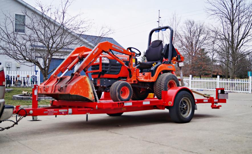

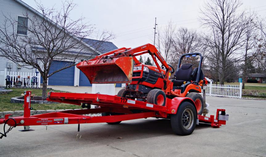

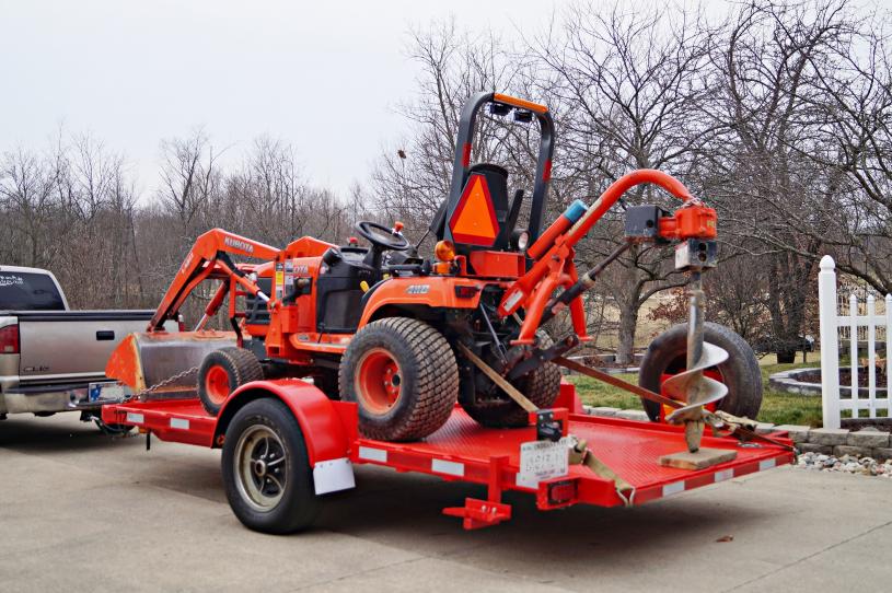

A few updated pictures of the trailer with the tractor on it. The tie down straps/chains are temporary. I am going to put mounting loops on all four corners of the tractor and make straps just the right length for the tractor.

How did the S-10 do pulling it?
Just fine. I did three ten mile test loops, unloaded, w/zero turn, and with/BX. I went up and down hills and out on four lane highway at 65MPH, and it felt solid as a rock. No porpoising, no wander, no sway, stopped fairly good even though I didn't have the brake controller installed on the truck yet (it is now). I did another couple 10 mile loops with and without the BX to dial in the empty and loaded trailer brake settings. The only "revenue" run so far was hauling the tractor on a five mile round trip at about 40MPH to drill some holes for mail box posts. Waiting for the weather to break, as I have three more installations in the neighborhood right now. You know the trailer is back there with the tractor on it, but it is smooth and doesn't fight you. I notice that the truck is in drive instead of overdrive more than anything. (No towing with a 4L60E in OD.)
