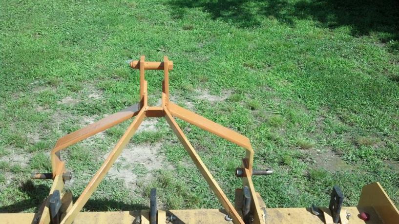

Finally got the last fittings to complete my hydro project so I could get the tractor out of the garage and backed up to the box blade to try out my widened quick hitch. OOPs needed more than just widening the hitch to make it QH friendly. Those bolt together braces had to visit with mr sparkey and that spacer just below the toplink hole had to go. So 2 cutoff wheels and a handfull of 1/8" 6011 and all is good my box is QH compatible. forgot to snap a before pic but after i spray some paint on it i will take a after pic.

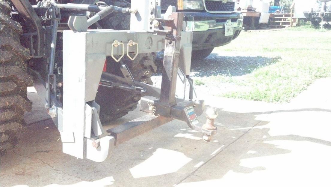

Heres my homemade trailer mover, it was a quickie project a while back so its not a spit and polish job but it works. I had to widen and lengthen it a bit this morning but now its quick hitch compatable. I hooked up to my 26' 7500# camper and relocated it on the property and was amazed at how the 2620 didn't even break a sweat.

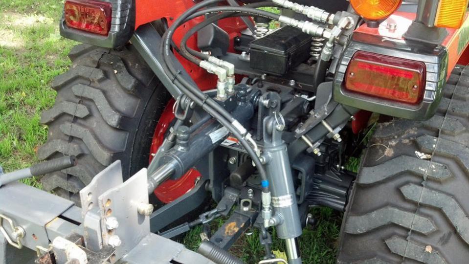

Your rear remote setup is great. This is something I have wanted for a while but havent taken the time to move forward until now. I would love a parts list of the items you used (mostly the smalls) to make this a reality. Please email me at jbelcher@renorefractories.com if you dont mind. I will probably have a few questions for you if you dont mind.

Thanks, I sent you an email. I really am just wondering what fittings and valve you used ETC. I can get lines made locally but driving back and forth to the parts house swapping fittings can get fuel costly.

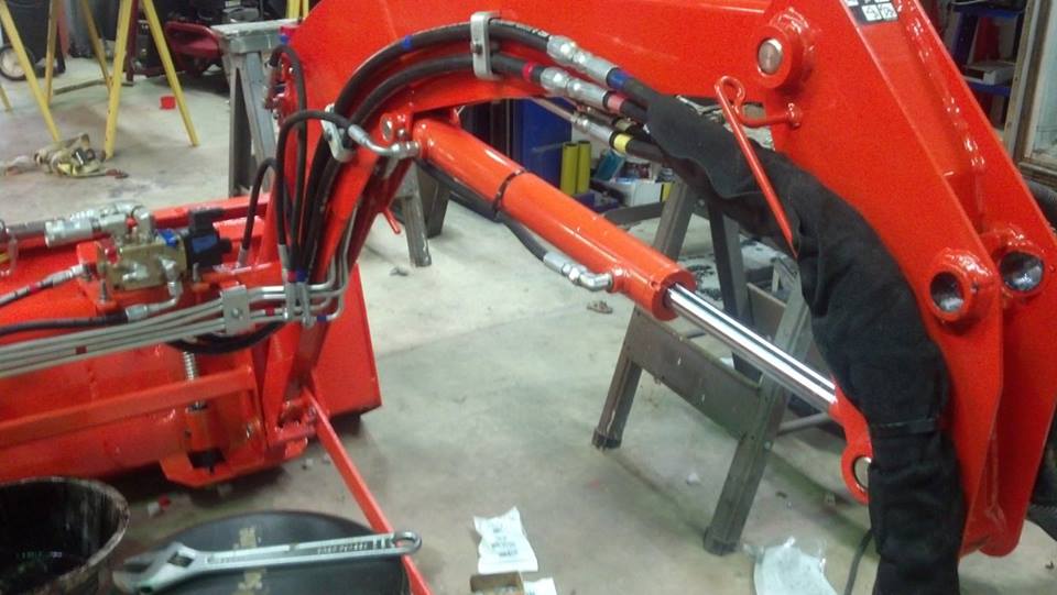

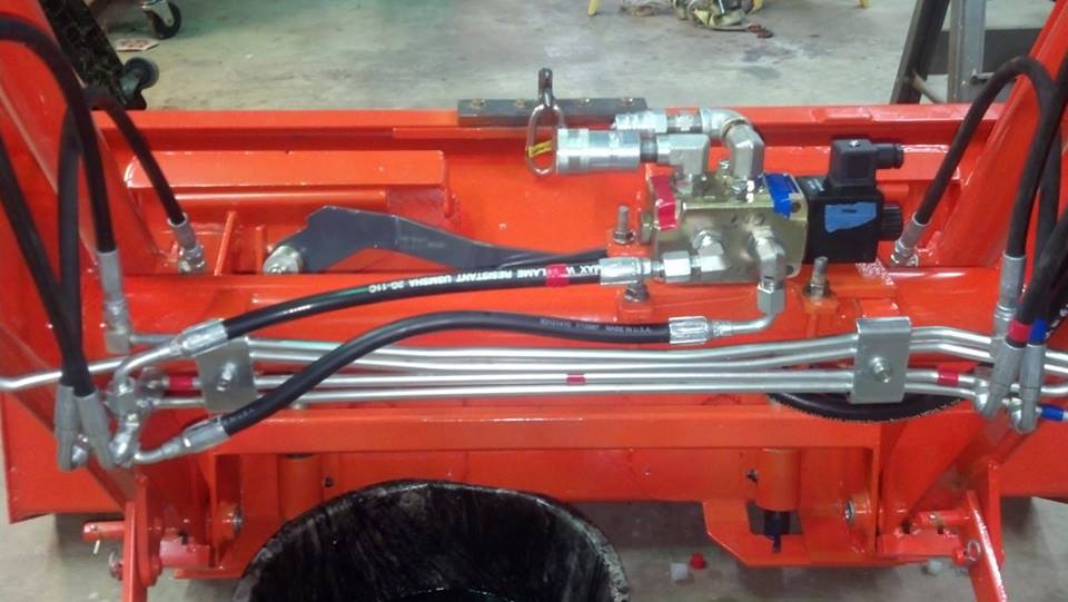

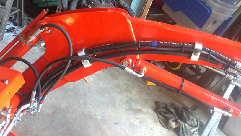

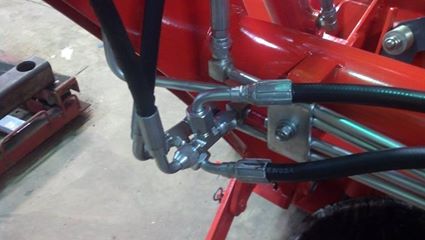

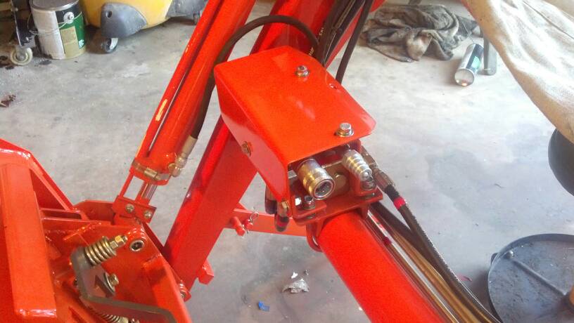

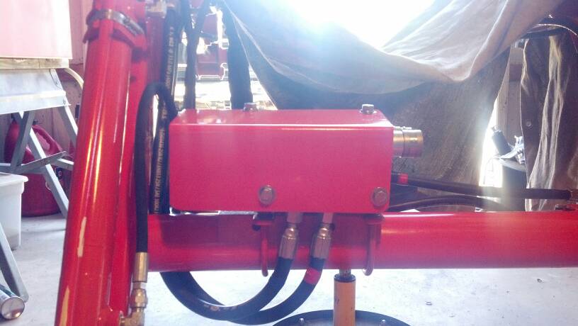

Diverter valve is nearing completion !
I capped off the curl and dump hard lines up on the boom where they transition from flex to hard.
Fed the original hard lines from the valve with hose (tapped back in with run tees ) to keep the original hard lines as crossovers.
The cover and its brackets are all made up just have to wait for the paint to cure.

I looked at the pictures you posted, looks good. A little different though, your going to be able to curl and use the 3rd function at the same time and did you use the through ports on the diverter?

the lines that come down the boom go into the front and pass right thru and come out the back unless you send power to the valve.
Once you send power to the valve it diverts to the top ports so its either reg operation or 3rd function, you cant have both at once.

RIGHT, RIGHT I see it now, I didn't see the lines going to the front. Very cool !!
get'er wired up and tell me how it works, I've been slack and just now got my fittings I needed.

Oh yea, the cover is a nice touch!

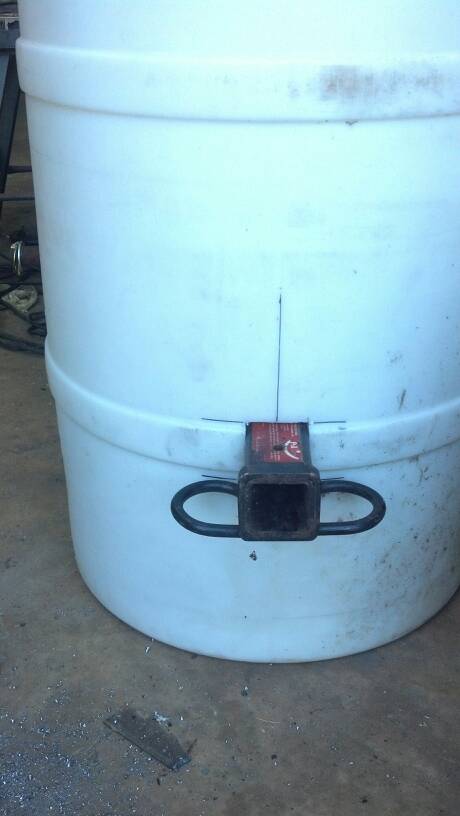

I decided that a more compact form of rear weight would be handy, the box scrape works good but in a tight driveway pushing snow its way to easy to hit something shiney and expensive.
There was a nice plastic barrel and some pieces of steel that were just begging to become a project. uploadfromtaptalk1377471487832.jpg uploadfromtaptalk1377471504703.jpg
I might not be qualified to work tying rebar but there should be enough steel to grab the concrete.
There all ready to pour the floor on the new house across the street if I'm lucky the concrete truck will have some extra he needs to dispose of.
There was a nice plastic barrel and some pieces of steel that were just begging to become a project. View attachment 8264 View attachment 8265
Sent from my DROID RAZR using Tapatalk 2[/QUOTE

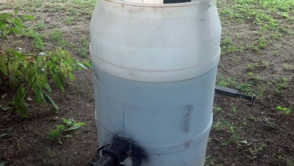

Lucked out and got my barrell filled when they poured the floor across the road ( to bad I didn't have a formed up pad ready he offered me 1 1/2 yards).
I thought my B2620 would lift a full barrell but was mistaken, had to shovel it out to just below the toplink.

How much weight do you think you have in the barrel?
I was thinking of copying what you did but just using sand, I have a ton of it here!

There was prob 60 to 75 lbs of steel in there to start with and the concrete Truck driver said it was 1000 lbs for 55 gallon of concrete which seemed like a pretty high estimate.
kubota says my tractor should lift 1058 @ 24" behind lift point and the center mass of that barell is just about 2' behind the lift arms (i guess the upper lift arms are where they measure from?) so i guess its 900 at least .
You can see in the picture where my new level is.
