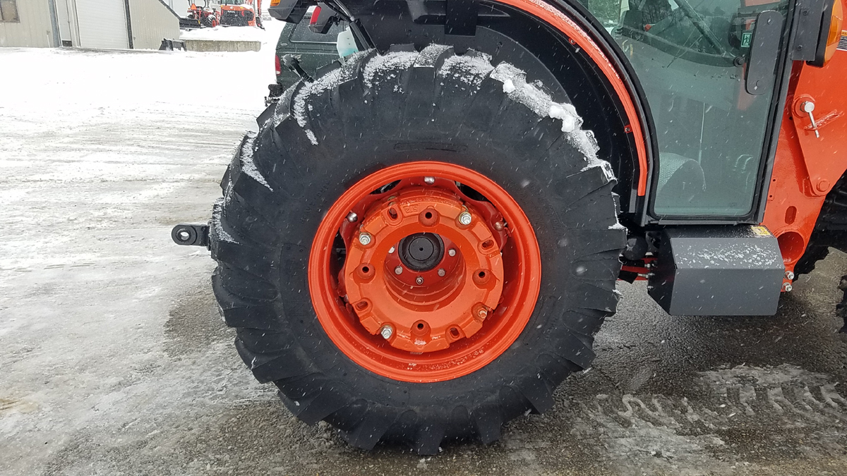

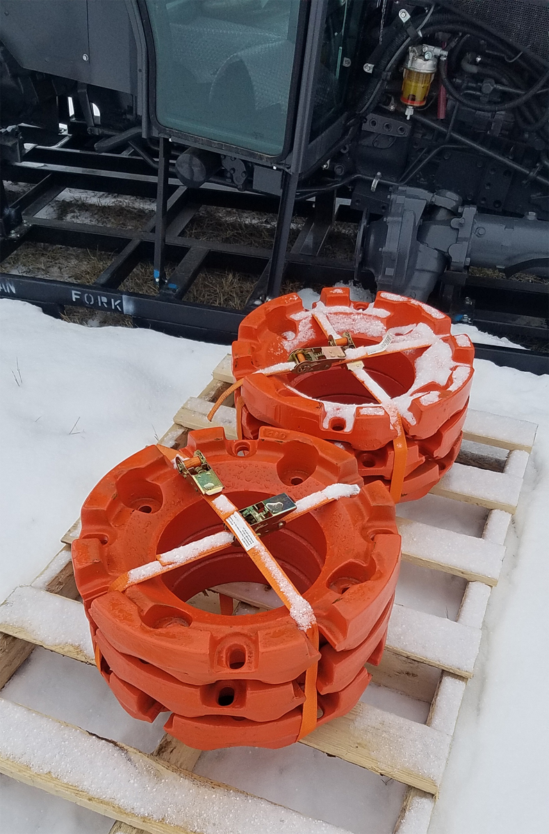

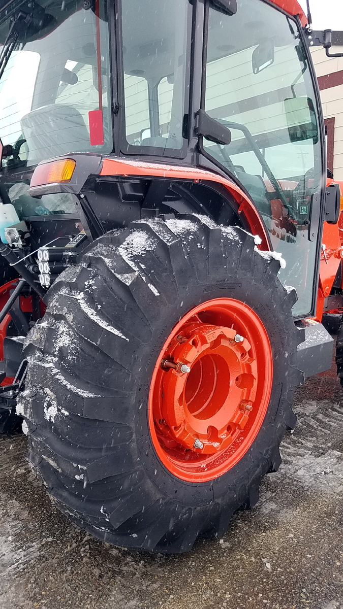

I decided to go with wheel weights rather than a ballast box. I have three Kubota weights per side for 660lb of weight. So far I've seen no downsides to this and plenty of upside. With the Rim Guard that the local dealer adds to all rear tires there's a lot of weight out back to offset anything up front.
I also have over 1,000lb of suitcase weights that I could hang off a custom bracket on the 3-point if needed. I don't see a ballast box in my future.

The current price according to Kubota's website is $1,194 which includes the necessary bolt kits but not installation. When I "built" the tractor that I ordered using Kubota's website the weights were $600, but now they're over $1,000. The final sales invoice for the MX6000 had the weights shown as costing $1,305 which included the bolt kits and installation. But those final numbers shown on the invoice are often a way for the dealership to move costs around to offset something else. I ordered a lot of upgrades and some were cheaper than the price listed on the website and some more expensive. So the bottom line is that I can't say exactly what I paid for the weights installed since it wasn't something I ordered after taking delivery.

When I first bought the M6060 it didn't have Rim Guard in the rear tires or wheel weights. I raised a bucket full of dirt to dump on the dirt pile and the rear wheels came off the ground a little. No such problem lifting up heavy logs or dirt after 1,440lb of Rim Guard and 660lb of wheel weights were added.
