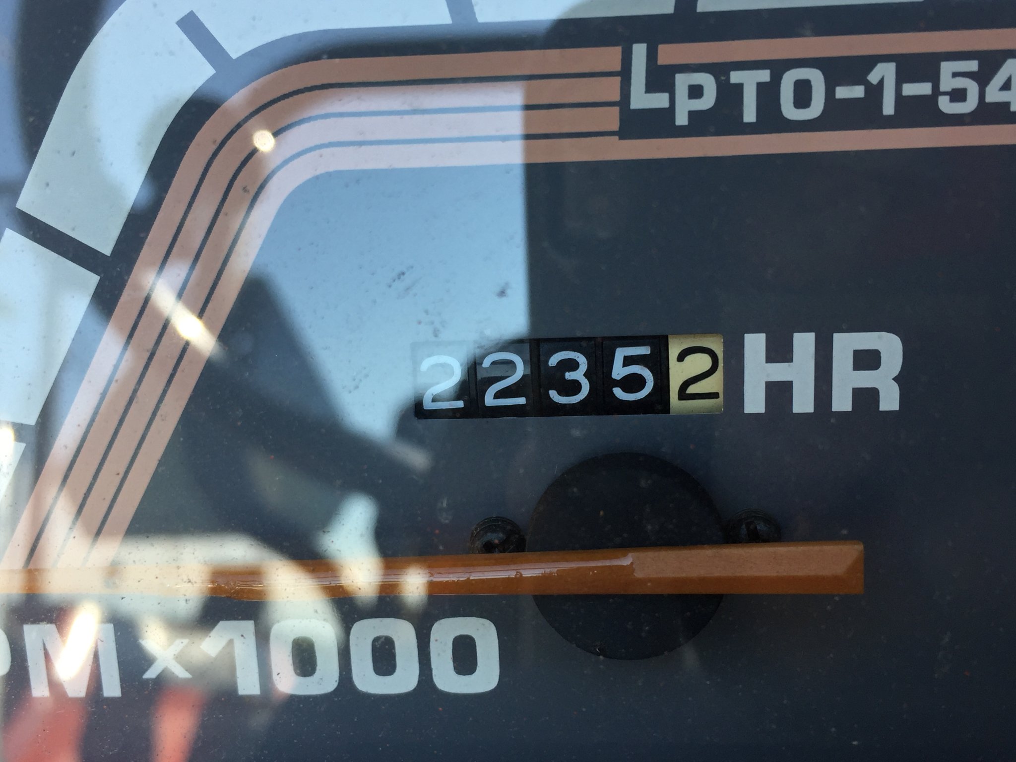

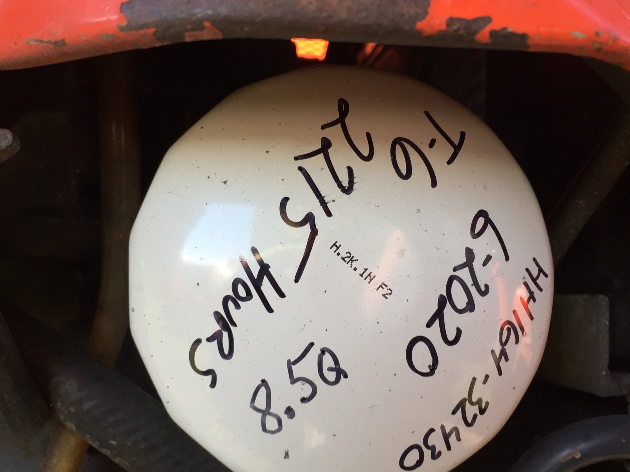

I only put on about 150 hours all last year ... and it's only 20 hours on this round... but my oil always looks like this. I'll spend the extra $ on Rotella T-6 !

I only put on about 150 hours all last year ... and it's only 20 hours on this round... but my oil always looks like this. I'll spend the extra $ on Rotella T-6 ! View attachment 47531 View attachment 47532 View attachment 47533
Exactly like mine looks after a year. Same greenish tint.
