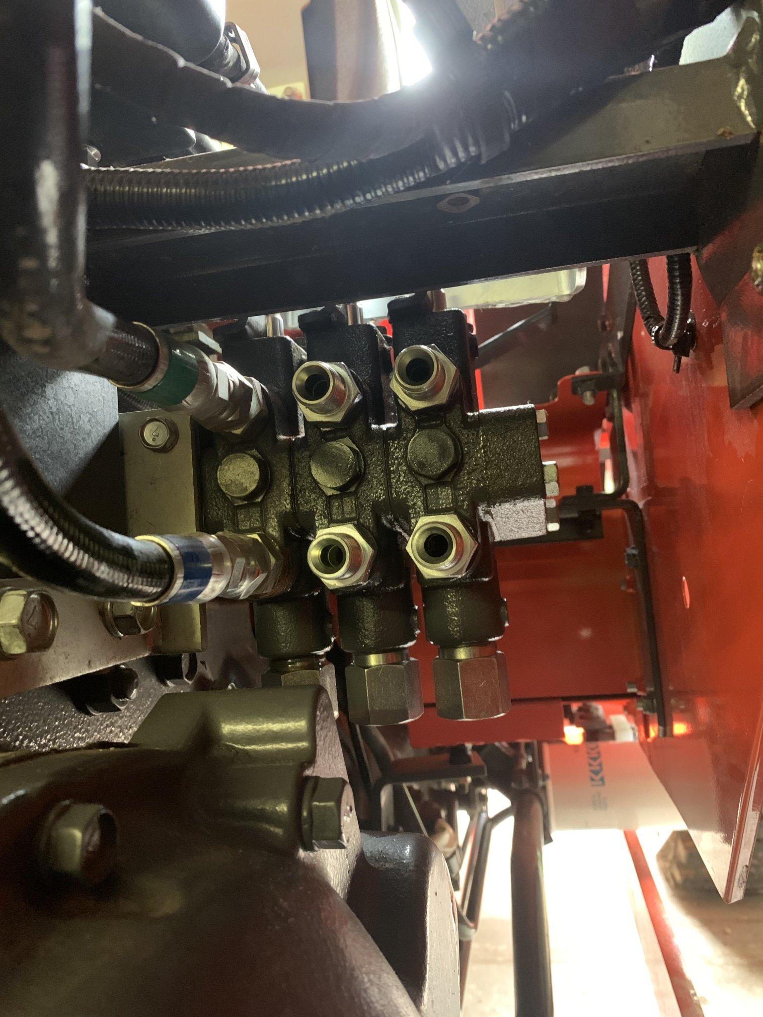

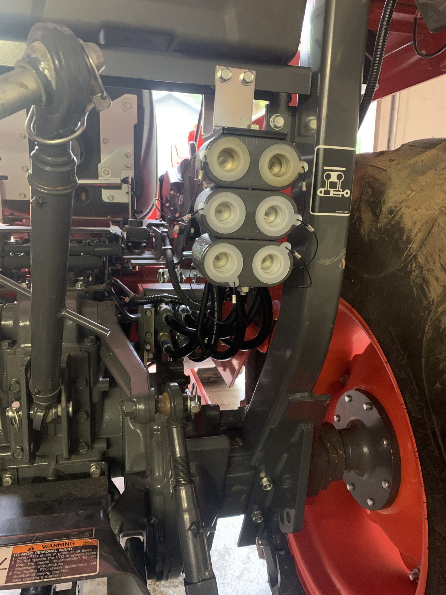

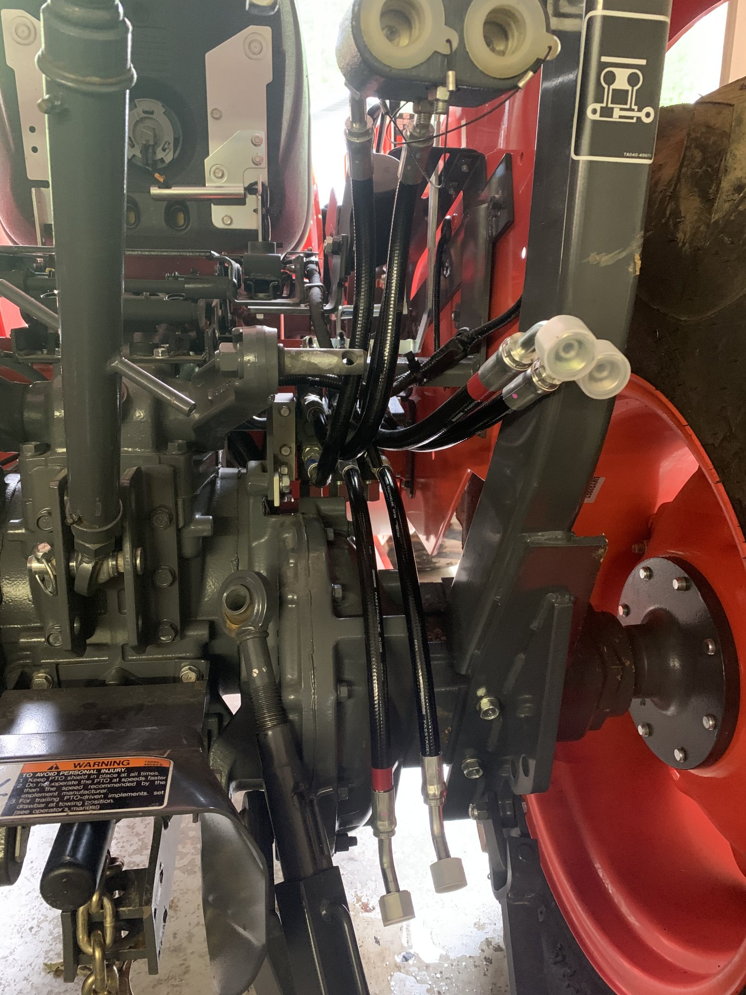

Does anyone have an MX with factory rear remote that could post pictures of the install including the switch valve? That would be helpful in deciding between factory or adding the Tractor Innovations kit myself for a hydraulic top link.
Thanks again, all.
I have a factory rear remote, and I installed the other two myself. Very easy install.
B86598E7-58F8-47FD-A3E8-1B31B14EDD77.jpeg 479B86A7-096B-4C03-A2D3-4F86DE971D1B.jpeg D19644C7-020B-4DF5-8202-90FB32FEFA58.jpeg E35A28CB-44F5-494B-9FAC-F4EE4D980035.jpeg
Hardest part was attaching the levers to the valves.

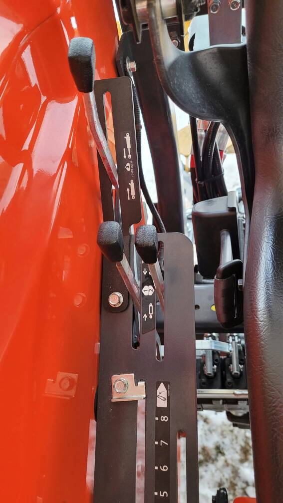

This is great, thanks. So, is that the switch lever and the in/out control for a hydraulic top link?
Yes, each lever works a valve to control whatever is plugged into the tractor. Of the two side by side, the one closest to fender is the first.
