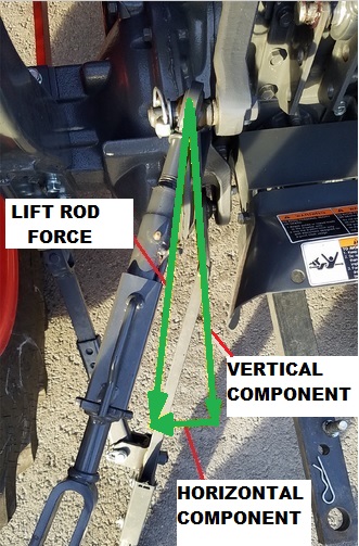

I believe I can offer a theory about how the lift arm can get moved sideways.
It's caused by 3pt loads, despite the fact that heim ball joints only transmit force, not twist.
Looking at mcmxi's first picture in post #69, it dawned on me that the lifting rod and lower link pin are in a moving plane that is not perpendicular to the axis of the rockshaft.
Resolving the lifting rod force into components parallel to and perpendicular to the rockshaft axis, there is indeed a horizontal component. Its amount is the lifting rod force times the tangent of the angle by which the rod deviates from vertical (see markup). The stabilizers keep the lower arms from moving, and are not involved. The horizontal reaction is taken at the rockshaft.
Often the horizontal force gets masked by sliding friction within the fits, but lifting and lowering changes the force during operations. Its these moments the arm shifts a little on the shaft in its non-zero clearance, eventually working its way along, a little at a time.
A way to visualize this is with a trolley-type crane. If you push the load along, the trolley follows.
Resolving the lifting rod force into components parallel to and perpendicular to the rockshaft axis, there is indeed a horizontal component. Its amount is the total force times the tangent of the small angle (see markup). The stabilizers keep the lower arms from moving, but an equal force acts on the upper arm, pulling on the rockshaft.
Often the horizontal force is soaked up in sliding friction within the fits, but lifting and lowering changes the force during operations. Its these moments the arm shifts a little on the shaft in its non-zero clearance, eventually working its way along, a little at a time.
Further to my theory of the case:
The MX5400 range of the stabilizers seems to allow several inches of off-center implement adjustment. When at the max, the more canted lift rod's angle can apparently apply too much side force for the strength of the arm's retainer bracket. I hope your dealer discusses this with Kubota.

You and rbargeron are seeing what happens correctly. A heavy side draft and or angled force can place a side load on the arm which tries to push it off the rock shaft.
I think you and loggin have it. As long as the lift rods are hanging perfectly vertical they don't exert a side load on the arms. But if they are spread apart at the bottom, weight on the implement causes a horizontal component of force pulling the arms apart. The more angle of spread, the larger the side force, but I wouldn't expect a large load.
Our blade I think is a class 2 adapted to class 1 for the Ford, so it's pretty wide and spreads the lift rods a fair bit. But we've never had a problem with it. The Kubota retainer must be pretty weak, or OP is really overloading it.
Edit to add: at first I was thinking that uneven load side to side, or lifting one side with weight on the other, causing a twist would be necessary (and might magnify the effect), but now I think even an even load would cause the effect.
Resolving the lifting rod force into components parallel to and perpendicular to the rockshaft axis, there is indeed a horizontal component. Its amount is the total force times the tangent of the small angle (see markup). The stabilizers keep the lower arms from moving, but an equal force acts on the upper arm.
Just as in truss analysis, you have to consider the reactive forces at the joint, i.e. both ends of the lift arm. Go look at "method of joints" analysis for a truss. There is little to no ability of the heim joint and sleeve to resist a force axially in reference to the pin on which it resides. If there's no ability to resist a force, there's no force vector in that direction.
There is a moment generated by loads on the rock shafts about the splined shaft, but the lever arm is short, and the loads are typically balanced. In addition, the loads cause the rock shafts to rotate towards the center of the tractor.
